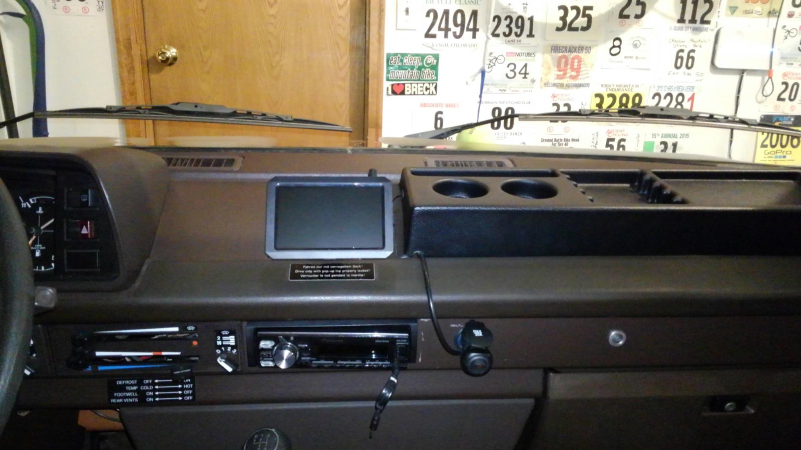

Figured I would shares what seems like a good option/setup for a backup camera/monitor for a Westfalia. Hopefully no more wondering if there is a light pole/car/etc hidden by the cabinets! Smile
Before this install I researched lots of forums about the topic but didn't want to splice into brake lights/drill holes/etc for a hardwired setup.
I came across this Auto-Vox TW1 Truly Wireless Backup Camera that seemed like a good option. Reasonably priced (Amazon had it on sale), had a solar add-on option to charge the battery, and had a decent sized dedicated monitor.
The camera mounting holes didn't line up perfectly on the license plate and I was not about to drill out the rivets holding the pull tab in order to make it fit.
I drilled a few holes to essentially lower the license plate bracket and thus the camera mounting fit. Took a few minutes to clean up the door and installed new stainless steel screws/nuts.

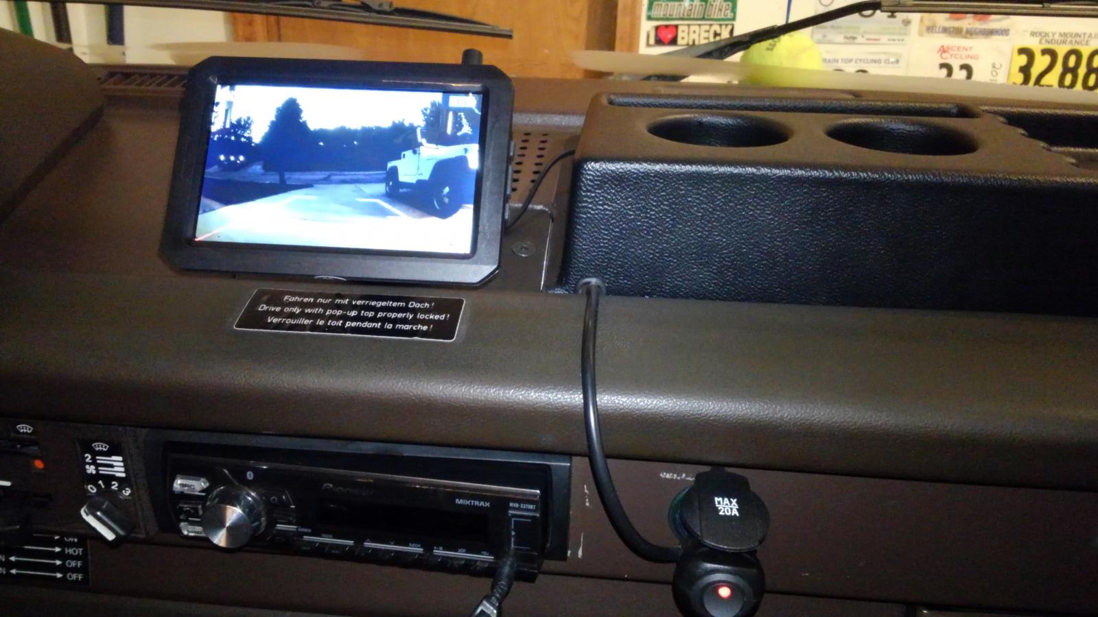

The monitor installation could have been straight forward if our Vanagons didn't have an always on 12v Cigarette lighter. Sure I could have spliced in a switch/rewired but I guess I like keeping it as close to original as possible.
I found a neat on/off cigarette plug (of course on Amazon) Ninth-City Cigarette Lighter Extension Cord 12V/24V Car Charger Cable Male Plug to Female Socket with 15A Fuse and LED Lights)
The plug stays in place and I can toggle on/off whenever I want to use the camera. The LED doesn't stay on when it is in the "off" position so I don't think it will put any major drain on the battery system.

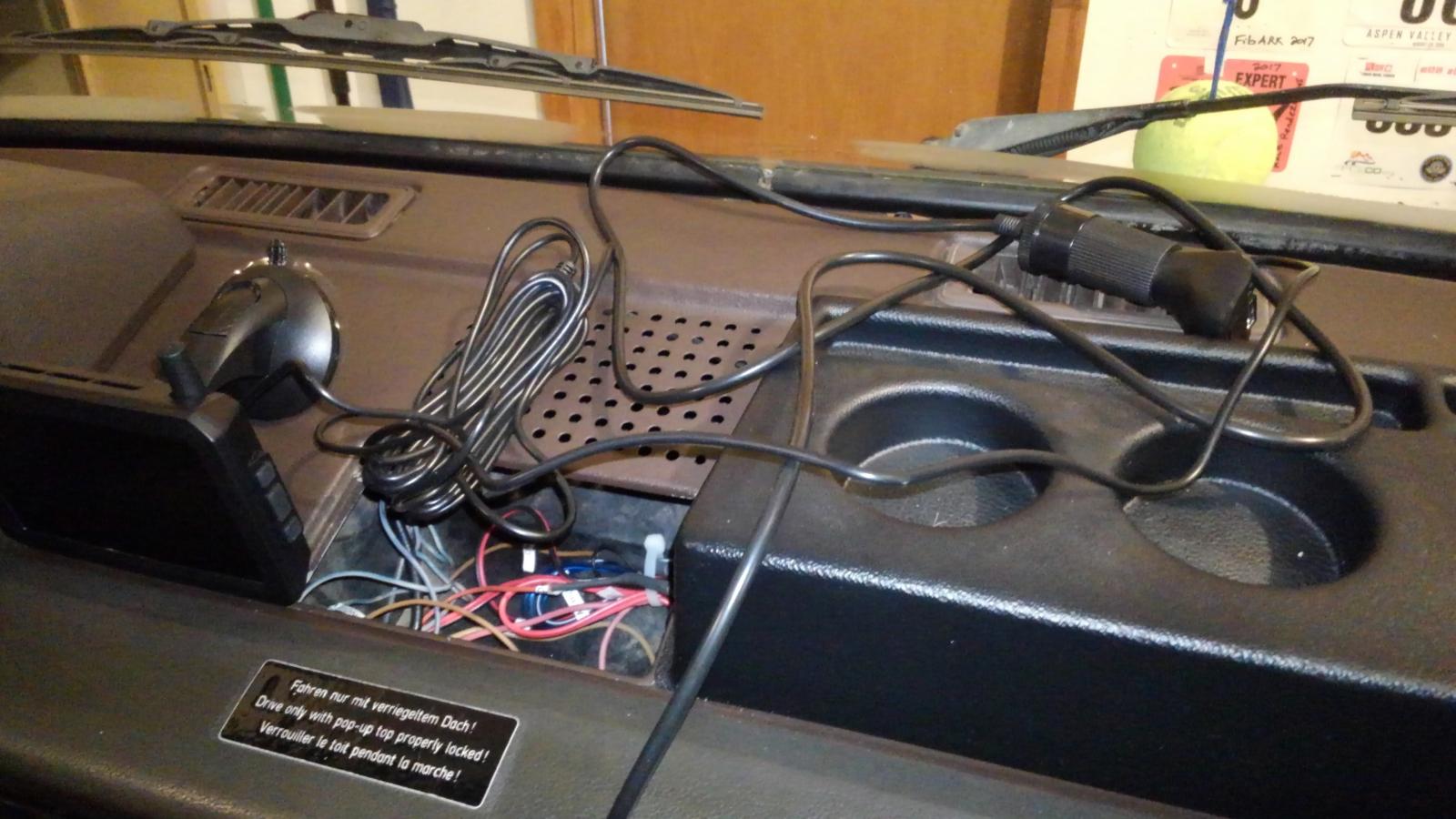

I was able to hide the wires under that dash console for a clean look.
So far it seems like a good camera but time will tell. I haven't used it at night but most of the reviews say it does a decent job. (can't be worse than not having it)
Almost as important this project did allow me to confidently order a new rear bumper (see pics above..original owner backed into a pole)
Hope this helps!

So the MONITOR is powered by a cigarette plug in adapter. I am not sure if you can just cut the plug off and hardwire (but I bet there is a way to do it) I just didn’t want to make any permanent moves if the camera/monitor turned out to be poor quality/etc.
The CAMERA has a battery which I charged via usb originally and then added that little solar recharge kit on it. The solar should keep the battery charged during months of driving/use but I will most likely have to charge up the battery after the winter.
I appreciate the comments and discussion. Thanks for looking and hopefully making a better mousetrap!
