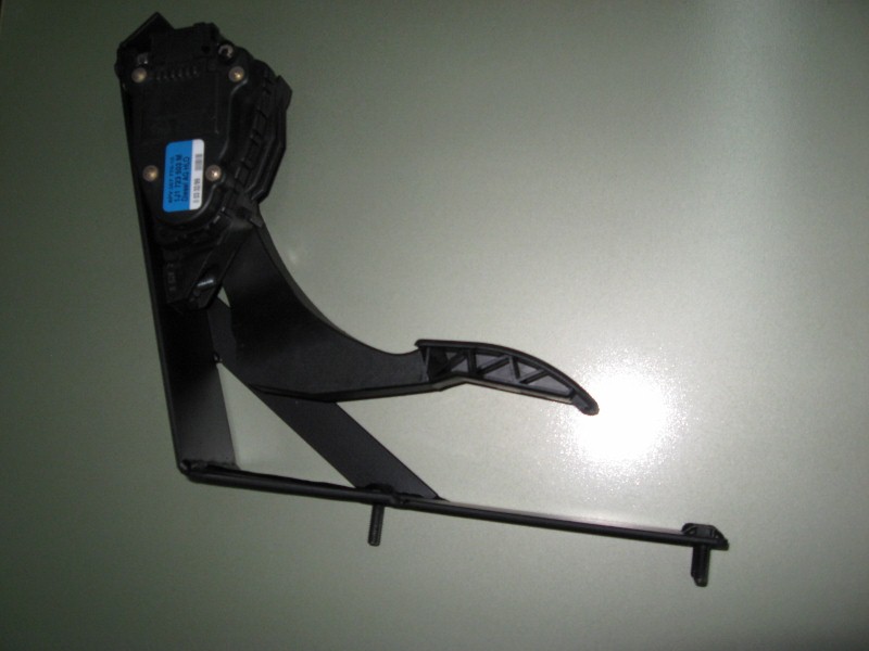

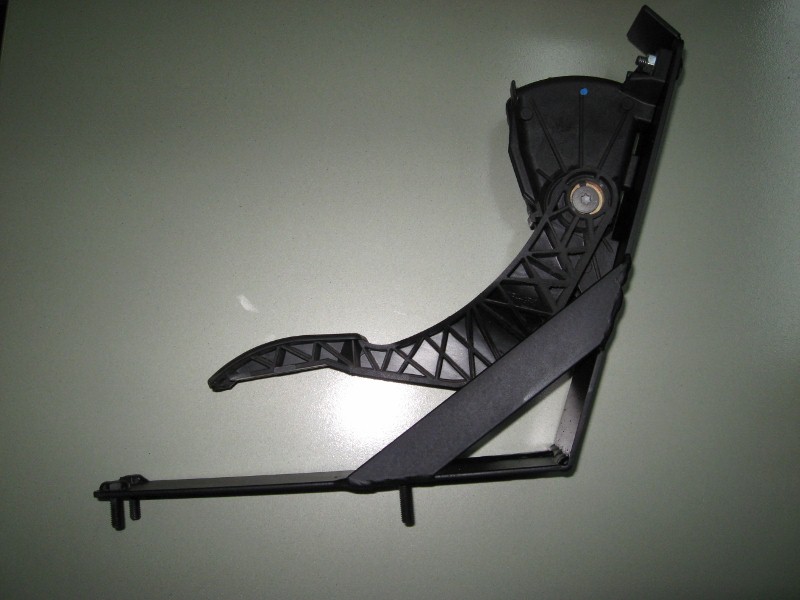

Here's the pedal bracket that I install with my conversions. You need to trim off about an inch of the pedal. It bolts up to the stock holes that are left when you remove the factory pedal.

Yep, mk4. It's a direct bolt in. Gives me 100% throttle travel in vagcom.
The Golf and Jetta pedals are slightly different, but mount the same. There is also an early mk4 pedal and a late. They both work with this mount.

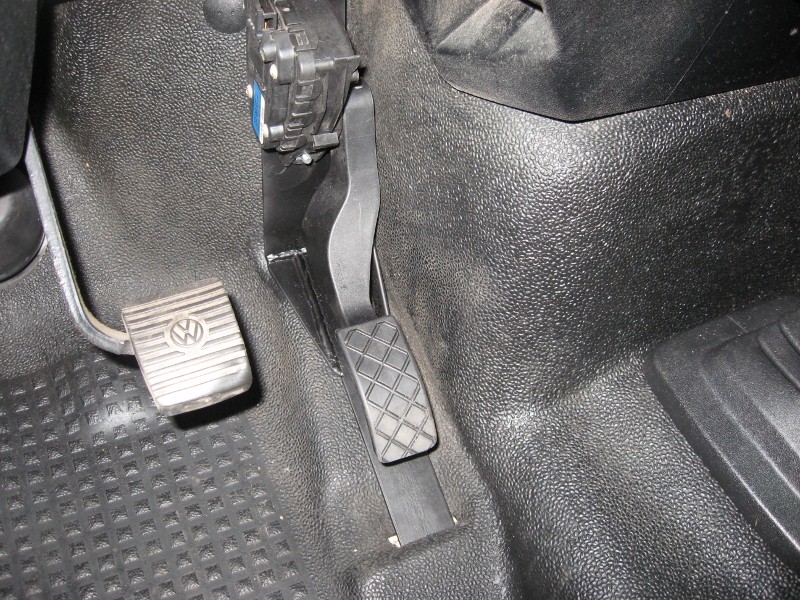

I like the bracket. I welded a bracket to the front firewall and it held the pedal in the same orientation. I found it extremely uncomfortable on extended drives when I could not use the cruies. I even had a small block of wood for my heel. It is designed for your heel to be on the floor.
On revision two, I cut the OE pedal off of the TDI pedal and left the arm. I filled the side webs with JB weld and attached some teflon rubbing tape. I then cut the back side of the Vanagon pedal flush, filled it with JB weld and added the same teflon tape. Cabinet makers use it. Anyhow, it is about perfect now. Here is a picture, I imagine after seeing the mounting bracket above, you could use a combination of it and the vanagon pedal. mark

Don't know who your question was directed to. My engine was from a 98 New Beetle. That year, VW had a two part accel pedal. I wanted the all in one for the vanagon and purchased a pedal for a 99 New Beetle, where the change was made in production to the all in one. A word of caution, there is a subtle difference in the wiring for the two pedals. Two wires need to be reversed to work with the all in one pedal vs the early one. If you get it wrong, the engine will not accelerate. You also need to keep the pedal "bone" dry.
I don't know MK? from anything. Can't help there. I took another picture, so it is a little clearer how I modified the TDI all in one pedal to work with the Vanagon pedal. I probably could have removed a little more. The vanagon pedal stands a little tall at idle. I also looked at removing the TDI pedal and using a bracket with an adjustable heim rod and making a Vanagon pedal out of aluminum, but I think what I did was twice as easy and looks stock. I do believe you could do this and use the bracket above. It is a very clever design. Wish I had thought of it. Welding brackets is more permanent and does impact the sheetmetal and paint in the area welded.
