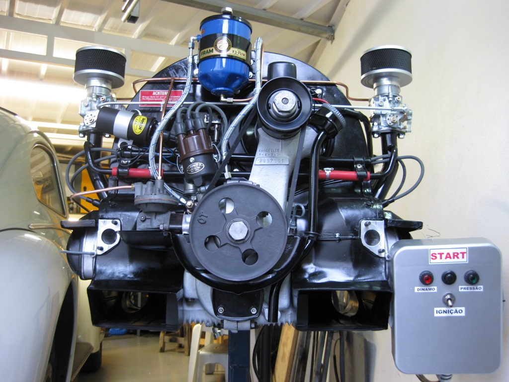

PostPosted: Wed Apr 04, 2012 3:27 am    Post subject: Reply with quote
12 000 Km (7 000 miles) since March 2011;
Stock crank and cam;
Rebuilt engine (crank and rod bearings, P&C)
External bypass oil filter.
No problems with the heads. It was a general good fit, except the accelerator cable mecanism (OG style). It was necessary to put there some small ball bearings in order to have a good and free rotation movement of the vertical cylinder where the accel cable attaches. With this litle mod it can get a full throtlle situation.
The stock jetting with the PBICs was too big/rich for an "internal" stock engine. Still trying to find a better set up with the carbs jets.
Max speed ? 130 Km/h
I'm very happy with it .
