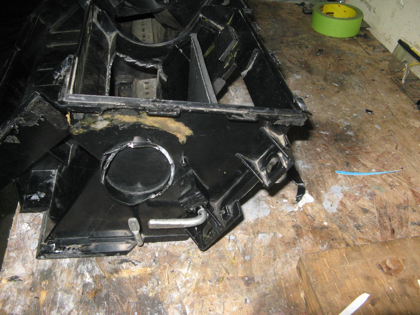

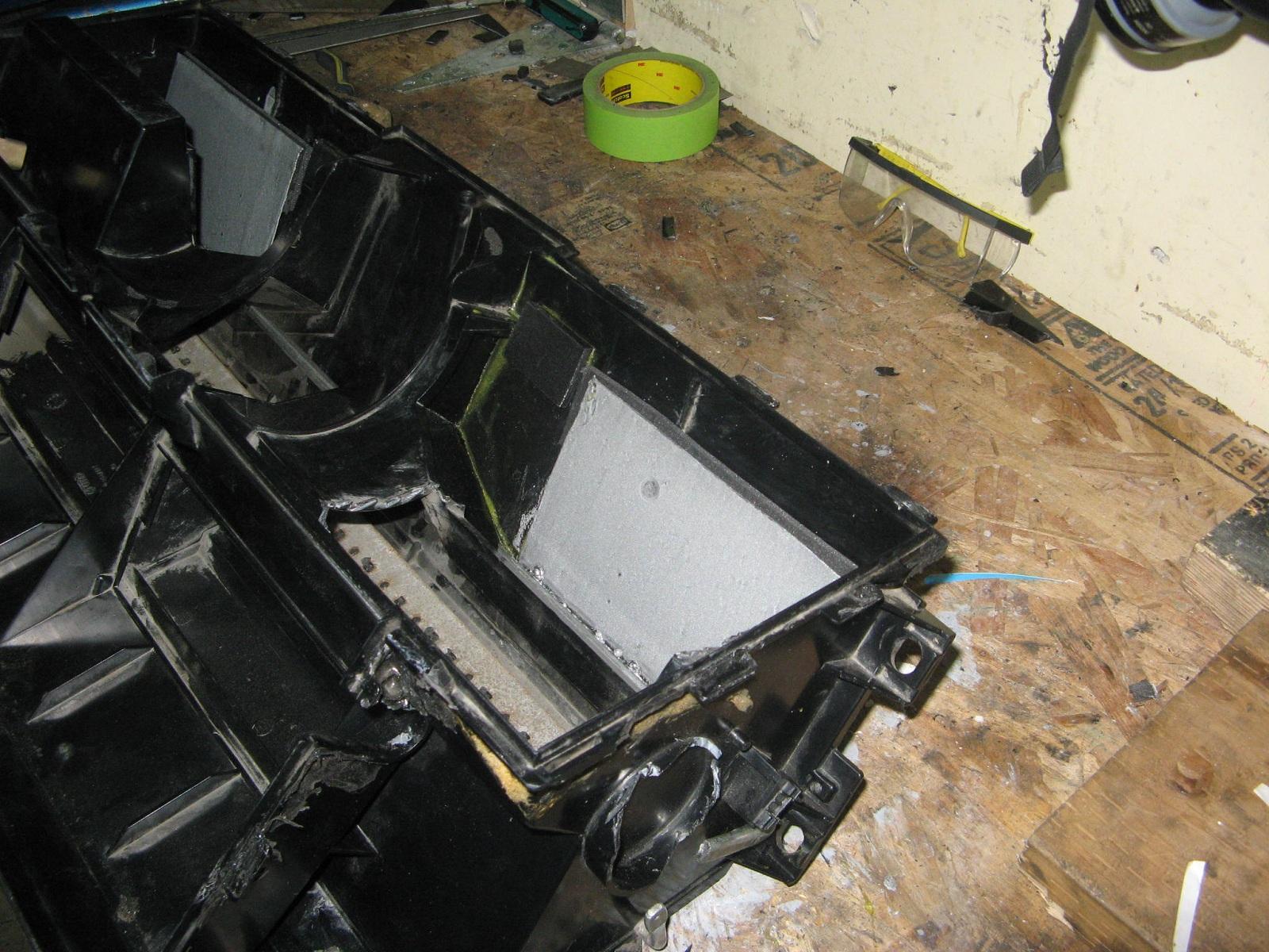

I built and installed my own front AC system for my Syncro Westy. I modified the plastic airbox to include a flap that was intended to stop all outside air getting in.
See here:
Unfortunately, the flap works less than perfectly - - I still intend to make it work, but for now, I have simply used black duct tape to completely seal the exterior air intake. The flap I installed needs a vacuum control servo, I think, to be effective. Currently, I use the lowest slider control on my HVAC controls to operate it, but the wind just blows it partly open since it is a fully-cantilevered flap.
In addition, since even a brand new VW heater control valve will not completely stop the coolant flow to the front heater core, I have added a quality vacuum-operated coolant valve right in my engine compartment so that even the heater hoses under the van get no flow. This works really well.

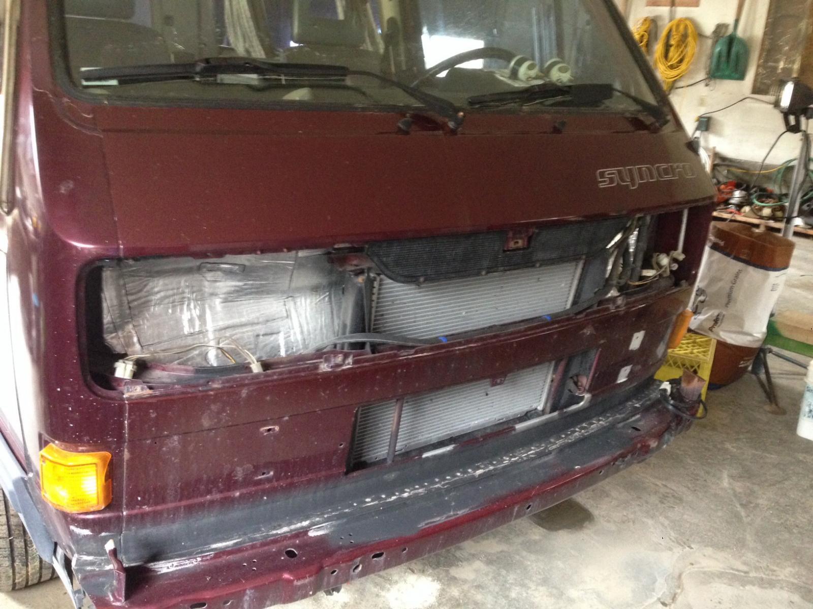

1) Is the front air inlet easily accessible without tools to tape up? I'm in an apt complex and am trying to figure out if this is easy to do or if I need to arrange to go to a friends place and borrow tools.
2) For the hose valve trick- do you have to bleed your system after doing the work since there was air induced into the system?
Thanks!
dobryan
Joined: March 24, 2006
Posts: 17157
Location: Brookeville, MD
dobryan is offline
PostPosted: Thu May 29, 2014 9:49 am    Post subject: Re: Thanks! Reply with quote
Yes, you just need to remove the upper grill. There are five 'screw heads' along the top of the grill that need to be turned 90 degrees and they release the grill which can then be tilted out from the top and lifted off.
You then see the fresh air intake which you want to block fully.
Replacing the grill is the reverse of removal. It is a little fiddly the first time you do it, but you'll figure it out. Very Happy

the fresh air intake seems like another must do for me... currently looking for pics of the area behind the grill... im one of those that likes photos in order to completely see the process in my head before doing it...
thanks!
Abel Longoria
VanAlert App for Vanagons/Buses | Texas Vanagons | My Vanagon Build Thread | Follow Me On Instagram | Vanagon-centric Stickers Available Now
dobryan
Posts: 17157
dobryan is offline
PostPosted: Thu May 29, 2014 10:23 am    Post subject: Reply with quote
thanks!
From the gallery, not mine.
The intake is the black mesh area in the top center....
Dave O
The Western Syncro build
