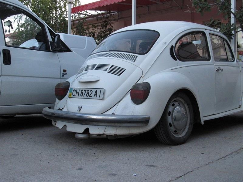

Hi everyone!
My name is Mike, i'm from Sevastopol, Ukraine and this is my '73 Super.
Repainted (temporary) wheels, made in China hubcups, new rubber... This is what made it look much better Laughing This is the only changes in exterior that i made now.
Body is rusty as always and hacked-someone welded the body to the chassis where the heater channels are, the pans are made of a plate steel.
The frame head is so rusty that i can put three fingers inside Laughing
to be continued...

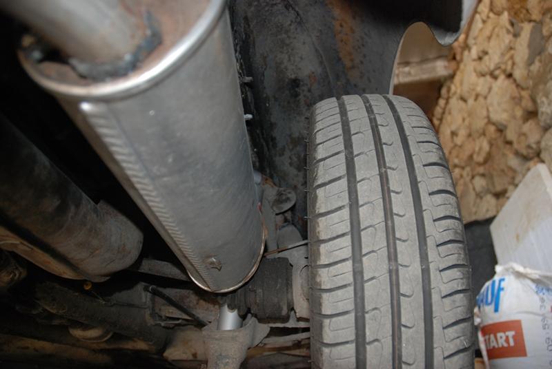

Some news regarding my exhaust. I completely tired of my "fatboy" muffler and decided to make a quiet hide away exhaust. It's an old news to be honest - it was made before the long trip to Kiev. Guys made a new setup using a muffler from some 1.7 (?) Seat. The muffler have inlet and outlet pipe on one side and that's good. See the end result:
