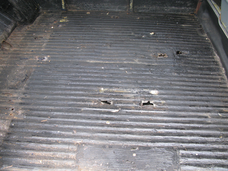

My bus is a full width middle seat. I'm not too concerned about originality. But from what I could see, I did not have the big plates. I rescued at least three of the mounts. Two at the most rear and one for the middle seat.
Gerson has sent me a PM that he will ship me the hardware. That is a stand up guy!
Just for the nerds I post some pics of my old rotten floor. Please tell me what you think regarding the mounts. Can it be that mine is an early 66? (mid august production)
Thanks all!
Jörgen

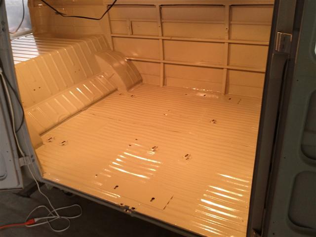

Pic from a Mango Bus
Kchulick
Joined: October 27, 2004
Posts: 47
Location: Cumming, GA
Kchulick is offline
PostPosted: Wed May 21, 2014 5:38 pm    Post subject: Reply with quote
Well I'll be darned. Those look like the pics of the pieces I posted above. Thanks for posting. After many attempts to contact Klassic Fab I never got any kind of response to multiple emails to multiple email addresses, and phone #'s.
Still would need to see how they function, but nice to at least seem there where they go.
