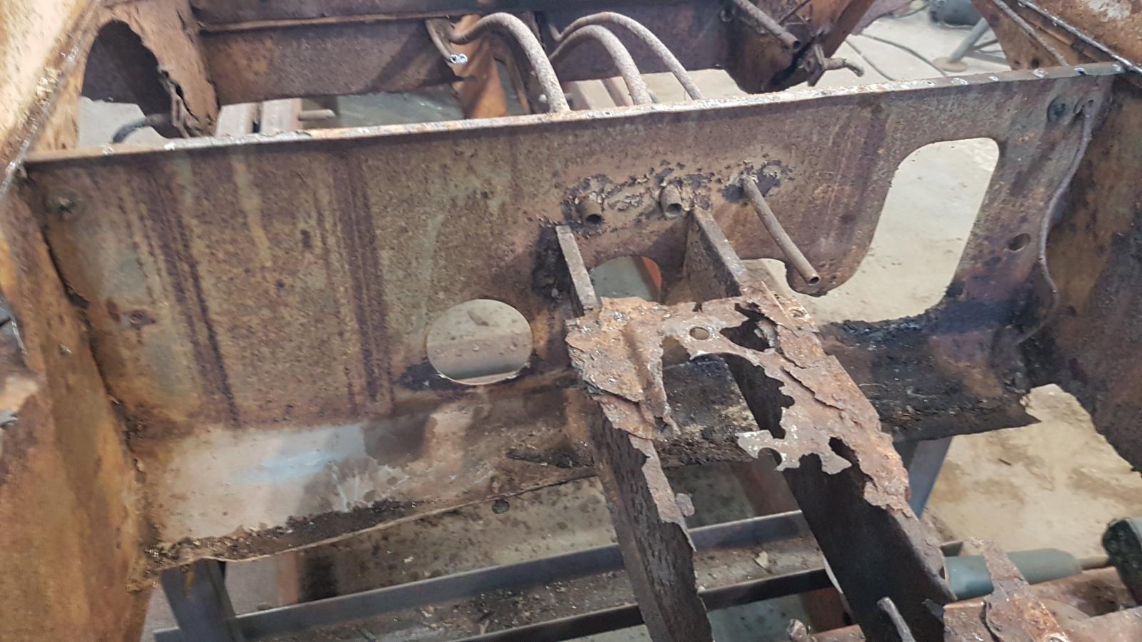

From the rusty remains of my 54 it looks like possibly a second layer of steel around the shifting lever mounting. I have looked through some photos but it is not clear. One looks like there is a second panel but others do not.
Hoping someone has a photo or some knowledge of this.
Thanks

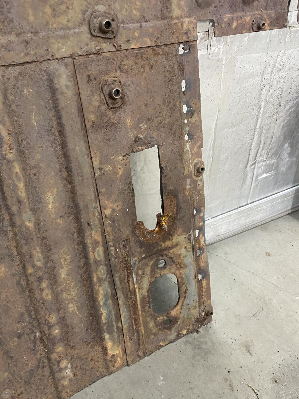

I did find this floor that appears to have a second layer spot welded on but this is an early Gerson panel.

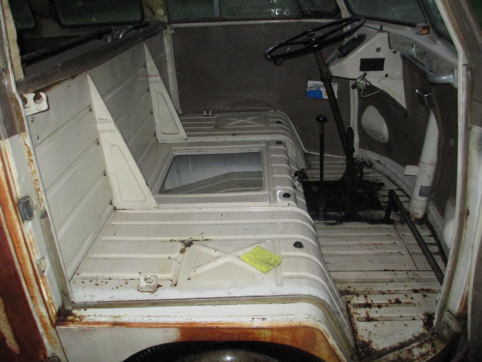

The exploded remains of the front floor on my 52:
And one of my nos floor part: (sorry for the bad picture, its behind a lot of splits in my barn)

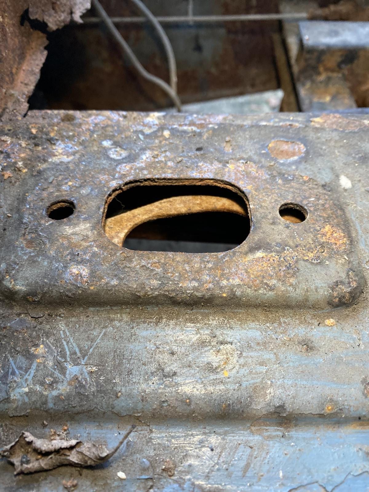

After a lot of browsing photos I searched through my pile of rust and found the old floor reinforcements. Now I can see details of the lower panel I hadn't noticed before.
Believe I have all the information I need to make up accurate drawings. I also see how the floor was welded down to the reinforcements.

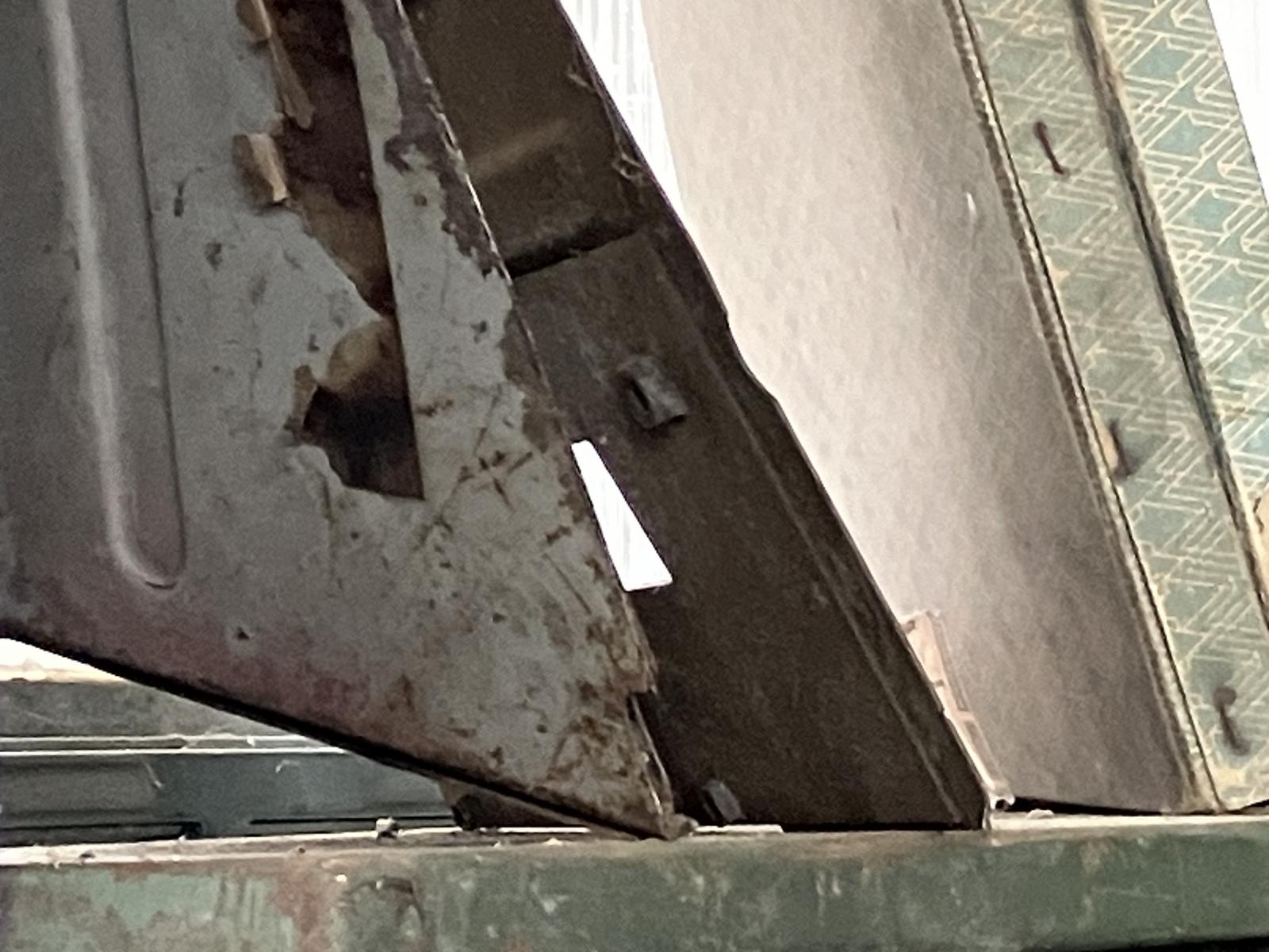

I found this photo that shows the panel edge.
