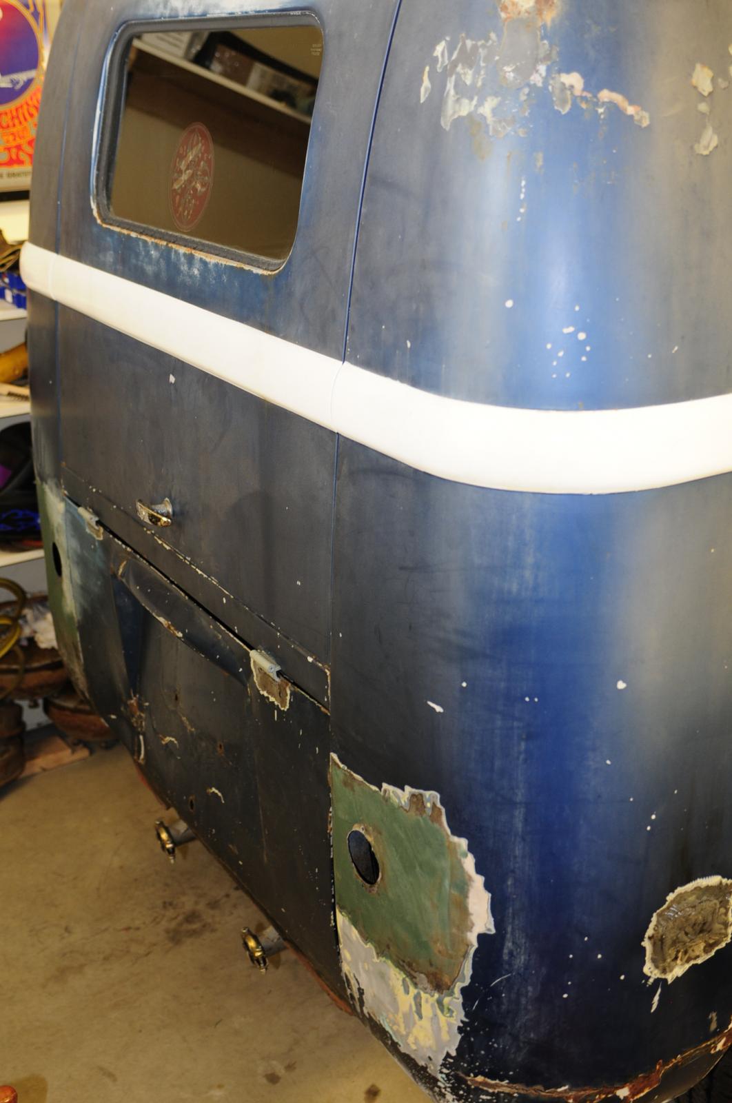

Overall the condition of the bus was a bit rough in regards to it been sitting so long. Nose was completely crushed in, lots of dents, hacks, etc and stripped of most everything, however it is not very rusty (which is what I like most of all)!

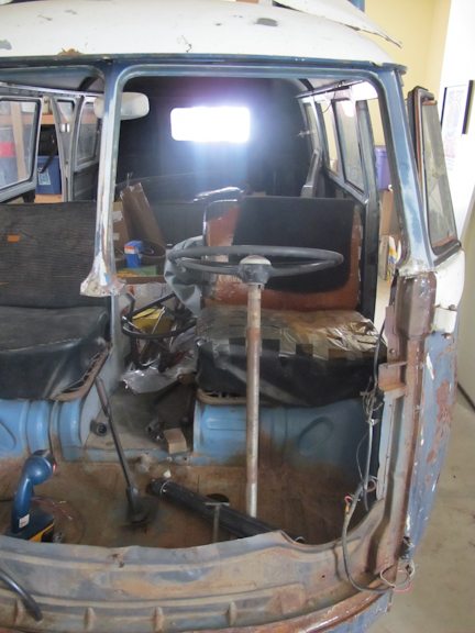

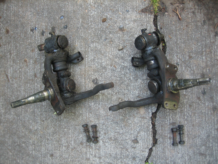

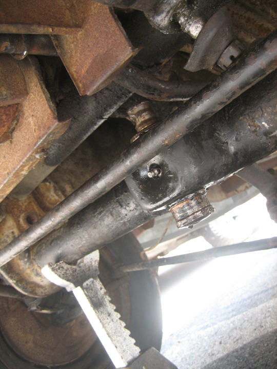

First project was to get a look at the front end and figure out what needed repair/replacement. Overall the bus just looked like it had been driven into the ground.

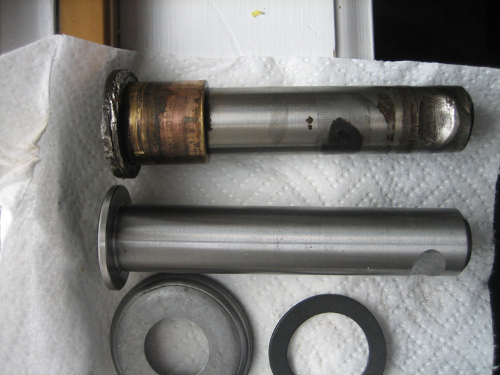

I assumed the beam was from a 58, and Campingbox was kind enough to rent a press to me for an early beam. When the tool wouldn't fit, we determined, since it had a sway bar, that it was a late beam from a 66 or 67. Greg was nice enough to refund my money for the rental minus the shipping costs which I was grateful for.
The pin was so frozen I had to remove the beam and give 7 or 8 sledgehammer blows to it at the car wash. Rolling Eyes It finally broke loose! Very Happy
Center pin drenched in Liquid Wrench (applying heat at various intervals to no avail)...
Beam out and clean...
New and Old Center Pin...
Old Spindles sent off to Rizzag...
Beam reassembled with new center pin/bushing and Rebuilt Spindles...
New Shocks too...

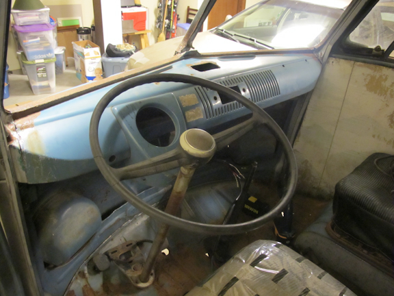

Some interior pics of the front...

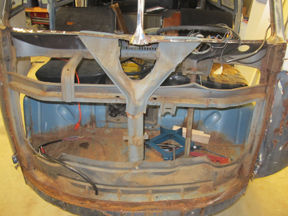

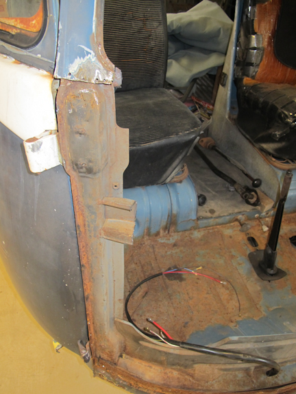

I felt pretty good so I proceeded onto the nose... which I was definately concerned about and knew I would have to take my time to get things right.
This is not your typical way of going about a nose job. My inner frame was crushed and needed to be cut out and replaced by the donor. In the circustances of my donor skin/dash and how crushed my nose was, this is what I did. It required lots of time and patience... measuring, measuring and measuring some more... and more time and patience. But it worked and here's how I did it...
Measuring up the new dash before welding in...
"Relax and just enjoy the ride knowing everybody passing is wishing they had one."

PostPosted: Thu Jul 19, 2012 4:35 pm    Post subject: Reply with quote
vwserphguy wrote:
... is it in yet?
If not, why don't you straighten the nose skin at the bottom a bit? Get a cheap body-hammer kit at Harbor Freight ($15 or so) and try it with hammer and dolly - you'll be surprised about the result and much happier applying that green stuff you used around the tail-lights lightly. Also, the piece you'll have to stitch in at the bottom will fit better. Don't think you can do it after you welded the nose in!

PostPosted: Thu Jul 19, 2012 10:09 pm    Post subject: Reply with quote
Novel way of attacking the nose.
I can see in that photo that it's just fitted up, not welded in.
I think I would want the patch piece for the bottom in my hands before I did anything more than just tack weld it.
Nice work, and cool bus. Keep at it. Very Happy

PostPosted: Fri Jul 20, 2012 4:43 am    Post subject: Reply with quote
Definitely consider doing the valance if necessary before tacking the nose one...

PostPosted: Thu Jul 26, 2012 4:36 pm    Post subject: Reply with quote
The nose is in btw.
A new shipment of Gerson Green just arrived today! Now I just gotta make the time to weld in the Valence, Lower Nose, and Battery Tray.
