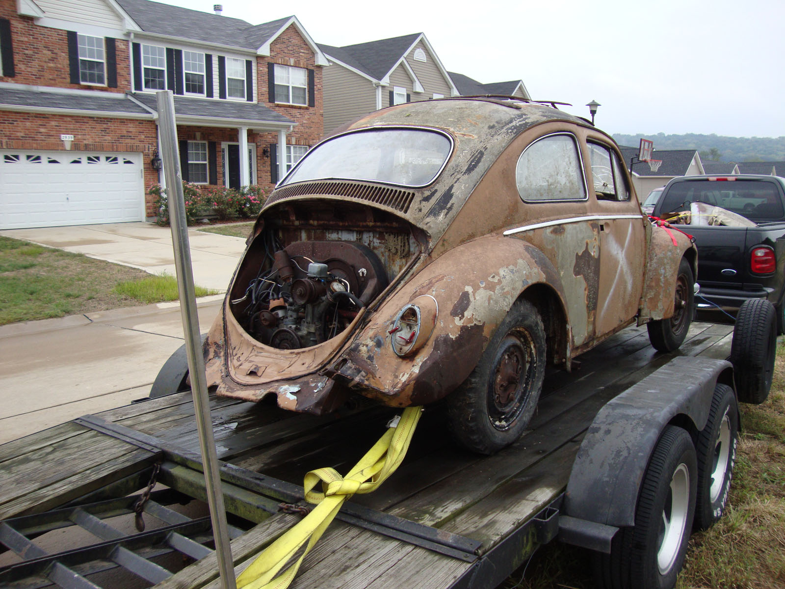

The day I showed up to get the old rag it was pouring down rain. The PO was a truck driver and was on the road and also didn't inform me of any issues with loading it. His elderly wife was the only one home. She took my money, pointed in the direction of the barn it was next to and slammed the door.
When I tried to move the old VW I quickly found that the front brakes and steering linkage were stuck, so it wouldn't roll nor steer. I tried the electric winch on the trailer, but wasn't strong enough to pull the bug with the wheels locked. Needless to say, I was 3 1/2 hours from home, pissed and soaking wet.
Luckily, I had my Dad along with me, we ended up disconnecting the trailer and blocking the trailer wheels so it wouldn't roll, hooked a long tow strap from my truck, over the trailer and to the VW. I pulled the VW (with the front wheels locked), onto the trailer with my truck. Looking at it optimistically, it's a good thing it was raining because the mud and wet ramps helped to let it slide on.
I was angry, cold and tired by the time we got it loaded, but I couldn't take my eyes off the little VW in my rear view mirror all the way back. By the time I got home, I had a soft spot in my heart for Franky, as he is now fondly known. If you are reading this and are a true VW guy (or gal) then you probably understand how these little cars take on a personality, if not, stay tuned and you will understand by the end of this build.
Here he is, Franky, in all his rusted glory...ready to go under the torch and be brought back to life. Enjoy the build.

As you can see, most of the cool early stuff has already been robbed from this car before I got it. It has the wrong fenders and lights and it also has the wrong hood.
The left rear C pillar is hurt pretty bad from a prior accident and was repaired poorly, so I wont feel bad about chopping that top.
Looks like the only cool stuff remaining is the original doors (minus the Ice Picks), the original steering column (minus the correct wheel), the original ash tray (minus the faceplate), the original radio delete (minus the cast trim)...so you can see it is a prime candidate for this project.
I have plans for a modified dash so I will probably pass the 1958 specific parts remaining on to a correct restoration project where they belong.
I will incorporate the doors and stock gas tank into this build to retain that early flavor.

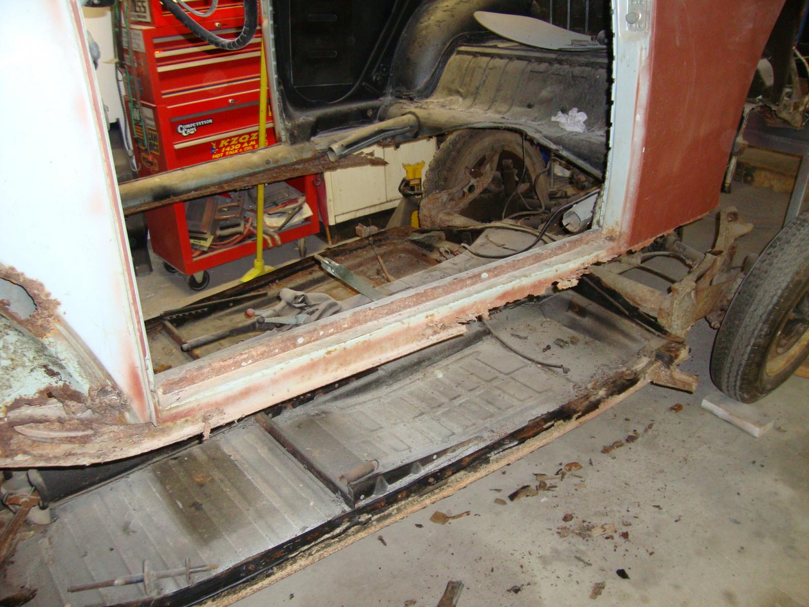

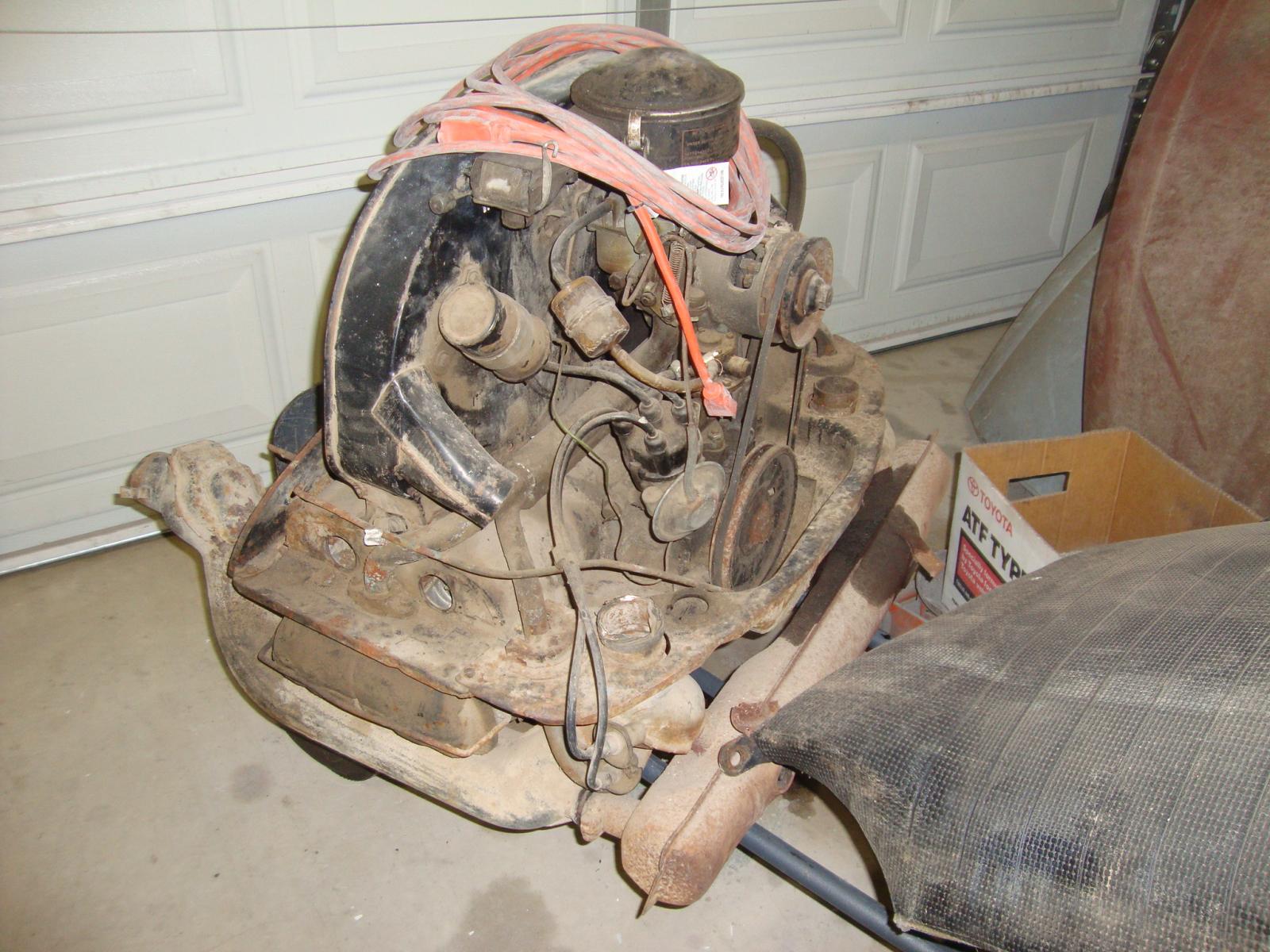

I have actually been working on this car for a few months and just now decided to make a build thread...so I will start posting pics of the build so far and get everyone up to date over the next few days.
The 58 had a locked up 1500 or 1600 in it and the split case trans doesn't seem to shift too well as it sits...the car had been sitting outside as-is for many years in the Midwest...it's pretty crusty.
I decided that on my budget I would try to find another car as a donor parts car to keep costs down. I found a rusty 67 that was used as a sort of dune buggy on Craigslist that had a decent pan and good trans. The original 1500 was blown up but the guy threw in a 1961 40hp that turns freely. I have under $900 in both cars and the engine.
I got the 67 body off the pan and started evaluating.

If nothing else the 67 will give you a donor roof skin and door tops for you top chop. You need those to stretch the roof and door tops depending on how you go about it.
You can also use the 67 transmission.
Up front you now have options. The 58 is a link pin beam and the 67 is a ball joint beam. The 2 are not normally interchangable. But on a volksrod, if you are going with a beam extender, you can get 1 that will allow you to use a ball joint beam on a link pin frame head and vice versa.

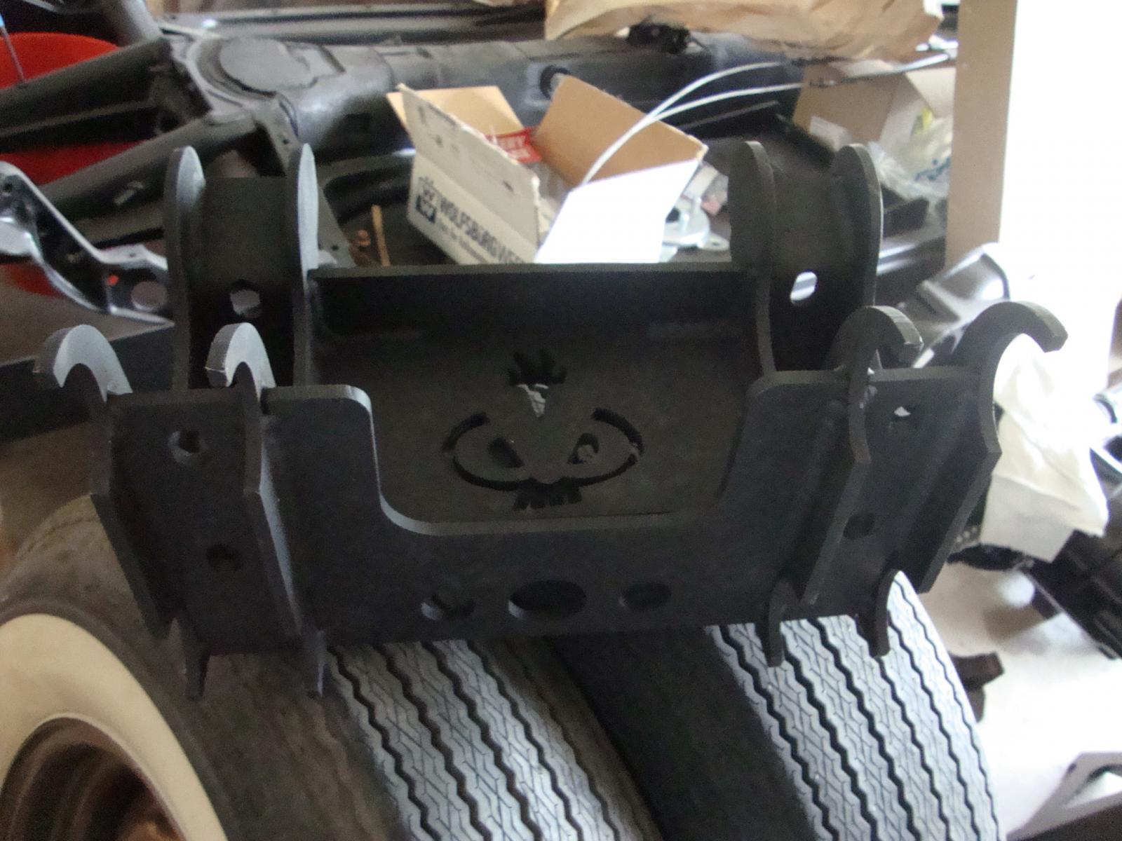

jtwaller wrote:
A cool way to extend the front end is to flip the beam around. I saw it on a vrod the last show. Made me take a double look at first. This may be an old way of doing it, but it was a first for me.
Caster becomes a real problem when you do it like this. Ackerman is totally off the charts. And most of the cars done that way are no fun to drive. In fact they are scary as hell!
An extender lets you go 8 or 10 inches and keeps most of the important geometry where you need it. Ackerman is about the only thing effected.
Of course you could also say to heck with either beam and go with a Speedway I beam front axle. Not a bad kit but the anchor point for the radius rods needs to really be beefed up if you go that route. They are prone to failure. The rest of the kit is pretty good stuff.

drscope wrote:
I totally agree about the wacky driving on the flipped axle. Beam extender or Speedway/ Early Ford is the way to go.
I have parts to go either way actually...I have an 8" extender from The Volksrod Shop ready to bolt on. The front beam from the 67 is a new VW unit that was added just before I bought the car so I think I'm going to run it initially.
I tripped on to a deal I couldn't pass up at a swap meet earlier this year...it was a Speedway Motors axle mounting kit complete in the box. I then located a rough but salvageable 39 Ford front axle that was already converted to juice brakes. I may run this set up later...all depends how the car drives and looks after I get it on the road.
