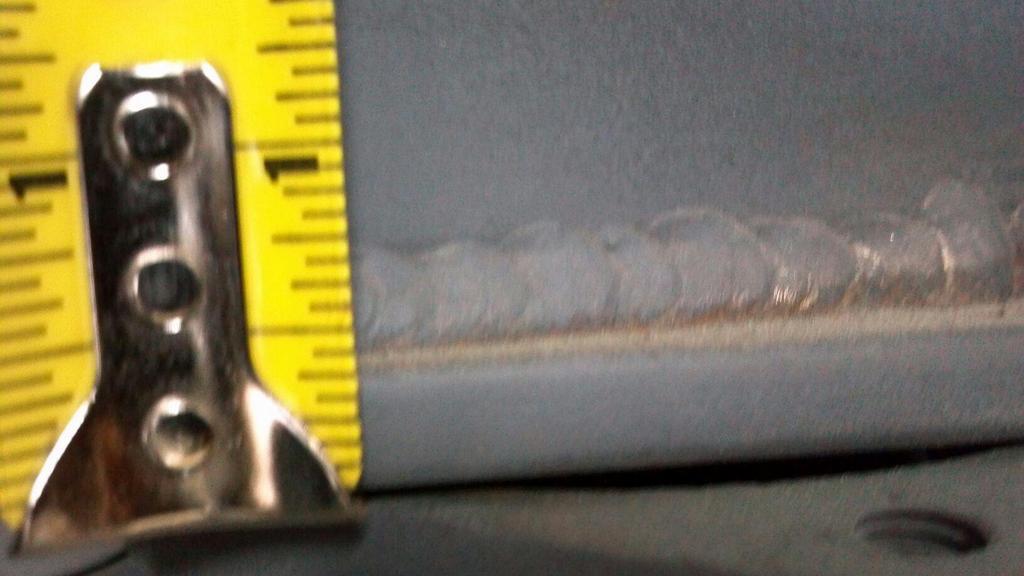

PostPosted: Thu Aug 30, 2012 5:17 pm    Post subject: Reply with quote
Here is a few pics Pete, I hope this helps you a bit.
As you can see from the pics I have 3 bolts in each side of the beam & 2 in the back. When I mocked up the flat stock for the rear, I simply placed the springplate cover on it to mark hole centers. Mirror imaging was a snap once I had one built to my liking.
Fwiw, my bus is not "gravity centered" whatsoever but it does not bother me at all. My cieling wouldn't allow it.
It's also sorta tough to do any bodywork on the nose at this point, I have the tube which runs under the bus a little shorter than it really should be. When it comes to replacing the lower 6 & inner & outer valance, I'll nudge it back a little.
[/img]

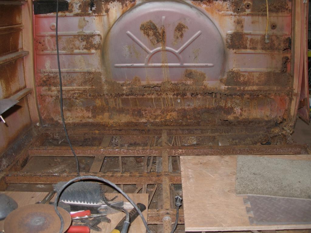

PostPosted: Wed Oct 31, 2012 6:25 pm    Post subject: Reply with quote
So, i got the floors - what was left of them - cut out and the frame appears pretty solid. need to replace RF outrigger and jack point, inner and outer cargo side rocker, lower bulkhead, lower rear cargo wall, lower doglegs, and some of the belly pans. Fortunately the left rocker is really solid.
