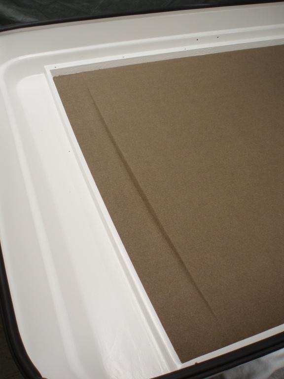

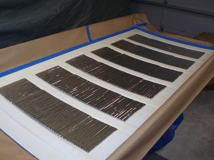

okay - following up on this thread. I decided to go with a Speaker box material since it was all synthetic, thin, stretchable, and came in a nice tan (my bus is Dakota Beige). But, the material would not really follow stretch quite enough to dip low between the support beams in the roof and not be too slack along the sides where the support beams taper to 0. So, I decided to go with a flat section in the middle. Then, I could also add in insulation for winter camping (it will also reduce condensation).
I added a small piece under the long piece of insulation in the middle (peak of roof) to take up the rest of the space. it fit perfect and filled in all the gaps.

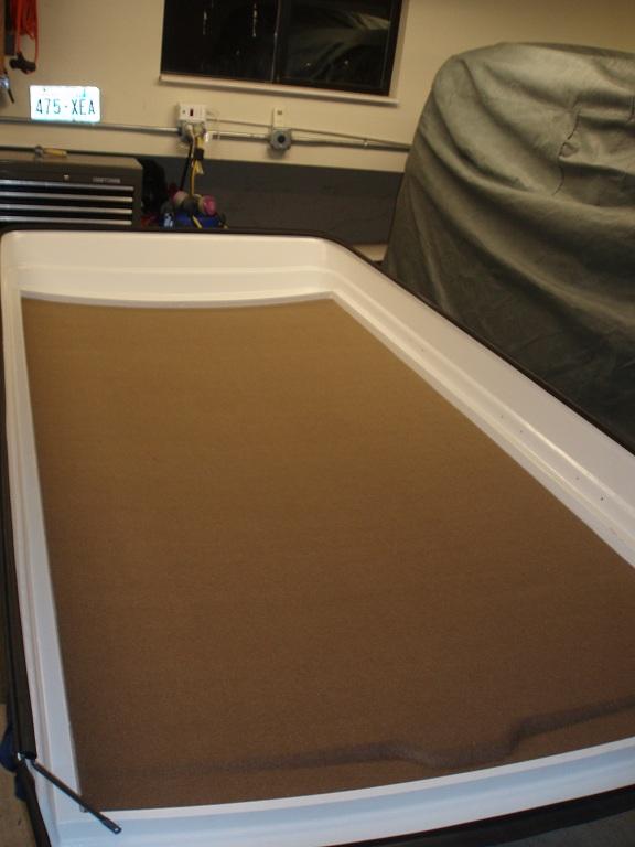

Finally, I glued down the new headliner material and trimmed the edges. it stretched and molded around the ends very nicely. Now, my roof is warm in the winter, cool in the summer and quieter year round. Also, no more condensation drips on the face when you wake up! #Sleep
