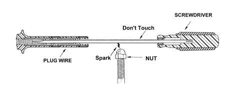

These are the first things I grab to isolate a cranks won't start problem.
Starter Fluid. If it fires on this you have a fuel problem.
Please read and understand the directions.
Spark Tester. No Spark you have an Ignition problem.
Be aware these are made for both Points Ignition, which includes electronic points, ie Pertronix etc.
and HEI (high energy ignition) systems.
So get the one you need for your vehicle and read and understand the instructions.
Or if you don't have those on hand.
As mentioned first thing you need to do is determine if it is
1. Fuel
Pour a couple of table spoons of gas down the carburetor throat and try and start it.
If it starts or tries to, it is a fuel problem.
2. Electrical
Test for spark. What you are looking for is a nice hot blue flame. Not an Orange or Yellow flame they are too cold.
