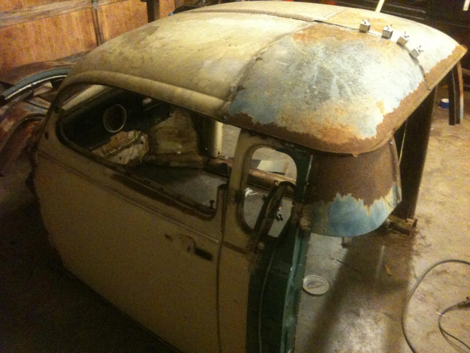

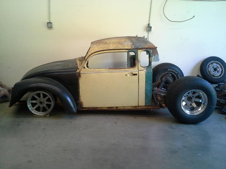

When we decided to chop it
4'' chop
Extra cab window
Bus rear roof

The rear roof section is a split bus roof. I had to take 10 1/4'' out of the center of the bus roof. The body line in the roof of a bug is not in the roof of a bus, so I have started dollying the body line into the bus roof. I am going to fade the body line out over top the quarter windows. The drip rail is considerably different as well. These too will be dollied into shape. The rear window will be a bus rear hatch cut down to size. The bed will be a model A style truck bed. Engine and trans will be in the truck bed. I have yet to decide on building a full tube chassis or going back to a bug chassis. It really comes down to a time thing. I want to build a tube chassis, the future wife says she wants me to have it done for our wedding in Oct 2013. BTW all VW theme wedding.

You still have time to go mid-engine with it. Rear tires and the wheels are perfect.

Please, please, please go with a type 3 cooling setup on this so you can run a real pickup bed in it. I hate those pickup conversions with a wimply little storage space that is mostly taken up by a spun aluminum gas tank, and the fan shroud sticking through the bed.
