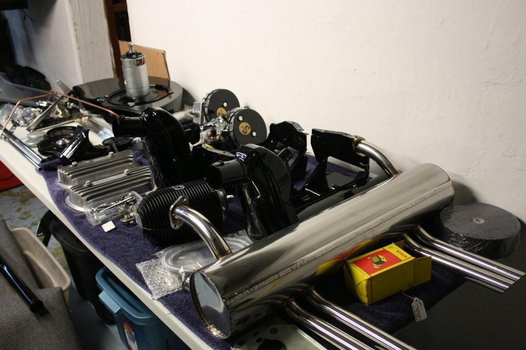

- Mahle big bore p&c's
- Square boss heads rebuilt by local guy Dougy Dee
- NOS 64mm crank
- NOS stock cam
- NOS rods
- case work done by RIMCO (checked the bore, deck, cut the case for cam bearings, walnut blast inside and out.)
- 010 distributor rebuilt by Glenn Ring
- Speedwell sprint kit (linkage by Alejandro)
- Berg sump
- 4 tip stainless muffler by Mr WOB.

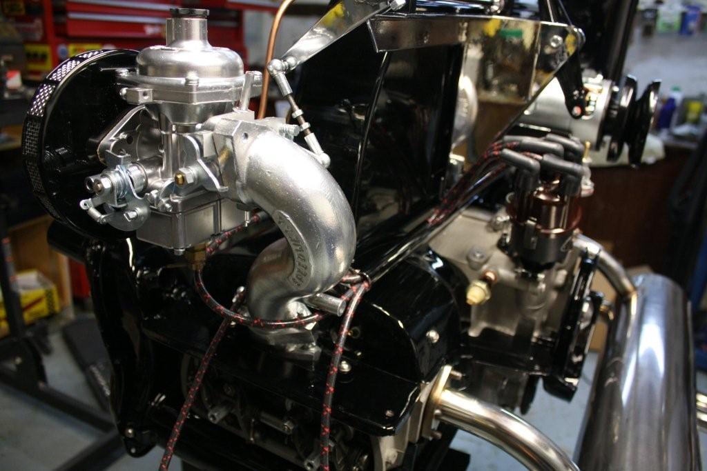

Stromberg carbs and Speedwell intakes before and after.

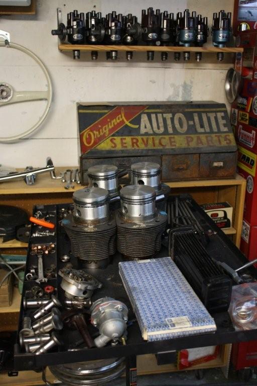

Mahle big bore kit. Skirts cut down to clear case webbing. Balanced against each other.
Table full of parts ready to go.

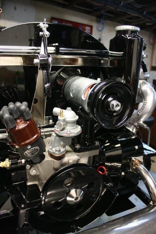

Almost ready to fire.

Kjell Roar
Joined: December 08, 2008
Posts: 1328
Location: Norway
Kjell Roar is offline
PostPosted: Thu Dec 20, 2012 10:27 am    Post subject: Reply with quote
Really nice!
How much did you have to take off the pistons? Any pictures of it?

Wow Dave amazing as always! What kind of fuel pump is that?
That is the Danish made fuel pump that is currently available.

Mr. Motorhead wrote:
Ya, I normally keep one on the shelf as a back up. I considered running it on this motor but I've decided to run a rebuilt oe pump instead.

What model/size Stromberg carbs did Speedwell kit utilize?
beautiful work!
bryan
Thank you for the compliment! The Strombergs are CD150's.
