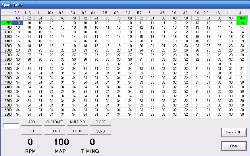

OK I'll post mine. Please know that it is still in the experemental phase, and I would not consider this a final or even necessarily a proper map. I was still working through AFR and EGT data, when I got side tracked.
This is the default NA Dual carb map;
The engine is NA 2276cc with 86b Cam, DRLA 45s and 9.3:1 CR. I ended up needing more timing in sooner than the default map, and added a bit more advance under light load and lower RPMs.
I also added an idle valley at 800 RPM, which helped idle stability tremendously. This really made a difference in cold start and setup of the carbs. Before the valley, the engine hunted a bit and the idle time bounced around. I ended up backing the initial timing down from the default of 15 degrees to 10 degrees, and opening up the throttle valve a bit more for the same RPM. It may also be of interest to note that idle MAP is in the 82-86 range, but will drop down into the mid 60's under light load.
I was working out a slight lean spot in progression, at 3200 RPMs when I took this screen shot. My cruising EGTs seem a bit high, but WOT is in range and it runs fairly well.

Looks to me like the default map is basically a mechanical curve. With that cam, dual DLAR 45s and an idle MAP of 82 to 86 KPA, can you really use MAP as a load reference? Does your system allow you to use a combination of TPS and RPM instead of MAP?
I suspect that you could use a lot more advance at idle and light load but I don't know how you could program it using MAP for load.

I'm running the Magnaspark digital, and it is RPM and MAP. I can log TPS to my innovate unit, but there is no programming for it on the ignition.
The engine just started to behave normally with the increase early and cruise settings. I haven't gotten back to it, to try more. I had a very slight lean spot at 3200 RPM, which I changed the air jets for. I haven't goofed with the timing since.
I was increasing timing to lean cruise further, and just couldn't get it to respond correctly in the 16:1 AFR range. I found an error in the instrumentation that I haven't sorted yet, but getting the progression smoothed out helped.

You should re configure your load boundaries. I would start at 75kpa and blend over to 100kpa. This will give you better resolution in your spark table.

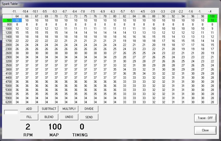

Hoping someone can help me understand here... please be gentle if I have got this all wrong!!!
I have a magna spark which I am looking to put on my 36hp motor with charger.
I took a little time to map (or so I think) the VJUR 4 Br8 distributor as a starting point, with a simple 1° off for each lb of boost, which will be no more than 7lbs max.
so, the original dizzy mechanical advance is 7.5° static, up to 23° @3400rpm
the original vac can is 1° to 17° from 5 inHG (85kpa) to 15inHG (51kpa)
so my max total advance is 40°, reduced to 33° at 7lbs boost.
I could probably do with revising these figures as I took them from the upper levels of the brackets. however what I need to understand is how to put these into the table.
I set the table to go from 51kpa to 178kpa
Question is, If I have kpa advance/retard across the top and mech adv down the left, do I add the two together in each cell? `doing so gives me a very different looking table from any seen here.... so Im a bit confused tbh. Any advice on how to make the two advances work together on the table?
Apologies, done in excel for now... blue line is where vac is coming in.

Anything from 100 kpa down can be mapped like the distributor diagram you have posted if desired.
Anything above 100 kpa (boost) should be mapped carefully and 33 degrees advance is too much for a boosted engine.
Ignition advance is more based on Intake Air Temps than boost to a degree.
With a blower it is always making hot air so your ignition advance will need to be adjusted down accordingly.
If I were you I would be very careful with any advance over the standard 30 degrees unless in very light cruise...... seeing as how a blower will see cruise IAT's as high as 160 degrees F........You might want to weigh your options.
I myself have found that IAT's above 130 degrees F. need caution and adjustment on cruise ignition advance.
When I drive our buggy from Washington State to California I have to lower my cruise advance because I see cruise IAT's of 130 degrees F. quite easily.
My turbo will add about 10-20 degrees to the ambient temps and in Cali you can easily see temps of 106* F. or more when driving through the Barstow area.
With my ECU I can have it retard timing according to Intake temp and also boost.
I use the IAT feature in cruise...... It helps so I don't have to remap my advance bins if I do long distance travel.

updated with 30° max advance across the board... does this look like it might be 'right'?
