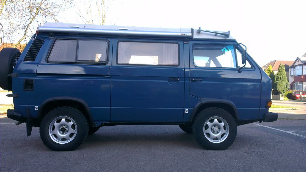

i have one too, a westfalia multivan
just a couple things, pads and calipers are the same as the 14". Bearings are the same, but bearing housings are different. Any shock that fits a 14" will fit a 16" But the bus will feel nicer with stiffer shocks.
As i have just found out the girling 60 upgrade works fine on a 16" (thanks benT) and you can use a 303mm vented disc! But the stock 16 steels might not fit, guess I'll find out when I try to fit them Laughing
How'd you get on with the front locker?
Cheers, lloyd

lloydy, very nice van, love the rear insulated window. Does that open?
I started this thread for anything that's 16" related. The more the better Cool

PostPosted: Tue Feb 12, 2013 10:19 am    Post subject: Reply with quote
Yes, the window slides open. Very nice thing to have, you can get some good airflow though the van with it open. Took about a year to find one! The van originally came with glass, prefer the double glazing for camping though.
Any hints on where to find one? Or was it ebay?
Currently:
lloydy
Joined: September 15, 2010
Posts: 715
Location: cheam surrey
lloydy is offline
PostPosted: Tue Feb 12, 2013 10:38 am    Post subject: Reply with quote
I got mine from eBay.uk from a vanagon specialist, it was not cheap. They might come up on eBay.de more often. I looked for a year, the one I bought was the only one I saw in that time. If your set on getting one, make sure it comes with the window rubber, they are specific for that window. The window is just about useless without it. Good luck! Very Happy
You can also ask on all the euro forums, you might get lucky
