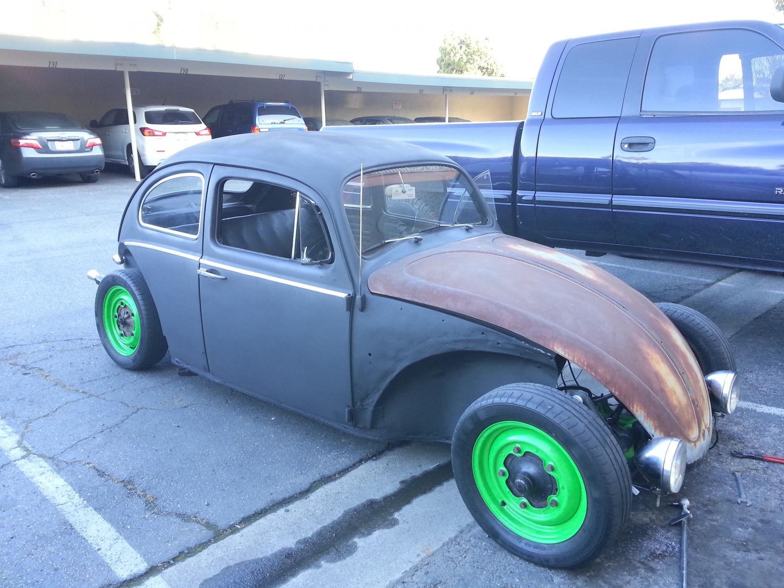

PostPosted: Wed Mar 20, 2013 2:54 pm    Post subject: Reply with quote

PostPosted: Wed Mar 20, 2013 3:05 pm    Post subject: Reply with quote
Mine sits like this and I have about 5k miles and knock wood I haven't stripped any hubs. I am using factory drums.

PostPosted: Wed Mar 20, 2013 3:50 pm    Post subject: Reply with quote
Thats about how mine sits... maybe when i dropped her i didnt torque it correctly. Im about 3mm from being lined up on the castle nut. already broken rachet and breaker bar (craftsman) on it. Going to take her to the shop and have them do it... Drive slow i guess.

Thanks for the replies. Ill post pictures of the camber from far. I had taken it down the street to a buddy's shop. They used a 1inch 1000lb rated impact. All seems well now, for the past day or so. When i took it there i could tell the nuts had moved somewhat as they were sitting directly on the cotter pins.
