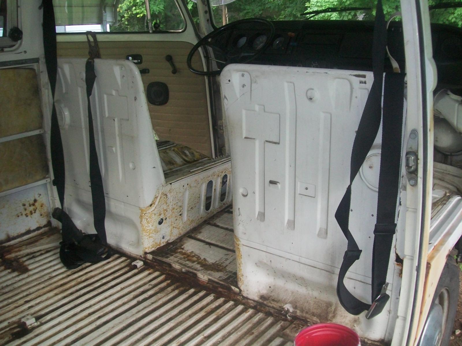

First order of business was unloading everything, stripping down the interior and evaluating what was there, and what I want to do to it.
Sink unit not too bad, but will need some attention. All the cabinets are present.
Found the cot.
It was so filthy I just grabbed the hose and some simple green, hosed it out, scrubbed it down and rinsed.
So now we have a bunch of clean rust to look at. Some of the rust spots were pretty bad, much worse than I originally thought. A number of holes in the cargo floor and the driver side seat belt anchor is totally gone.
Now I have a pretty good idea of the condition of the interior metal. Its worse than I thought and will require some cutting and welding to repair properly. Need to evaluate the exterior next.

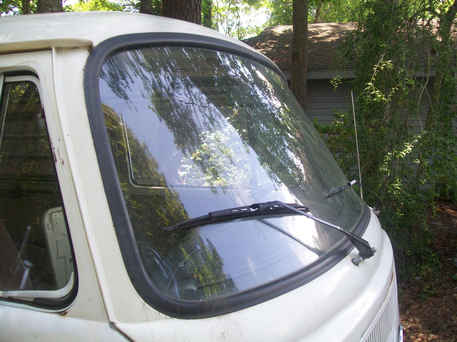

On to the exterior evaluation. You'll notice the scenery has changed as I moved twice since buying the bus.
Starting with the front, it looks to be in good shape. New window rubber, has been recently painted, no signs of rust or filler. Has a shiny chrome emblem. Not sure if it originally came painted or chrome. Bumper is pretty straight and the overriders are in a box full of parts. I haven't seen an antenna in this location before.

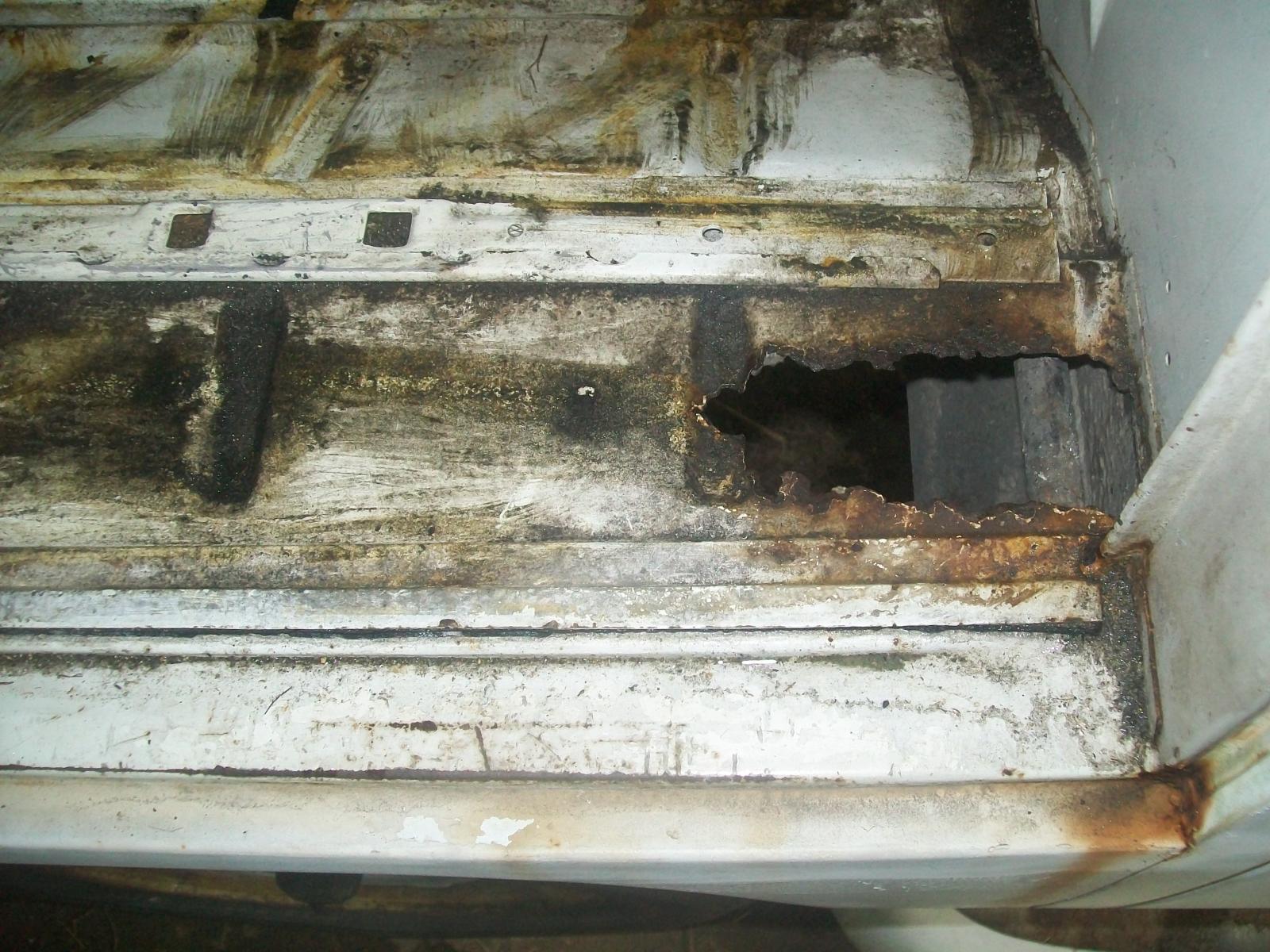

That's the good and here's the bad...the passenger side is the worst with major rust on the rear lower panel and rocker plus a hole on the dogleg.
The slider is fine, door works great but the outer rocker is mostly gone.
Also there is a weird strip of texture about three inches in width along the bottom of the body in places. You can see it on the door. Not sure what that is but it will have to be sanded off. Almost looks like tape.

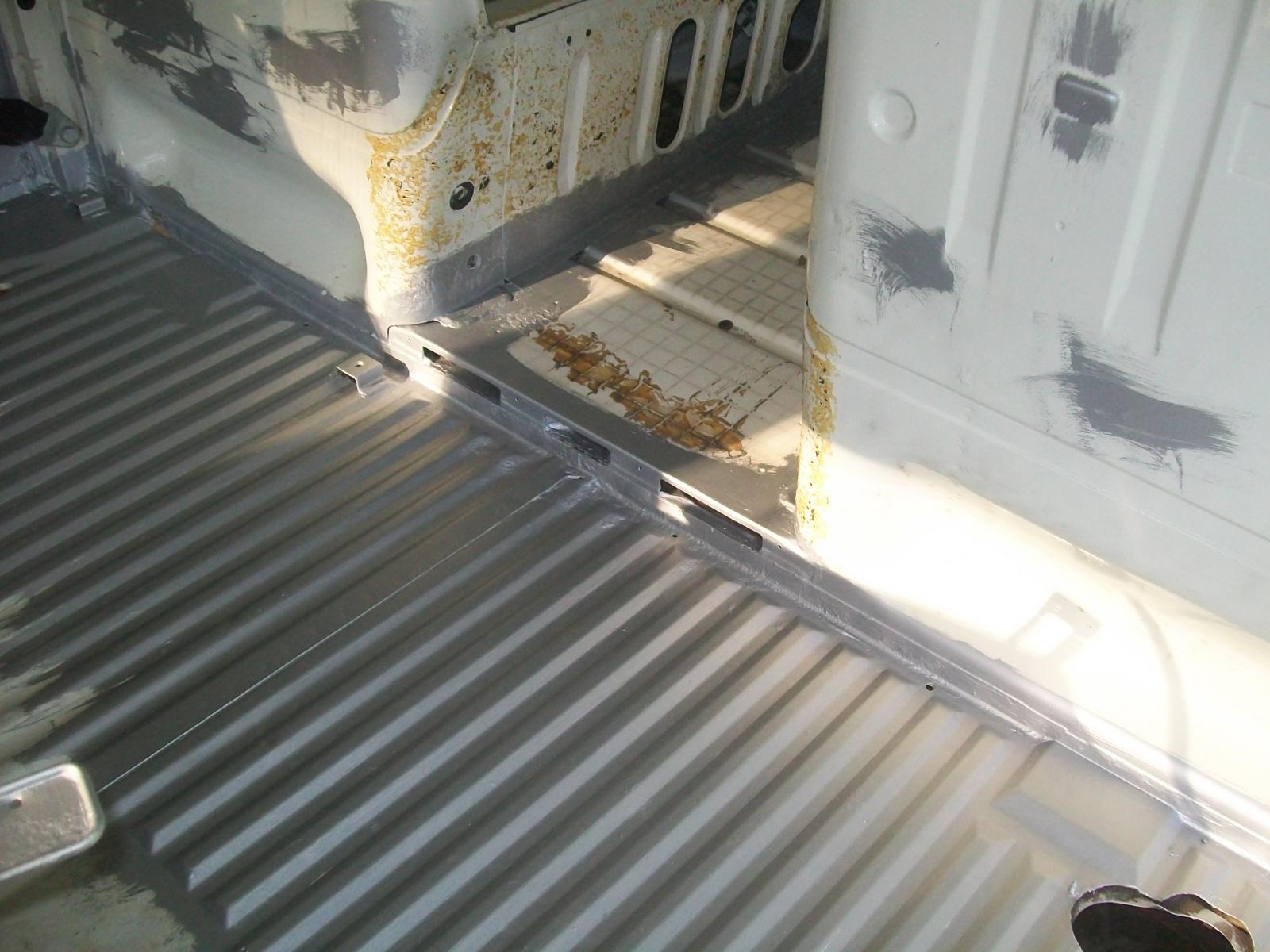

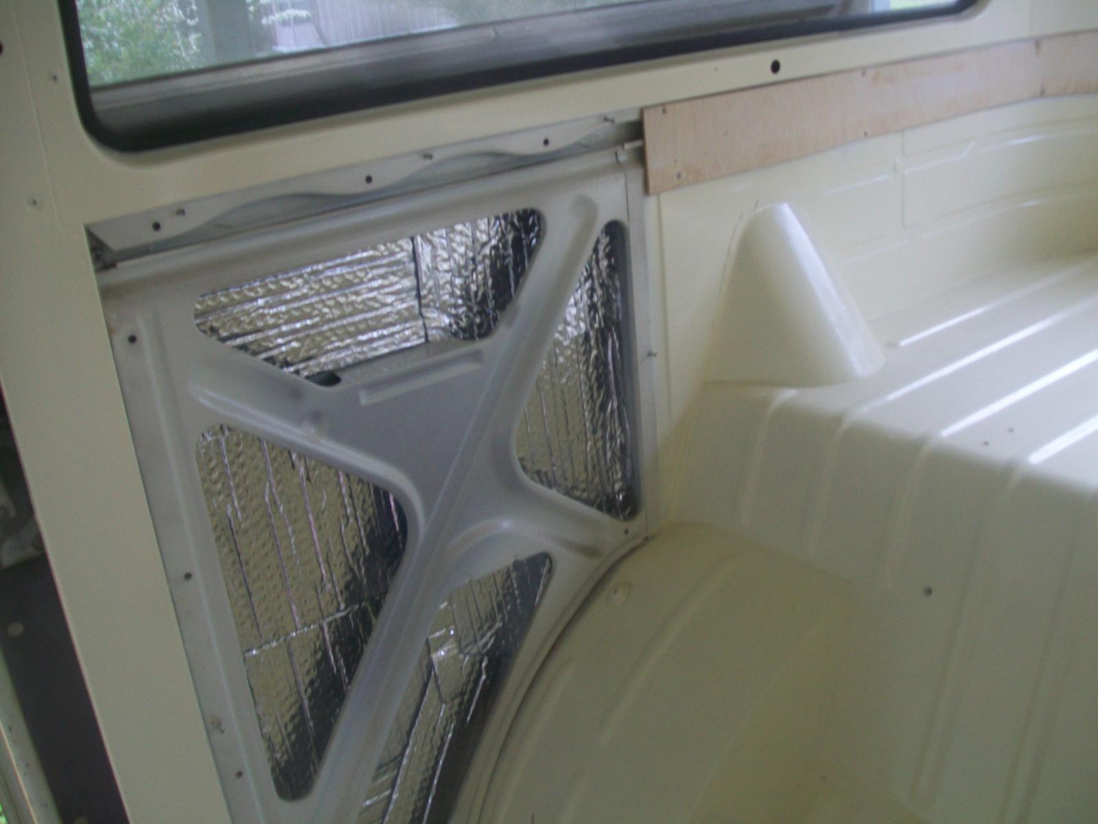

So after evaluating the condition of the bus and taking into account prices and part availability I decided on a plan. What we want is a bus that we can use. We want to go camping and traveling in it as a family. I may even want to use it as a daily driver. With all the rust I dont feel its the best candidate for a full restoration. What I will do is patch up the interior metal as best I can and stop the rust as much as possible. I'll rebuild the interior as close to original as I can, within reason. Actually the whole thing will be as close to original as possible. I'll look for a longblock and do the engine work myself, refurbish the engine compartment and electrical systems and sand and prime the exterior rust spots temporarily. I'll do the brakes and get proper tires. The exterior body work and paint will be left to a professional. At that time I'll also have him or her address the larger holes in the interior metal that are too big for epoxy and weld in a seat belt anchor for the driver.
Started the interior by grinding all the rust smooth and applying two coats of Masterseries silver. Chose that over the POR-15 after researching both. I really like how it went on, very pleased with the results. Hopefully this will at least stop the rust from proceeding. Then I used JB Welds Steel Epoxy product to fill the smaller holes in the metal. Be interesting to see how the epoxy holds up. Its hard as a rock right now. Once all that dried, went back with more Masterseries and top coated with Rustoleum white.
After dealing with the rust I cleaned and painted all the interior metal that will show with L90D pastel white from Wolfsburg West. Also pulled out the old fiberglass insulation and installed the silver bubble wrap stuff from Home Depot on the ceiling and walls.

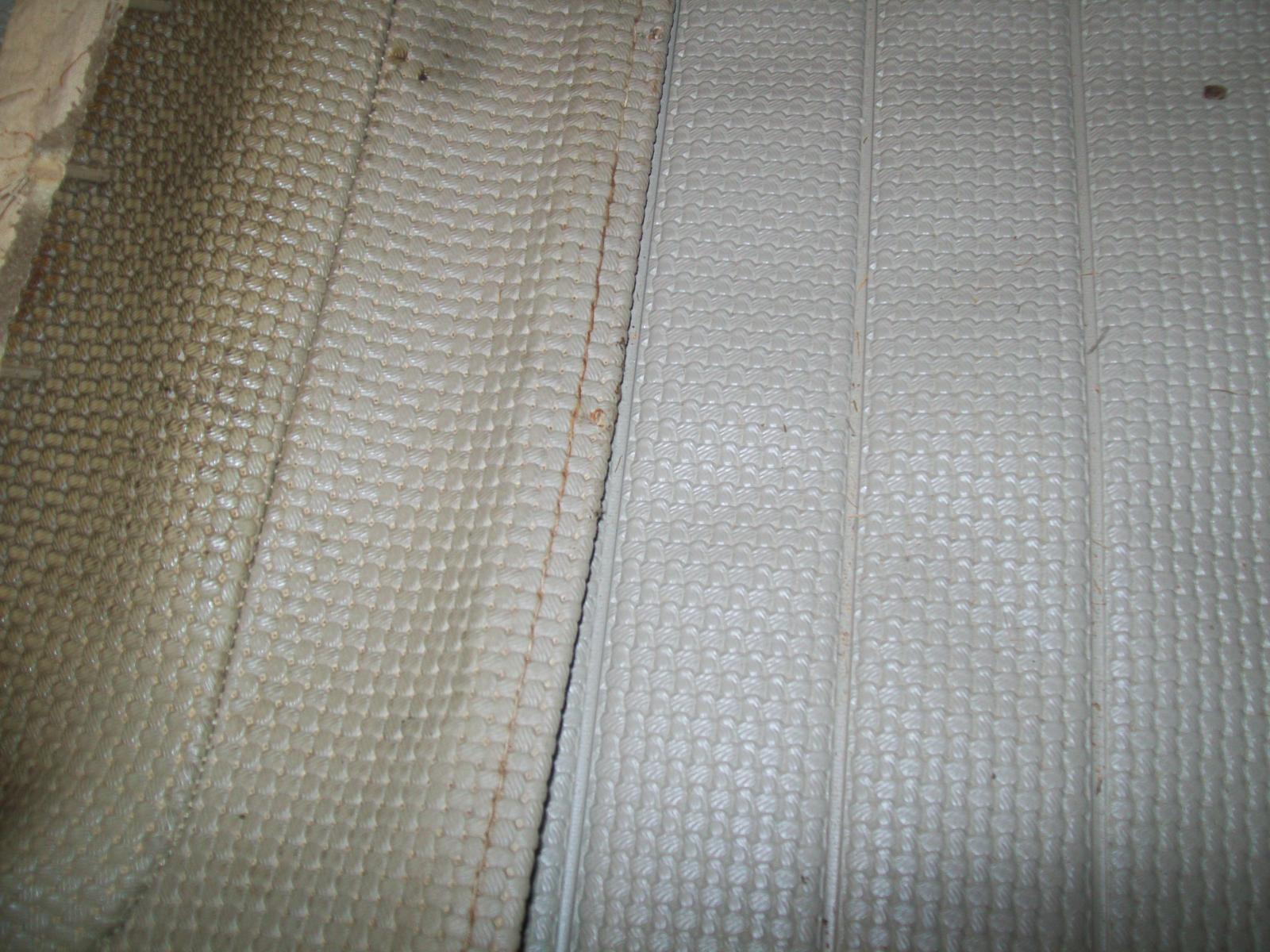

Got a set of seat stand mats from WW and installed them. A bit akward to get these to fit but once I finally got them on they fit great. Used contact cement on the sides, no adhesive at all on the top.
The front mats cleaned up nicely.
Now to address the front seats. The driver seat was the worst. Too far gone to even think about sitting on.
Stripped the old cover and padding off down to the frame. Found this odd framework item inside the padding. Not sure if this is original or not. It was embedded inside the coconut husk material.
Found two broken springs and had them welded. Painted the frame black.
Bought a set of covers from WW along with the original style "horsehair" pads, some burlap and some sisel felt type padding. I also got the hog ring kit. I was pretty worried about trying to recover these myself but it really wasn't as bad as I thought it would be. WW included a DVD that helped. I'm
really happy with how it turned out.
Here's a shot of the original cover next to the new one from Wolfsburg West. Almost an exact match. Beige basketweave.

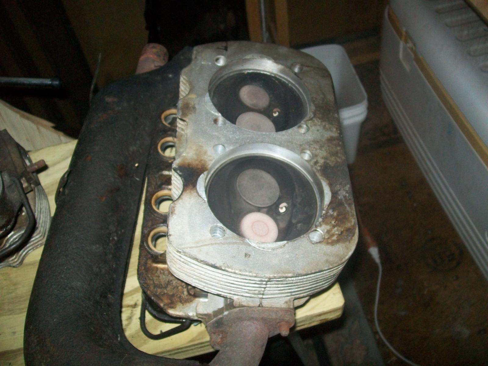

I stripped the old one down. With a hole in the case, its not an option but its possible that some of the parts can be reused. There is a set of heads, a crankshaft/flywheel, camshaft, 4 cylinders, 3 pistons and 3 rods, oil cooler, DP intake, 34 pict-3 carb, fuel pump, two heater boxes, a stock beetle type exhaust, crank pulley, 30A generator, clutch/plate, t.o. bearing, starter, 30A voltage reg, doghouse shroud and fan, complete set of tin and a crapload of misc bolts, nuts, etc.
After cleaning everything up and giving it some thought I decided to look for a used longblock. Goal is to try and reuse some of the external engine items and electrical components. Carb will need a rebuild and I'll scrap the beetle exhaust for a new stock style bus setup. This will allow me to get the thing running for a somewhat reasonable outlay and I can work on getting a new engine built they way I want it that's ready to go in a year or two.
First thing I did was buy the Bentley. I've always rolled with Muir's Idiot Book but the Service Manual is really a necessary item. I have both of them nearly memorized at this point.
I found a supposedly good used longblock with 50K on it from a fellow Samba member. I hope to get another 10K or so out of it. Enough to have the bus mobile while the renovations are completed and to take a few family outings over the next year or so. It isn't easy finding a used VW engine around here. They just aren't available like they used to be. Anyways, this is a 71 AE bus engine, supposedly well-maintaned with good compression all around. I had it shipped in, replaced the front seal, no end play, so far so good.
Here it is under construction, I've added the gen stand, pulley, valve covers, fuel pump and clutch/plate at this point. Its sitting on the heater boxes but they aren't on yet.

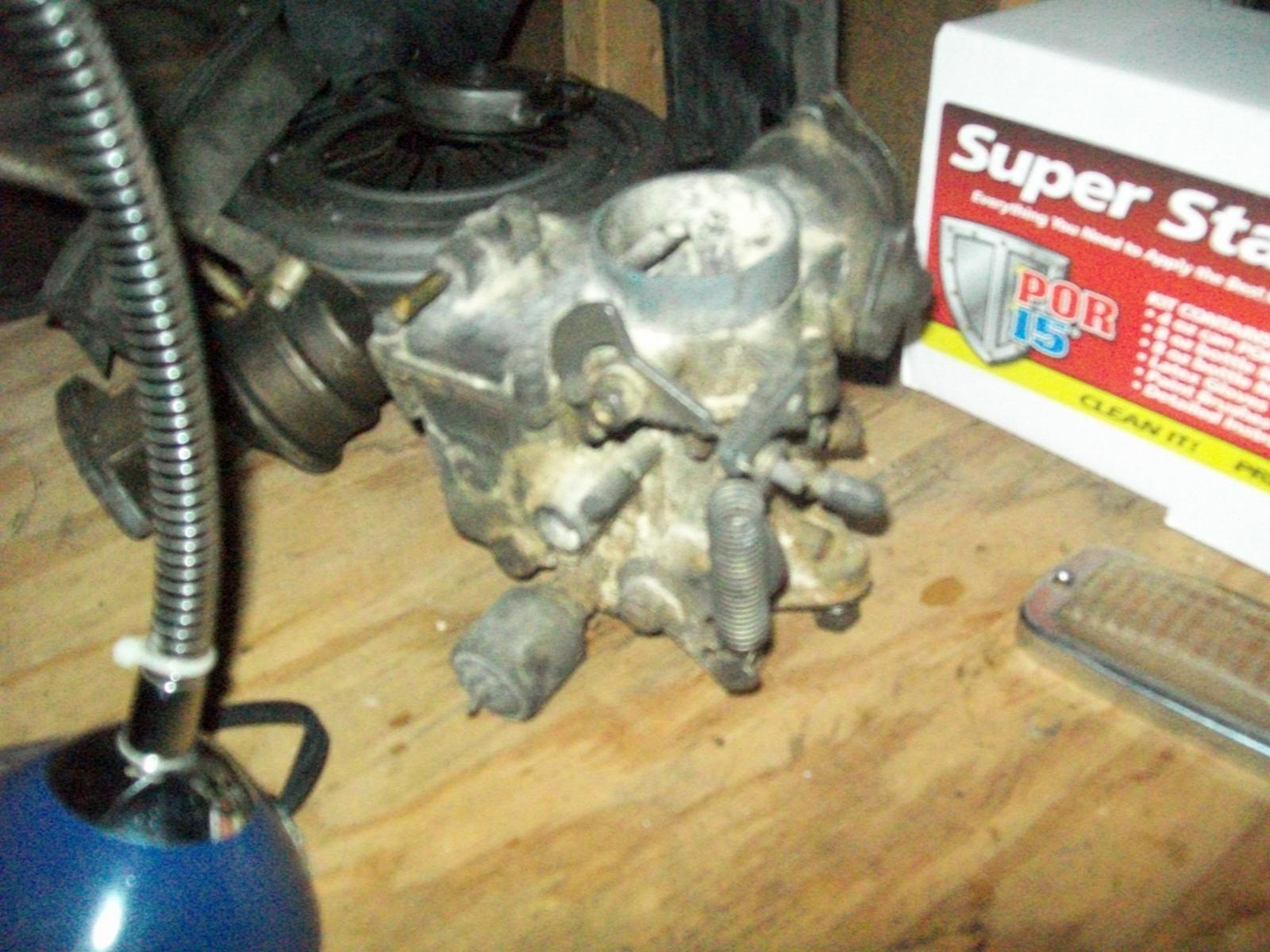

First try it would not start. Found that the OG fuel pump was shot. Replaced it yesterday and after a spoonful of gas in the carb to prime, it fired right up and purred like a kitten. But why not, right!? Dwell is 43 and idle is a bit low at 750 so I'll work on fine tuning it this afternoon and check the advance timing. The 009 will have to do until the newly rebuilt DVDA arrives next week Very Happy . Also need to install an accelerator pedal rebuild kit to get rid of the slop in the current one. If I can get the engine tuned just right I'll try and take it around the yard and see how close I got the shift plate adjustment.
