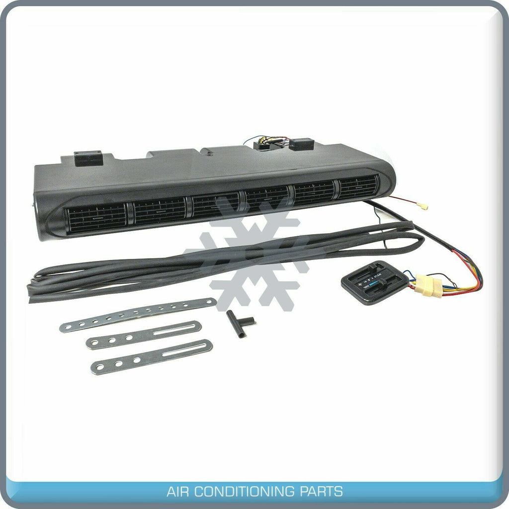

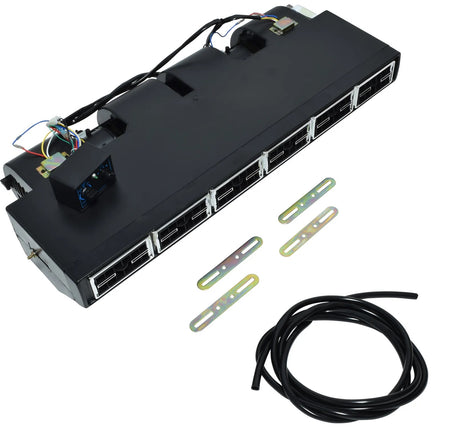

Hold (in progress, there is more to this than just these parts)
The 6-vent version is the 32,000BTU item. The 5 vent UN0886C is only 22 pass / 22,000BTU (5596 Kcal./H) / 390CFM
Talked to UNC, they buy this part overseas and no longer make it. they do not have the black avail....Would be nice to see where QualyAir is buying them to go direct on the black one.
https://uacparts.com/Downloads/UAC_UnivesalUnderdashUnits.pdf
Rock Auto (switches not pictured in description. I sent an inquiry on this but not sure if I'll get response)
https://www.rockauto.com/en/moreinfo.php?pk=12211333&cc=0&pt=1002013&jsn=367
QualyAir (who I initially bought from either Directly or through their Ebay store)
Black
https://qualyair.us/products/a-c-universal-under-d...&_ss=r
Gray
https://qualyair.us/products/new-a-c-universal-und...&_ss=r
There is also a more "retro" look UN 0891C which is also 32,000 BTU
Rock Auto https://www.rockauto.com/en/moreinfo.php?pk=12211365&cc=0&pt=1002013
Cold hose (which is a GREAT place to get stuff BTW) has it with the control knobs that Steve used https://coldhose.com/collections/under-dash-system...7191291135
Relay
https://www.amazon.com/gp/product/B0CF1SLXPV/ref=ppx_yo_dt_b_asin_title_o07_s00?ie=UTF8&psc=1
It takes some special wiring logic to send just trigger/signal signals to avoid sending the full fan amps from front of vehicle to back.

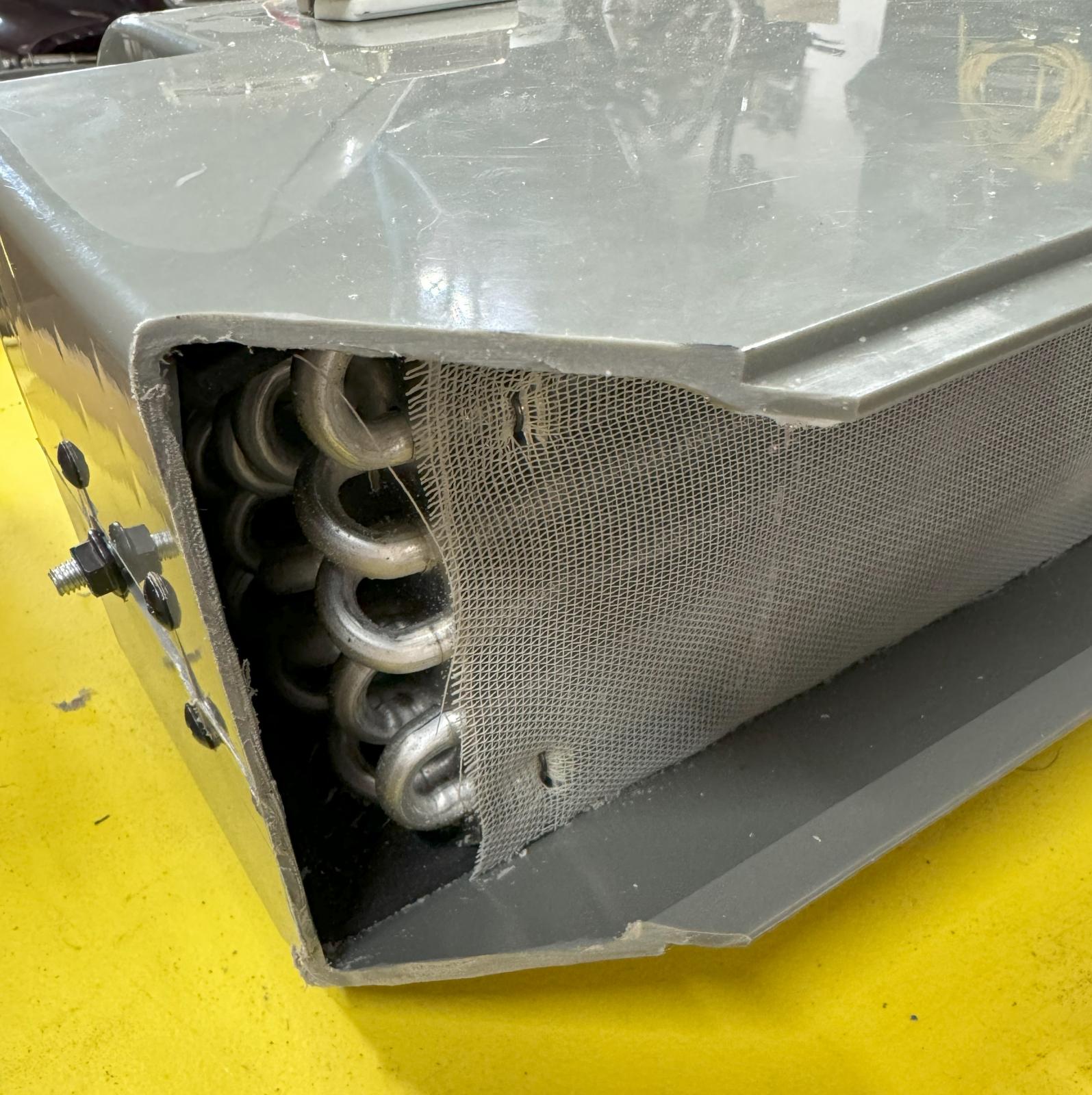

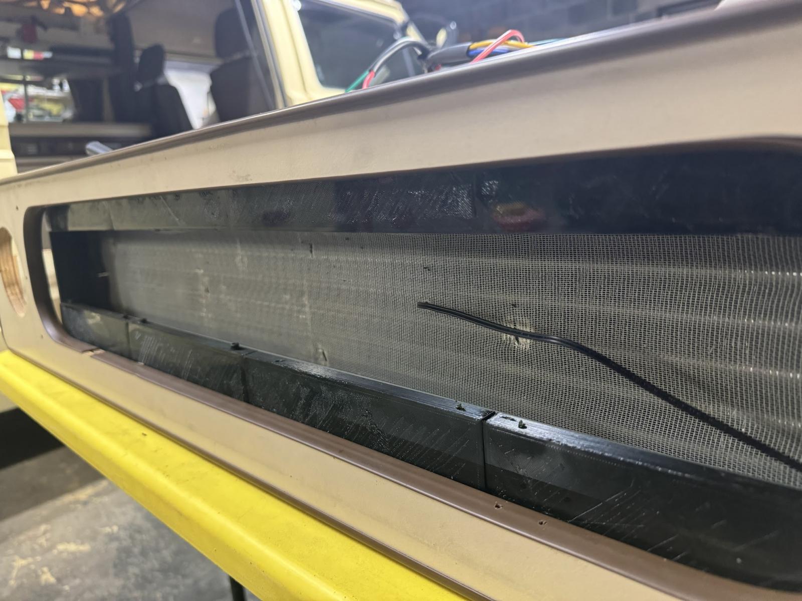

I have been working with Andy on this project. Last year, I overhauled my entire 83.5 dealer-installed headbanger system but didn't see great performance. I replaced everything except for the evaporator.
There is an image here on The Samba comparing the core size of the early AC to the later model, which led me to consider upgrading my evaporator.
After speaking with Andy and seeing pictures of the universal 32/35k unit next to the original Westy headbanger box, I decided to move forward with the project.
I went out of my way to maintain the stock look and the original headbanger faceplate. I removed the vents from the universal AC evaporator, cut the sides off the housing (to fit the speakers), and modeled and 3D-printed pieces to adapt the output to the stock two-vent faceplate.
It was a ton of work and days of 3D printing, but I have it all installed, and it is working well. I'm not finished with my install yet. Currently, I'm using Redtek and seeing about a 32°F delta. I hope to get better results with R134 and plan to recharge soon since there is one fitting piece I didn't have at the time. I also had cans of Redtek on hand and wanted to use them.
More pics/info to come.

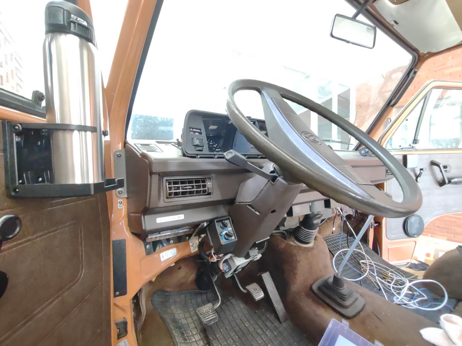

A parallel development:
It's been running about a week. Maybe 4 hours active time.
It is oversized for the application. It gets the wife's approval. The fan is strong enough that your whole body is cooled. On high speed it moves hair.
Need more time to evaluate, but so far it works better than any other car's A/C I've had.
It's running with a 18x26 condenser with a single 16 inch cooling fan.
The compressor is a smaller sanden, less displacement than normal. Model SD7H13. This was to fit the limited space on an air cooled. The compressor, mounting kit are for a 79 bay window from Gilmore Enterprises. I had to add spacers to the mount and drill an extra bolt hole to accommodate the shape of the Vanagon's fan housing.
Only downside is the idle speed had to be increased. Now it's annoyingly fast when the compressor is off. I'm working on electric idle control.
It affects power noticeably, but not a lot. Driveability is no worse. On high, the evaporator fan uses 12 amps @ 12volts. On low, 6 amps. The condenser fan is a Spal and uses less than 5 amps.
Spal 30100400 16" Straight Blade Low Profile Fan https://a.co/d/09muY974
http://www.sanden.com.sg/opencms/opencms/sites/def...p?pid=1004
Anecdotally, with interior temps above 100, and outside temps above 90, by the end of the block it's comfortable inside. At idle it remains comfortable in full midday sunlight
At 45mph+, I turn down the fan and and increase the temperature. The compressor runs about 2/3 of the time.
I just got some thermometer probes and will do some proper checks this week when my son is available to do the driving.
Carry on...

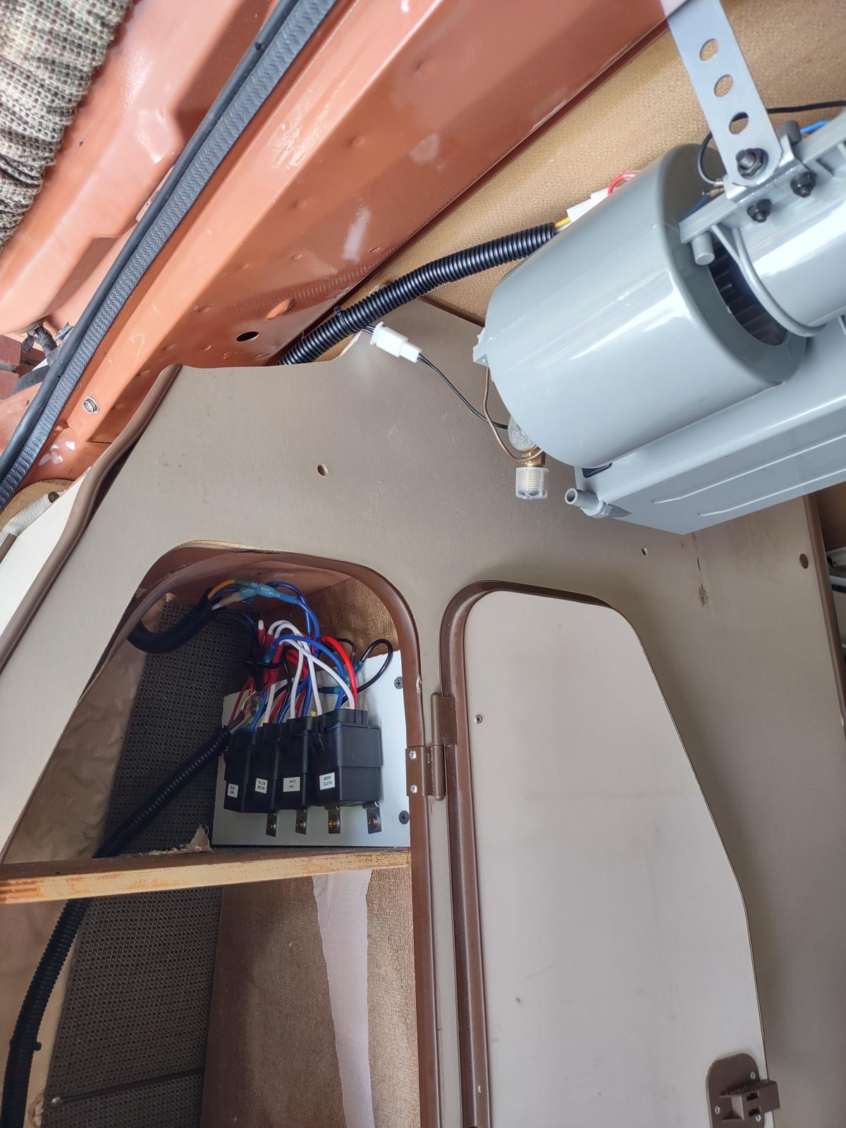

Yeah, I used 5 relays:
3 for fan speed control
1 for the clutch
1 for the condenser fan.
The temperature control is low current and needs to be connected directly to the evaporator thermistor leads.
I cut PVC boards for panels and used 7 wire thermostat cable to connect everything, except for the high current wires, those are all 12awg.
The only thing I don't like is the temperature control makes a buzzing noise when it engages.
The 65 amp alternator seems not to notice the new loads.

PostPosted: Wed Jun 26, 2024 9:53 am    Post subject: Re: Hold post for AC system replacement announcement Reply with quote
I ran 24awg wire from the trinary fan switch in front to the relay array in back. Relays are cheap, about $3 each. Wire is expensive. 24 awg single-strand 7-wire thermostat cable is cheap.

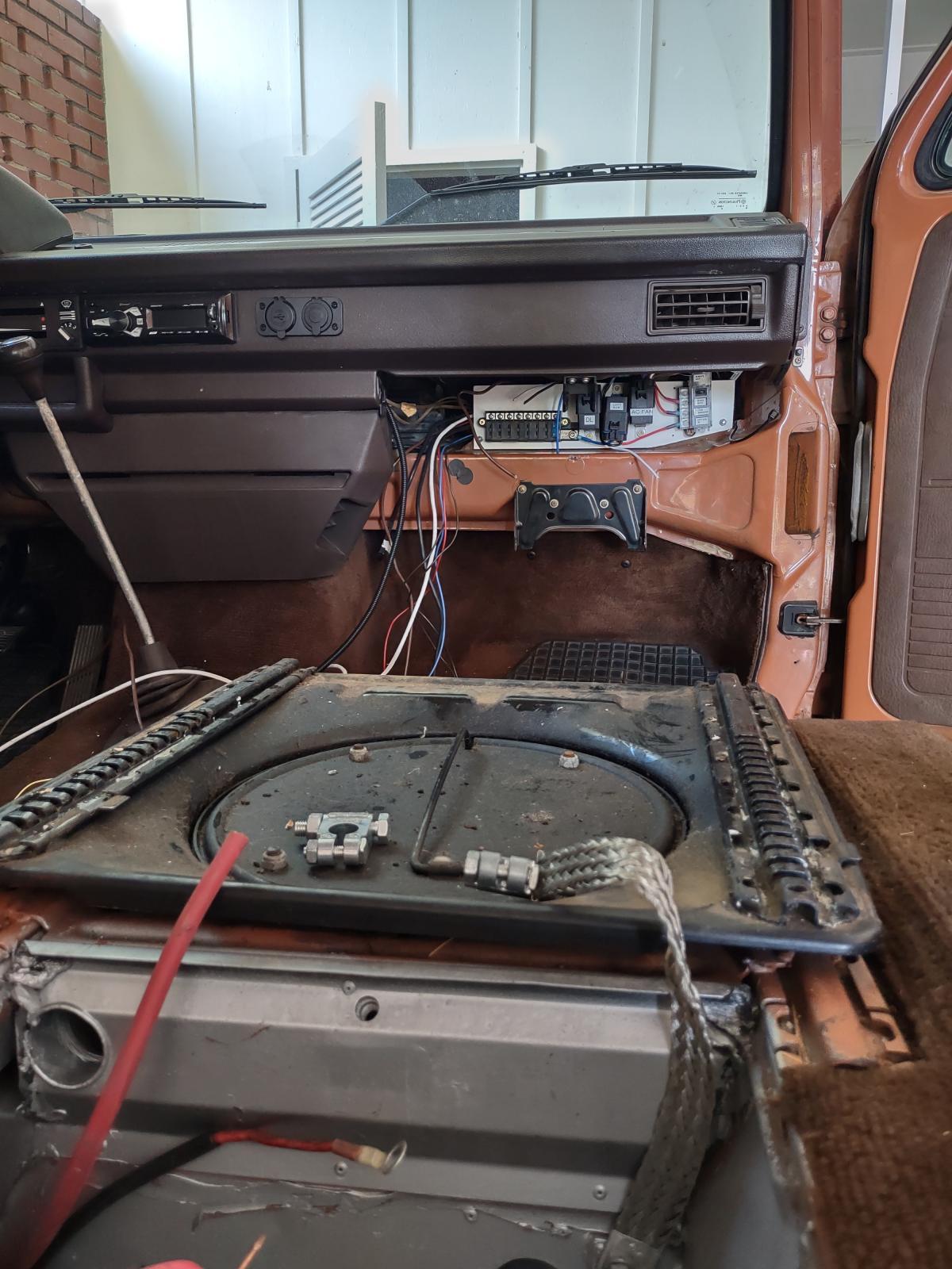

steve244 wrote:
The relays I don't hear, it's the Chinese temperature control next to the fan switch that buzzes. I jump every time it engages.
My temp control is originally on the fan unit at the back. Where was/is yours?
What's on the PCB board behind the glove box?
