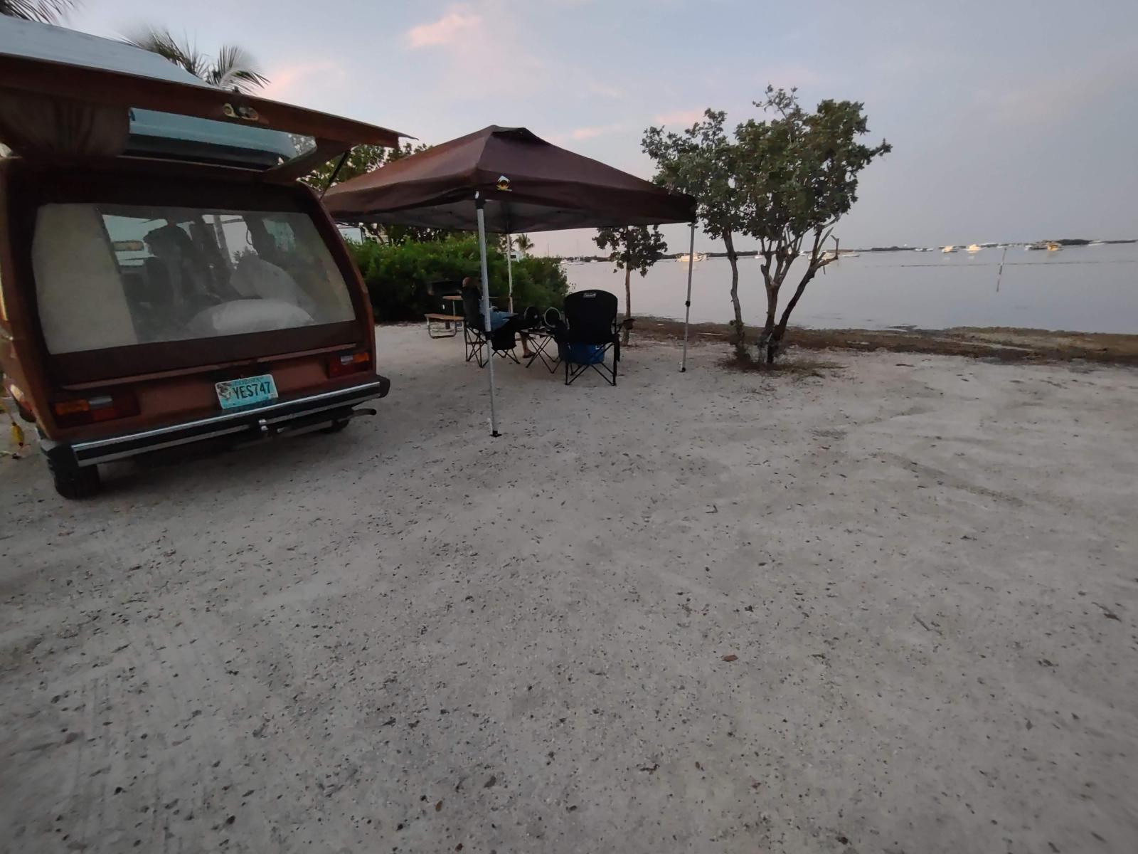

We pulled into Key Largo at dusk. The waterfront tent site turned out to be the parking lot across from the boat ramp.
Meh.

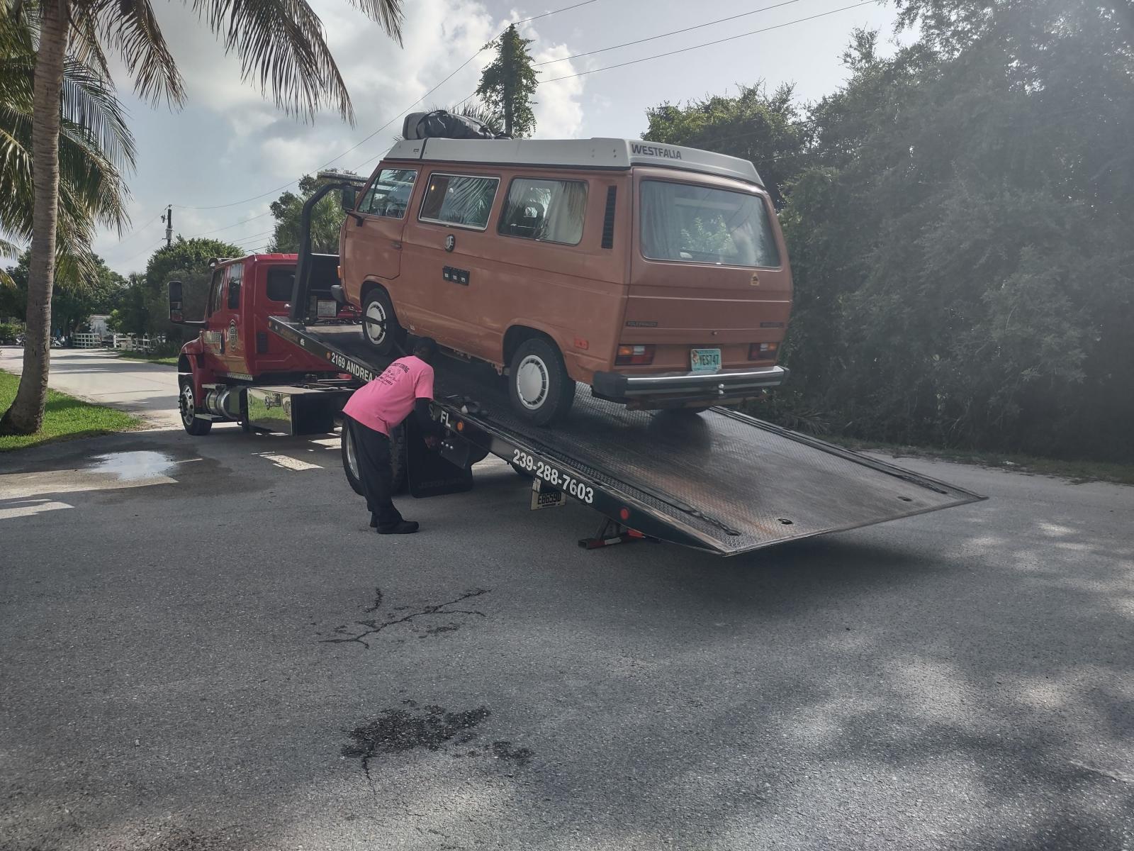

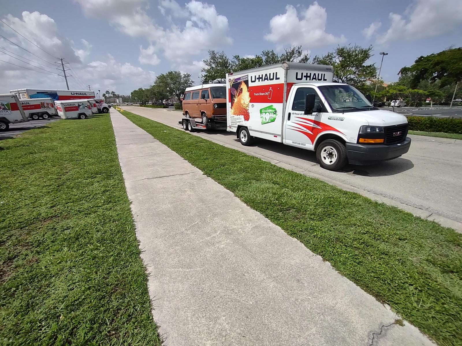

Hagerty's towing insurance came through quickly and competently. Towed it to Fort Myers (nearest major U-Haul). Only waited about 15 minutes for the truck to arrive.
He offered to get help get it on the trailer at U-haul. I said good by as I thought it'd take an hour to get a truck and trailer ready.
They set it up in less than 30 minutes, and the van, god bless her, had enough get-up-and-go to wheeze up the ramp and settle down.
