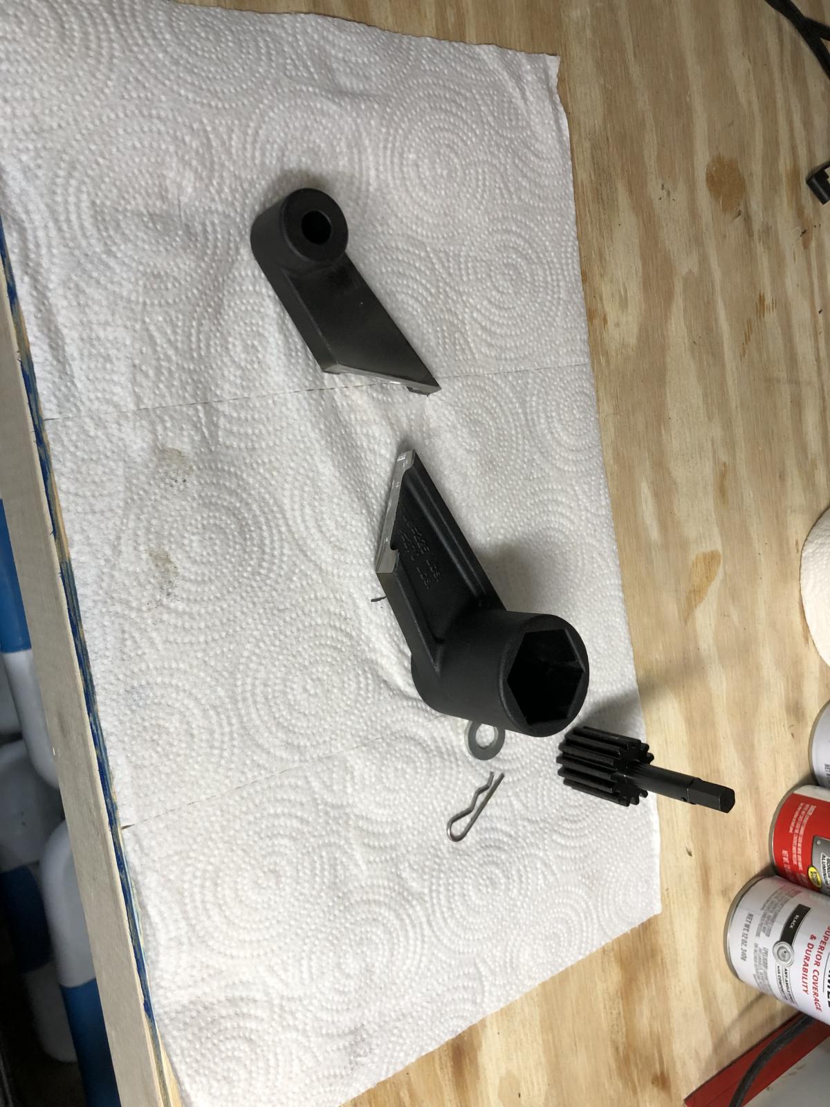

I purchased a Torquemeister look-alike from Amazon. The drive gear does not engage the flywheel enough to do the job. Can anyone recommend a retailer that sells a good one. They all look the same in the ads.

OP, the drive gear (the little one) is reversible on the TorqueMeister tool.
Pull the clevis pin and switch the gear to the opposite side of the tool and try it again.
You have to swap it around when you use it for removing axle nuts versus flywheel gland nuts.

I have used one before and am familiar with it’s operation. Switching gears around or flipping the tool won’t help. The drive gears are not the right pitch to engage the flywheel. The gear also barely touches the flywheel. Standard flywheel. 36mm nut. I already returned it.

The genuine full kit comes with both two drive gears a 6 volt and a 12 volt pitch drive gear for the two different starter rings..
Probably just the usual Amazon junk dealers.

I purchased the Empi branded tool. It comes in the same box and same packaging as the Amazon tool. Obviously it’s also made in China. The fit was marginally better, but there was very little gear tooth engagement and the tool would slip when pressure was applied. I was able to make it work by angling the tool slightly to get better gear engagement. I guess that counts as a win. I just expected better fit and finish for 50% more money.

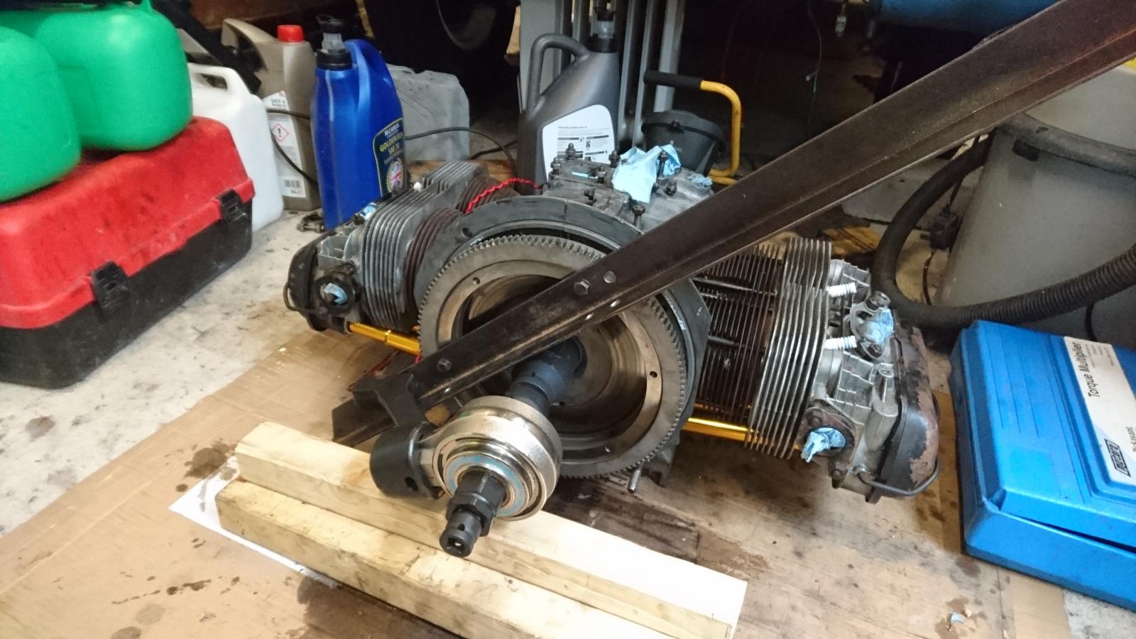

I wonder whether the multipliers that I see advertised on ebay as Ford Ecoboost and Ecodiesel torque multiplier tools would work better for most users? E.g. https://www.ebay.co.uk/itm/387322862558?_skw=torqu...BM7tfDv8Rl
They're under £90 (just under US $120 at today's exchange rate), which is cheaper than the single-purpose 'Mr Torque'-type flywheel tool and I reckon it could be used for flywheels, hub nuts (and other useful tasks around the home Laughing )
Rationale: -

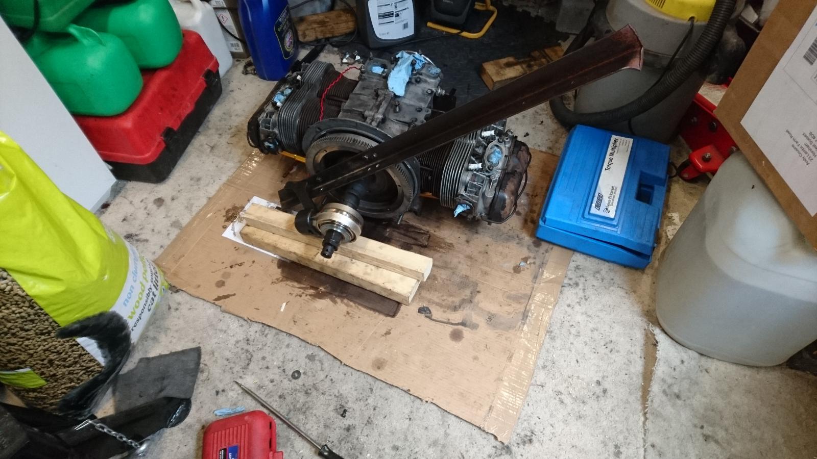

I got lucky several years ago and picked up a Sykes Pickavant Motorq torque mulitplier (TM) that was misdescribed on ebay, so I got it ridiculously cheap. It's an utter monster and OTT for my application, but it works brilliantly for accurately torquing flywheels and rear axle nuts. https://sykes-pickavant.com/products/80060000-a-mo...q-input-dr
My TM is the 'traditional' style, designed for multiple purposes. The head contains the multiplier gearbox. It comes with two different reaction arms that attach to the head. One is a straight, round reaction bar, the other an offset/angled reaction 'foot'.
For flywheels, I use the foot in combination with a piece of angle iron bolted across a couple of clutch bolts. It's basically the Muir approach, but the TM avoids having to use some dodgy scaffold pole to extend a breaker bar or torque wrench to gain the extra leverage. The reaction foot engages with the angle iron (pics below).
For hub nuts, I just use the straight reaction bar.
The Ford ecoboost/ecodiesel tool linked above appears to be a similar arrangement to the traditional TM that I have, but the casting of the head is extended. It effectively has the straight reaction arm built in to the head, which should work for hub nuts. The kit comes with a bolt-on arm that attaches at 90-degrees to the built-in arm, effectively creating a reaction 'foot'. That could be bolted to the angle-iron for flywheels, effectively achieving the same result as below.
I don't need another TM, so I'm not going to experiment on anyone's behalf, but it occurs to me that tool should work in just the same way as my traditional TM.
This is what my TM arrangement looks like for torquing a flywheel. Mine's a monster, s I have to support the head with blocks of wood or bricks. The ecoboost/ecodiesel tool looks lighter, but still gives a 5:1 advantage. I reckon it would be easier to use.

The retailer was kind enough to warranty the defective tool. I had to provide proof of destruction. I sent a pic and received a refund.
….and then I welded the tool back together 1mm shorter. Obviously I am not a professional welder. It works fine now.
