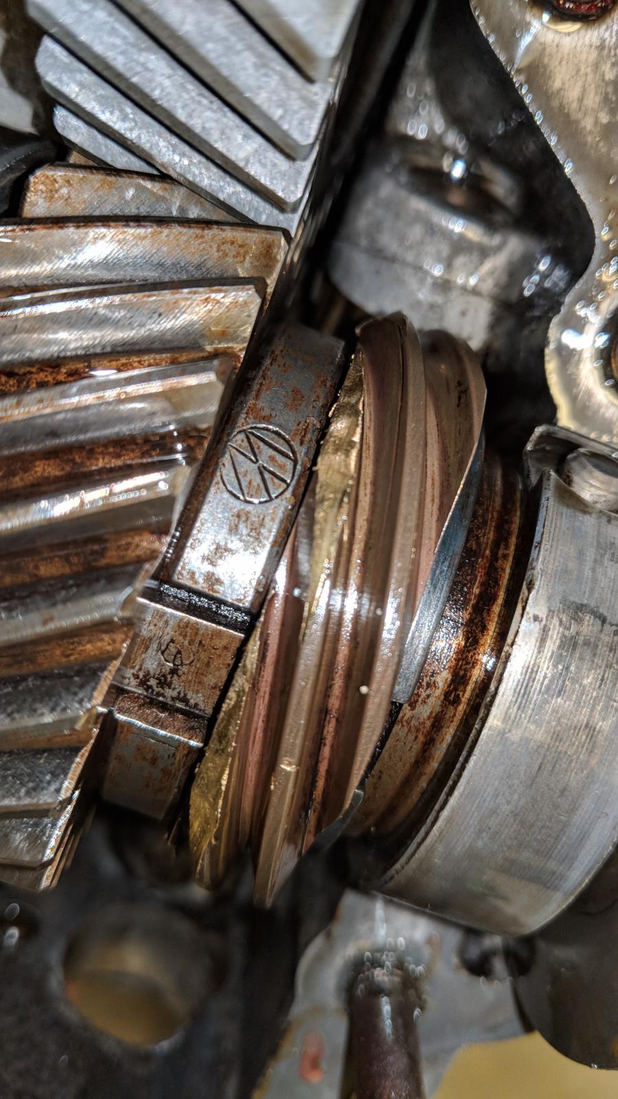

I have this bug hear that has a rattle in the engine. Pulled the belt off and its still there so I know it ws in the engine. I pulled it apart and found a few things. One , the arrows on the pistons were pointed away from the flywheel. What would that do? Second, I can push the valves side to side a little on the spring end with the springs on them. The heads look all nice and new but they ay vw so im assuming there stock heads and needed valve guides but thy just threw it together anyway. What would that do? 3rd, the distributor gear on the flywheel is chewed up. the distributor drive looked fine. Why? haha thanks for the help if you can!

Someone turned the engine over without the distributor in place and chewed up the gear, that's probably the noise as the distributor pinion will hammer up and down on the gear. Not sure if the pistons are offset but put them on the right way. Valves usually don't make that much noise, they just carbon up the pistons and combustion chambers or blow a bunch of smoke out the tailpipe.

The pistons probably are offset (hence the arrow). They will slap less if put in the right way, though according to formula Vee lore, you will lose a few horses... Laughing
Loose valves/guides is a recipe for disaster. That rocking you could discern is probably too much. Measure the valve stems for wear limit, change the exhaust valves if you suspect anything, high mileage, anything. I skimped out and it cost me 2 months of my life rebuilding an engine in strained conditions.
You probably wanted to type "crankshaft", not flywheel.
Do you remember seeing the narrow, long spring about an inch long between the bottom of the distributor and the top of the distributor drive when you took the engine apart? Should've been one there. It fits into a hole in the top of the drive and pushes the drive down against the brass gear on the crank when the crank is spinning.

Isn't there supposed to be a spacer between the cam and distributor gears?
Uh, yea...it's the thing marked "VW" in the picture above Laughing !

slalombuggy wrote:
Someone turned the engine over without the distributor in place and chewed up the gear . . .
brad
At first glance, I would have agreed, but take a closer look . . .
My bet is "Mr Goodwrench" used a drift (or one of his screwdrivers or his wife's butter knife!) to beat the gear off of the crank during the last "rebuild" . . . before installing the piston bassackwards! Rolling Eyes
How does the other side of the cam gear look?

57BLITZ wrote:
brad
looks the same all the way around

demon1018 wrote:
57BLITZ wrote:
brad
I figured as much . . . the brass gear (drives the distributor ) looks to have been beaten off of the crank during dissassembly . . .
What I was wondering is . . . what does the other side of the STEEL GEAR look like? The one that drives the cam . . . . does it show signs of abuse?
When the proper tool is used for disassembly, the gears are not damaged.
I double checked today and the spring is there

57BLITZ wrote:
demon1018 wrote:
57BLITZ wrote:
brad
the steel distributor drive gear looks fine . I dont see anything wrong there
