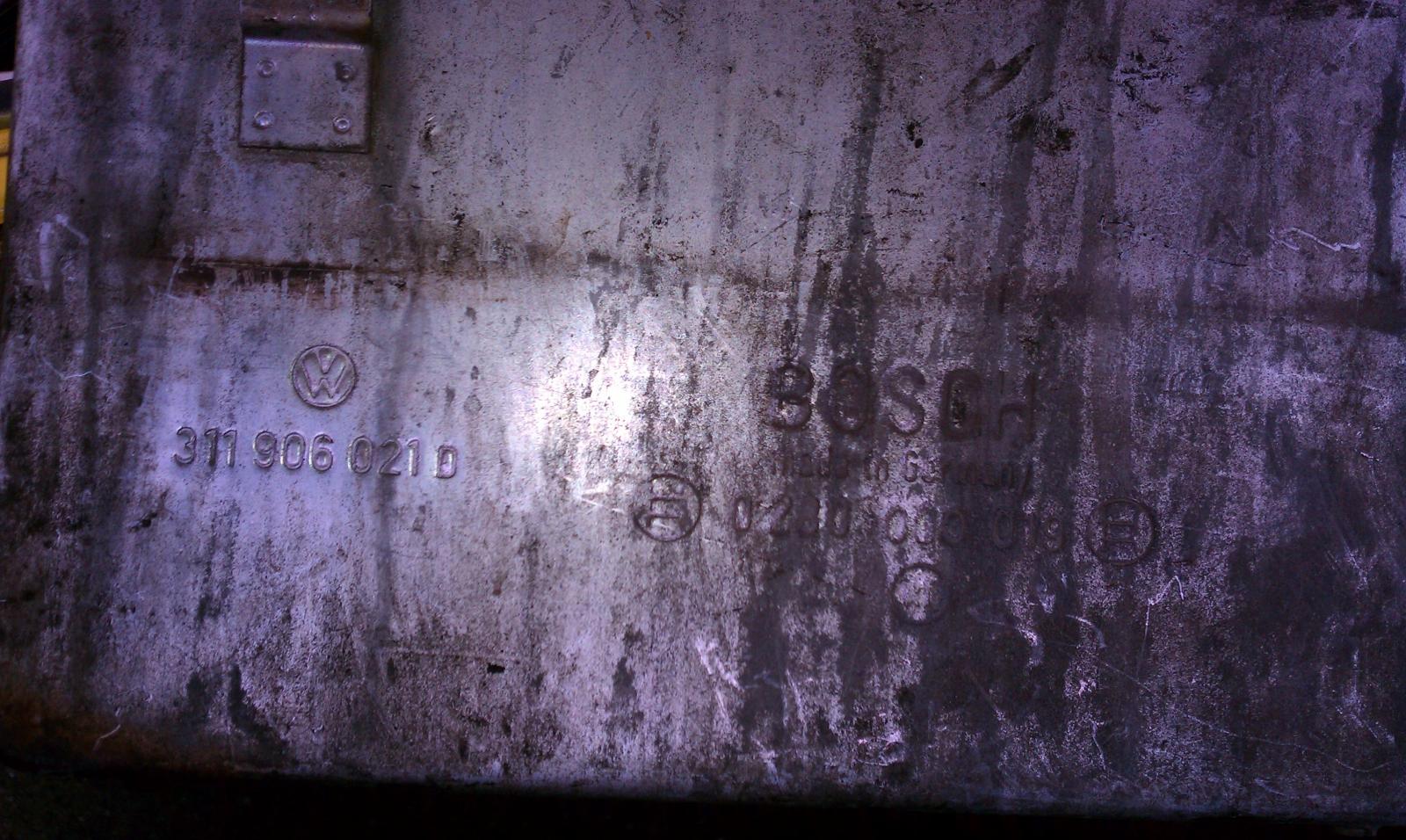

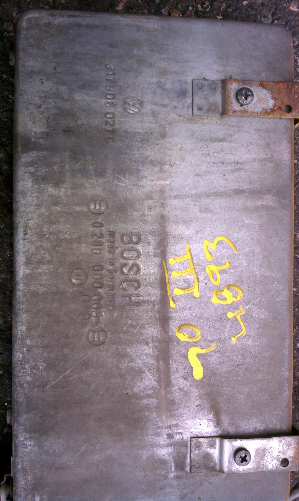

so for those of you who are following my "rescued a fat chick today" thread, you already know. for those NOT in the know, i removed this old ECU\harness out of my 71 square, after finding too many breaks....
then, i installed THIS one, pulled from a known good running car, but my buddy Nate forgot the year. Is THIS the proper harness for my 71? any issues that anybody forsees with using THIS ECU?
any help\info about this ECU would be GREATLY appreciated...

1968- 69 = A/B
1970 = C
1971- 72 = D
1973 = E

AFAIK a very few late 1972 California Emissions cars appeared with an "E" brain and system, but that chart is misleading. "E" systems appear on cars built after August 1972, except for the Cali emissions ones I mentioned above.
And you are correct that C and D pieces can usually be mixed with no ill effects, but the 1972 D system with the dual vacuum advance distributor doesn't run right with C parts- the lone exception being the MAP sensor. 1971- 72 cars actually came with a "D" MAP, but the C was designated as the factory approved replacement for all D systems.
