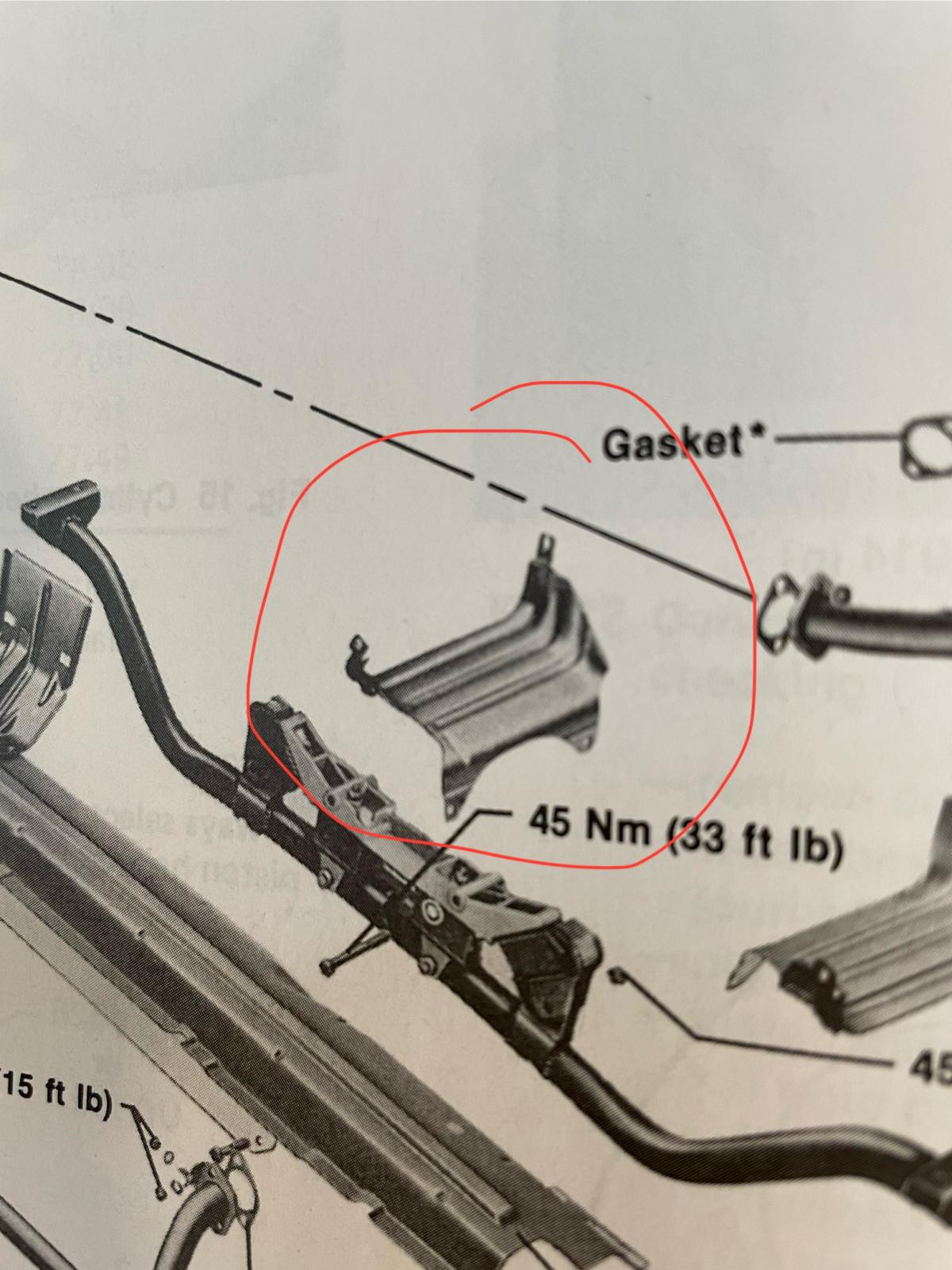

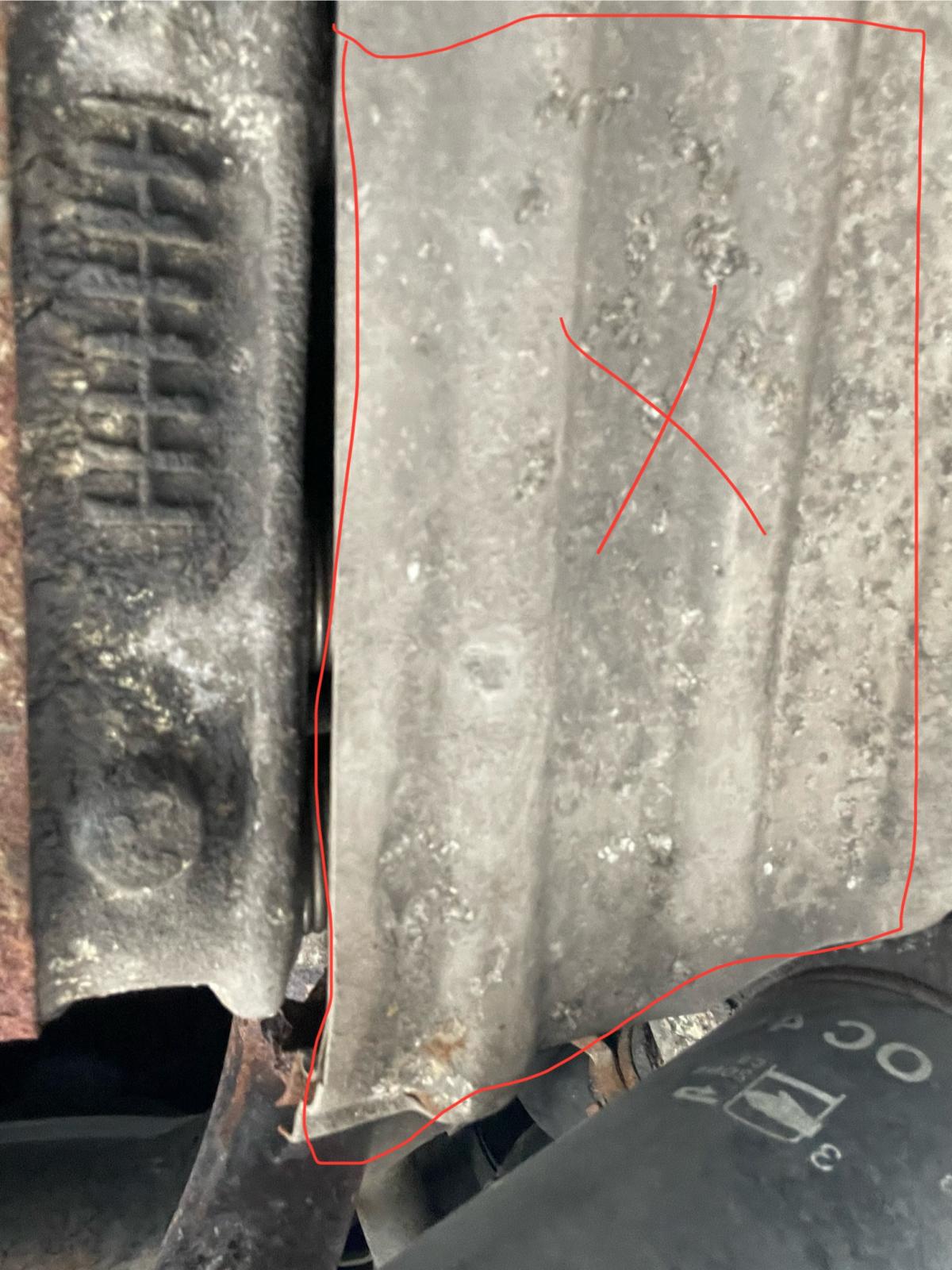

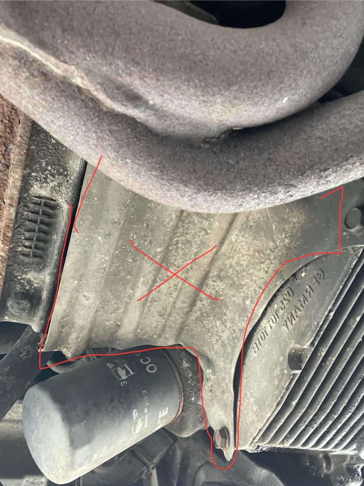

I’m looking to replace the part shown. Part number? Source?
