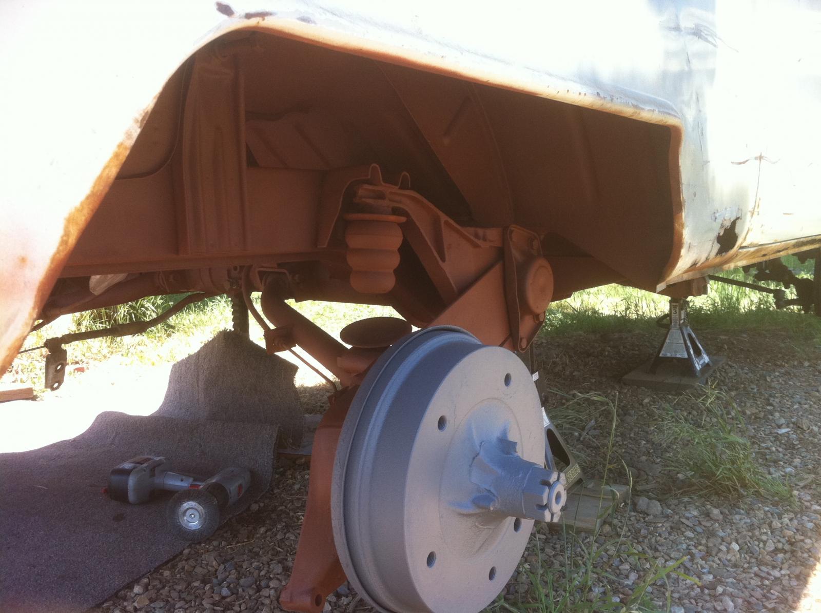

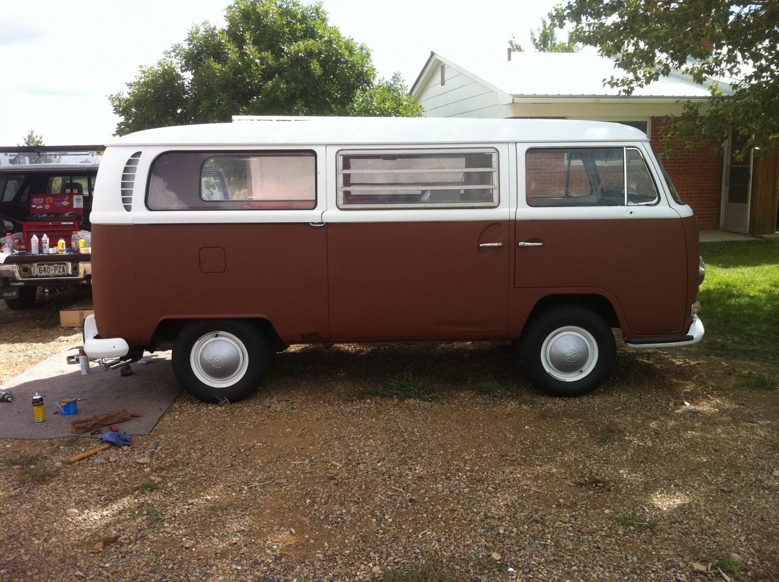

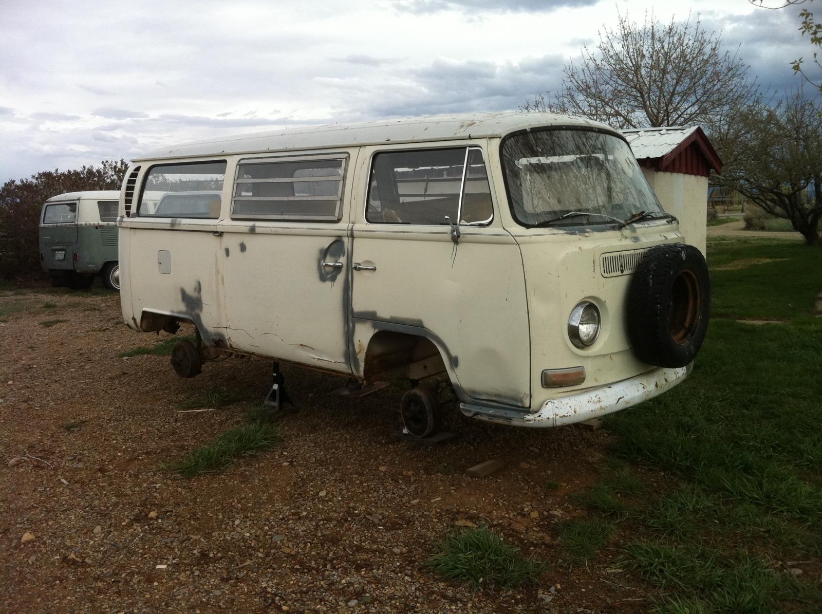

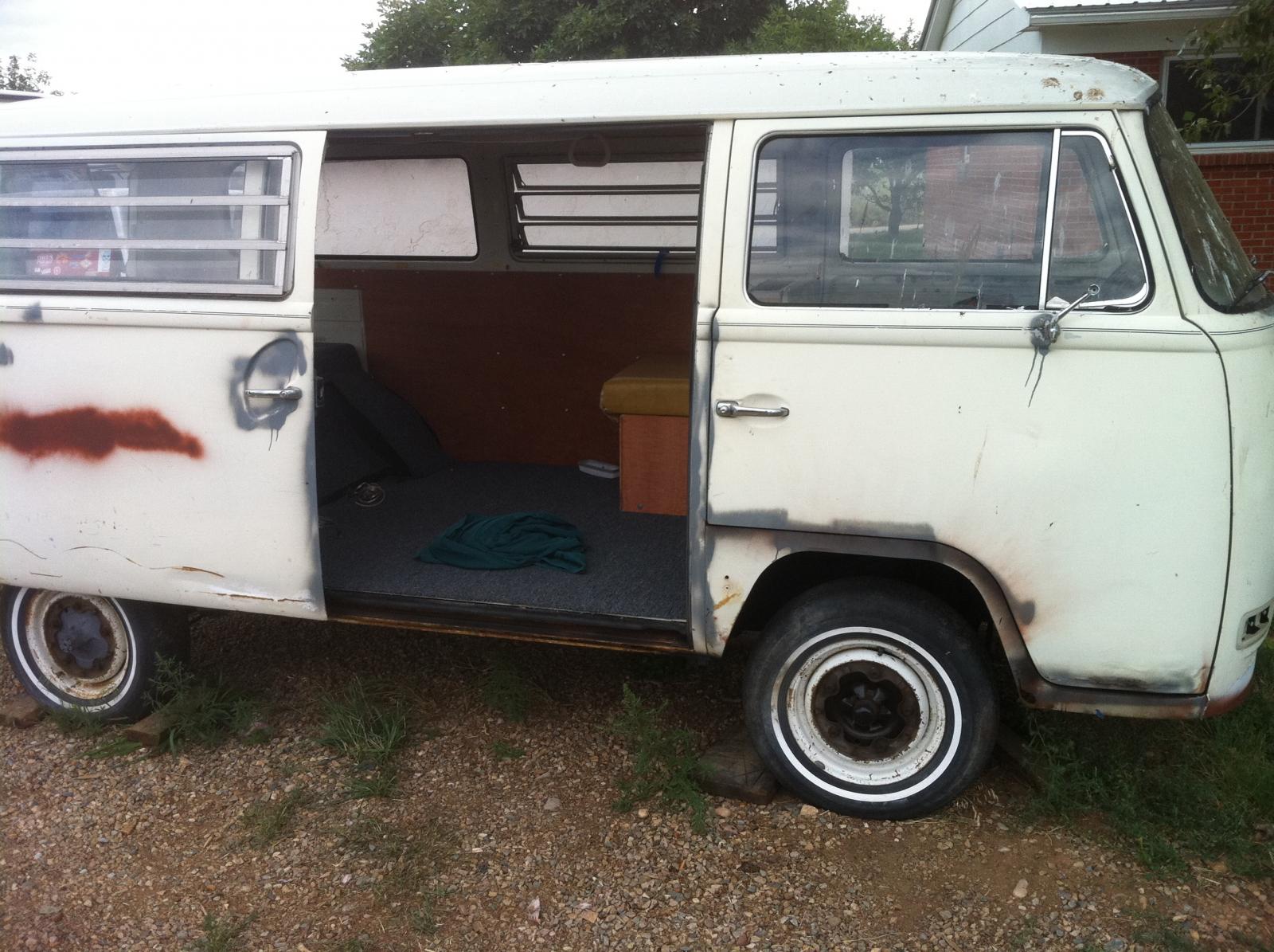

Ok, today I was hanging out with mtnbus talking about busses of coarse. He said I should start a thread on the rebuild/revive I did on my 68 westy. I have a new born and I'm up 24/7 these days so I decided I have the time so here goes.
I bought this bus in Tabernash, Co (just north of Winter Park) in 2010 for $200. Larry, the guy I got it from was the second owner and got it when he was 18. Bus had been sitting since 1998. Here is my attempt to show the revive in a bunch of pictures. Larry said back when he drove the bus his nick name was Bone and all his friends called his bus "The Bone Bus." Thanks for looking, I can answer any questions.

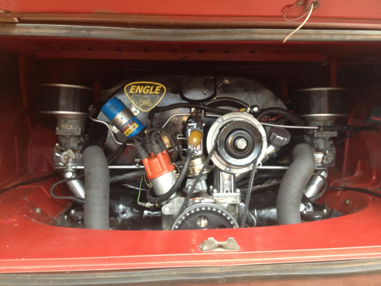

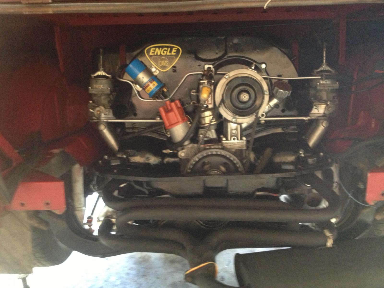

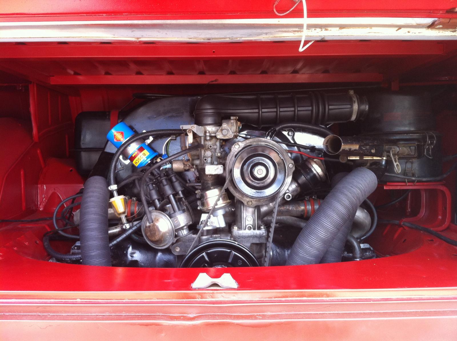

1600cc DP I bought from a member on this site. Good engine drove it for 2 years.

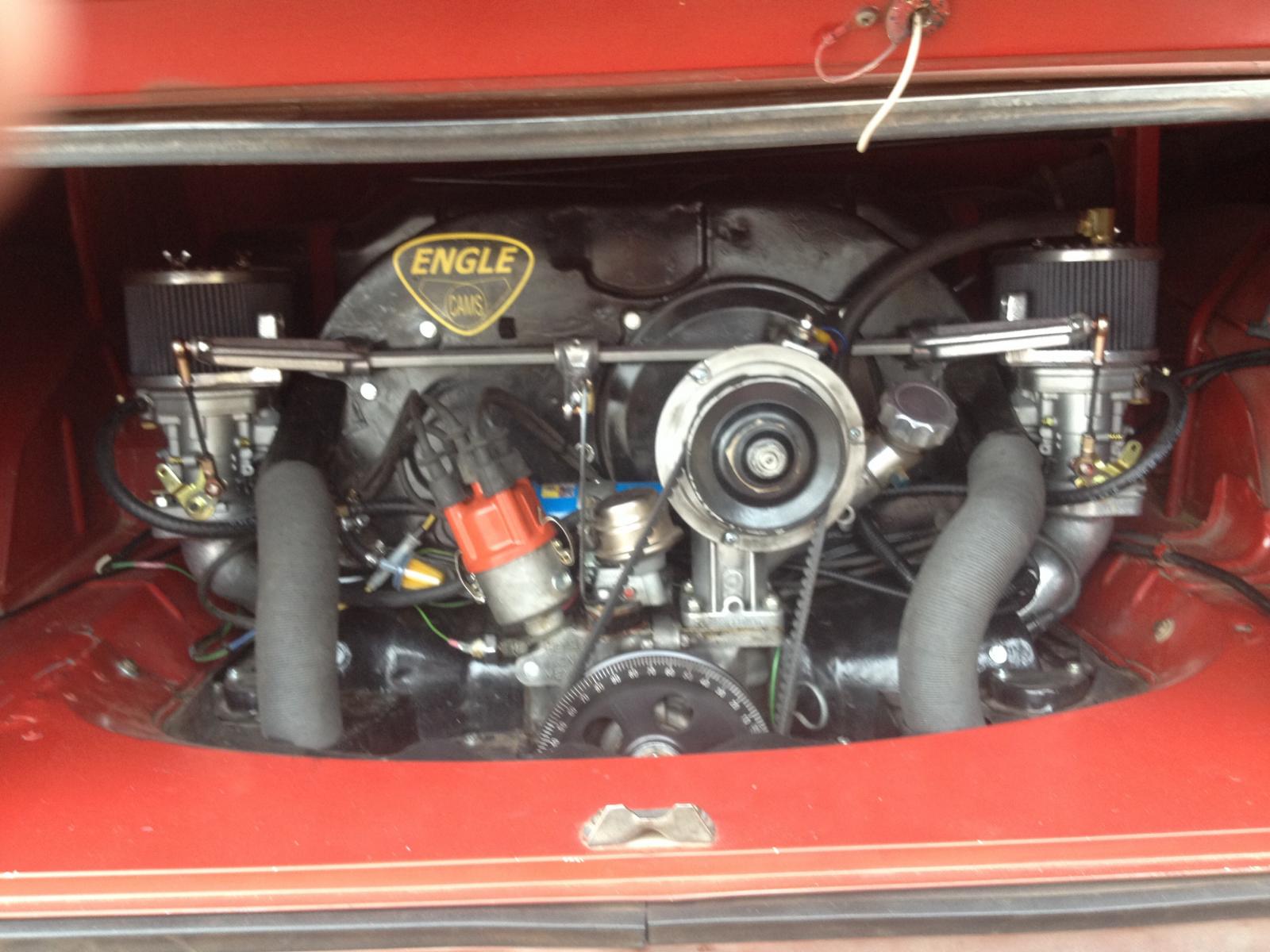

Just as I thought here it is 340 am and I'm up with the baby. Here is some more pics.
This is the material I had grandma make the curtains with

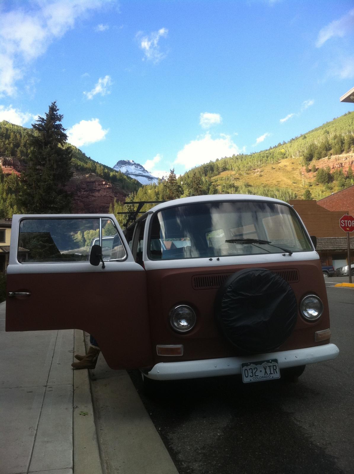

First trip in the bus on my birthday weekend. Blues and Brews festival in Telluride September 2011.

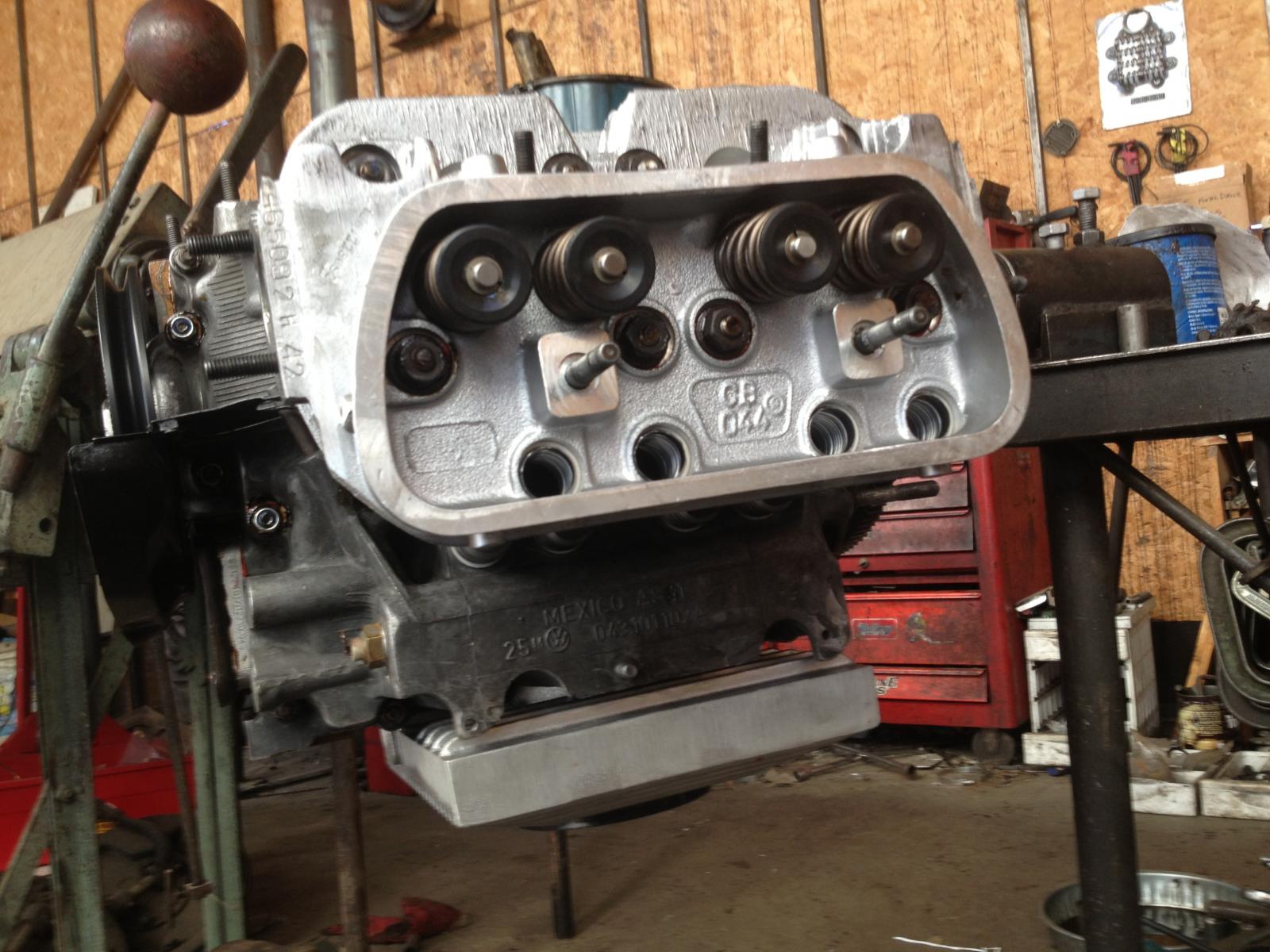

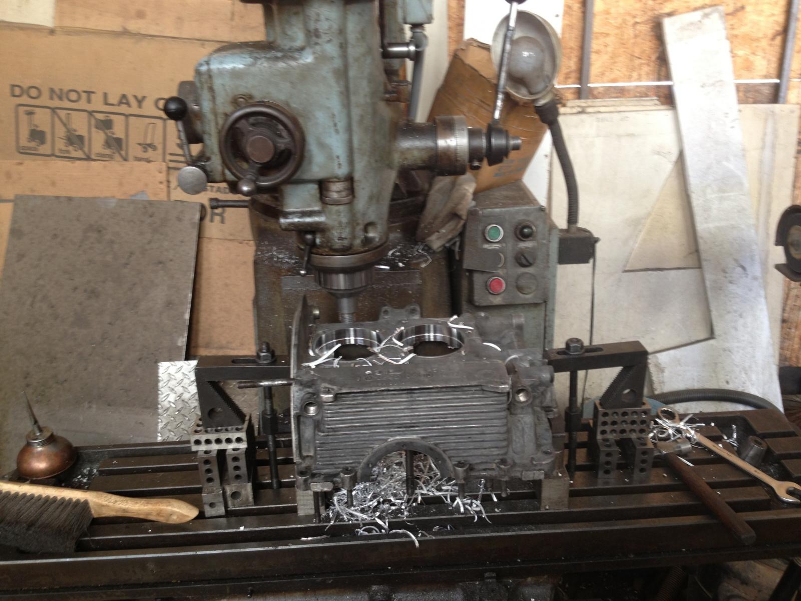

Start of 2109cc build

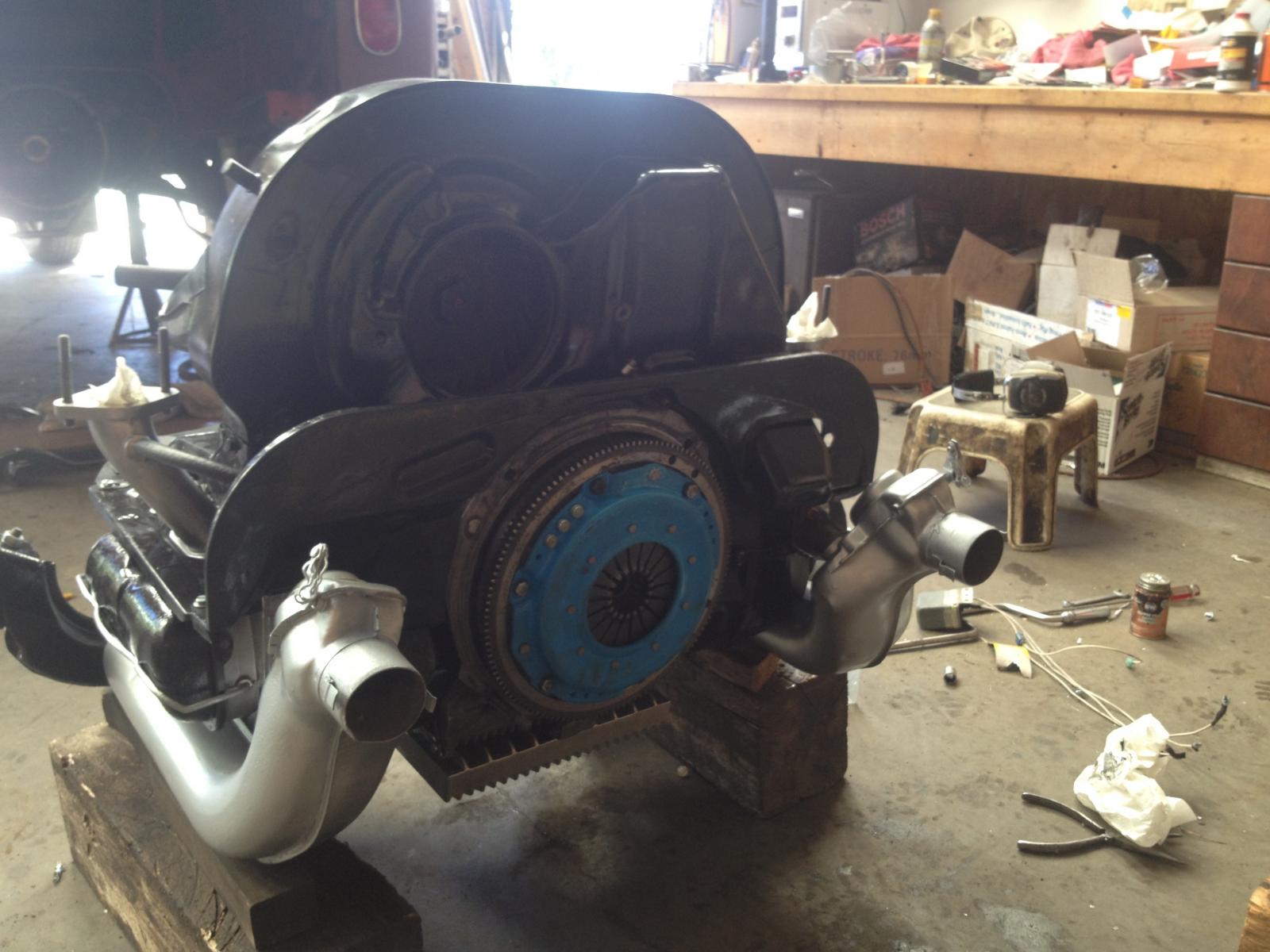

Installed 2109cc with dual Kadrons. Getting 21+ mpg at 7700'!

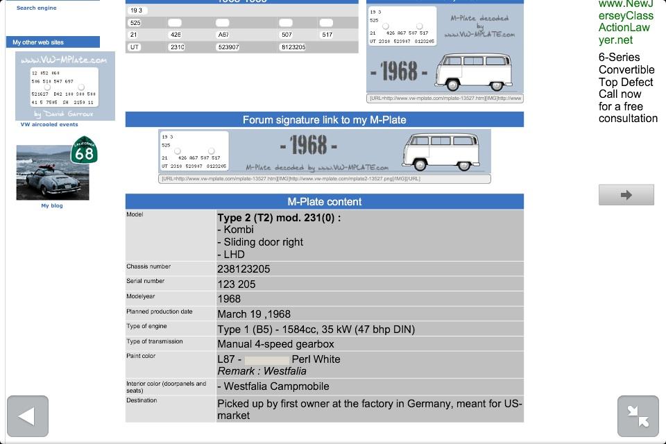

My M-Code
[/img]

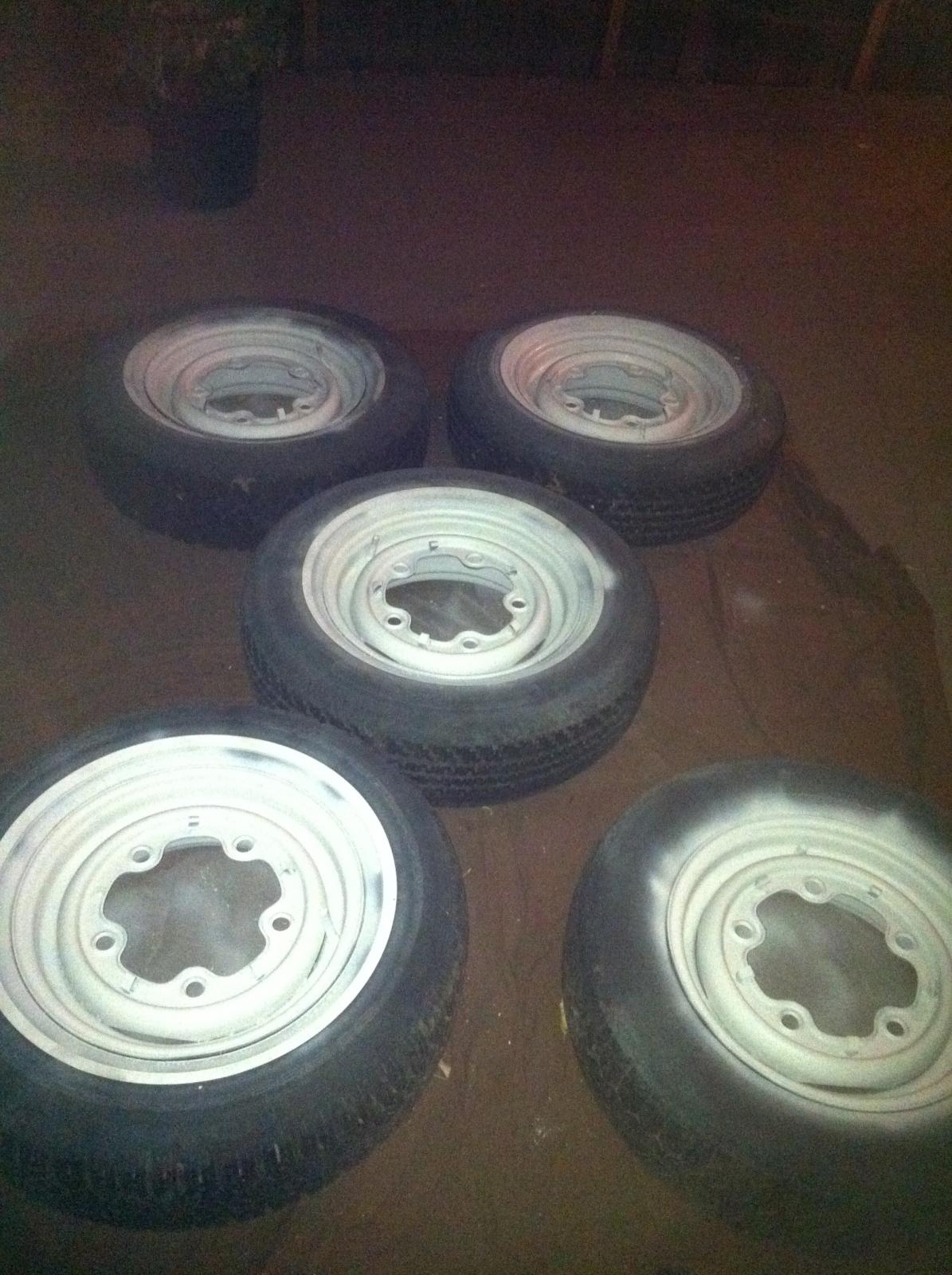

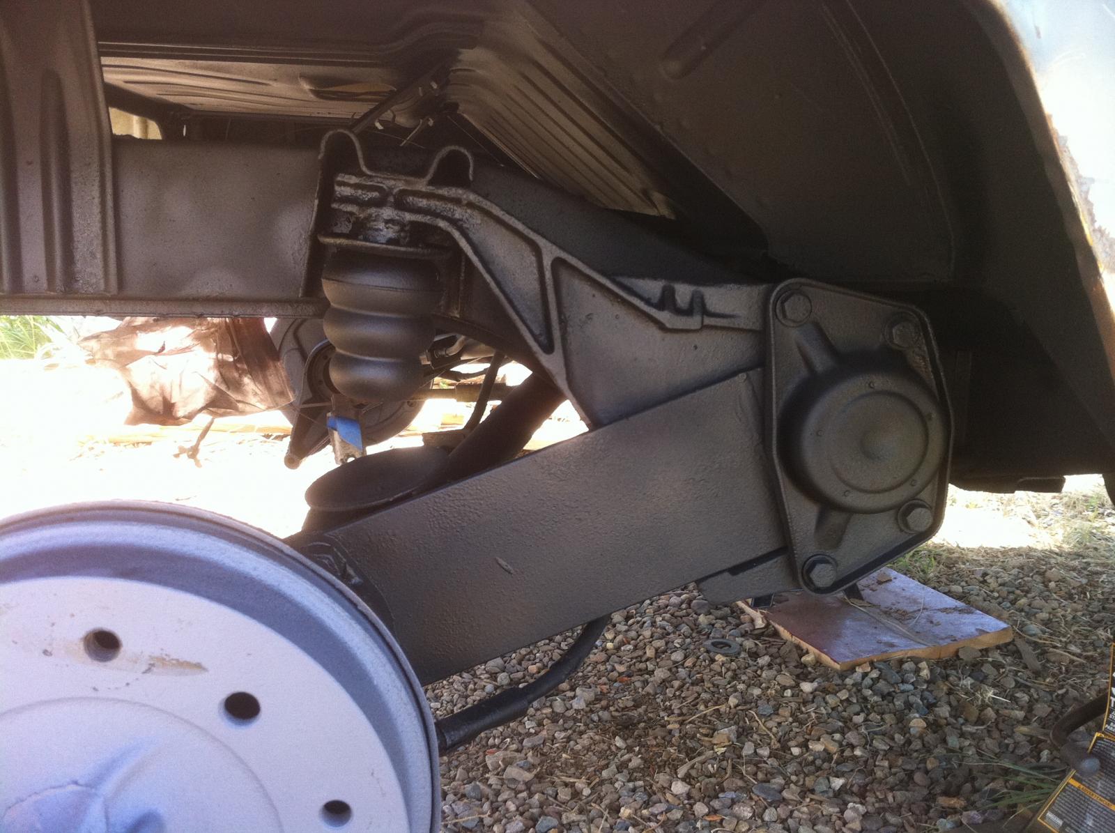

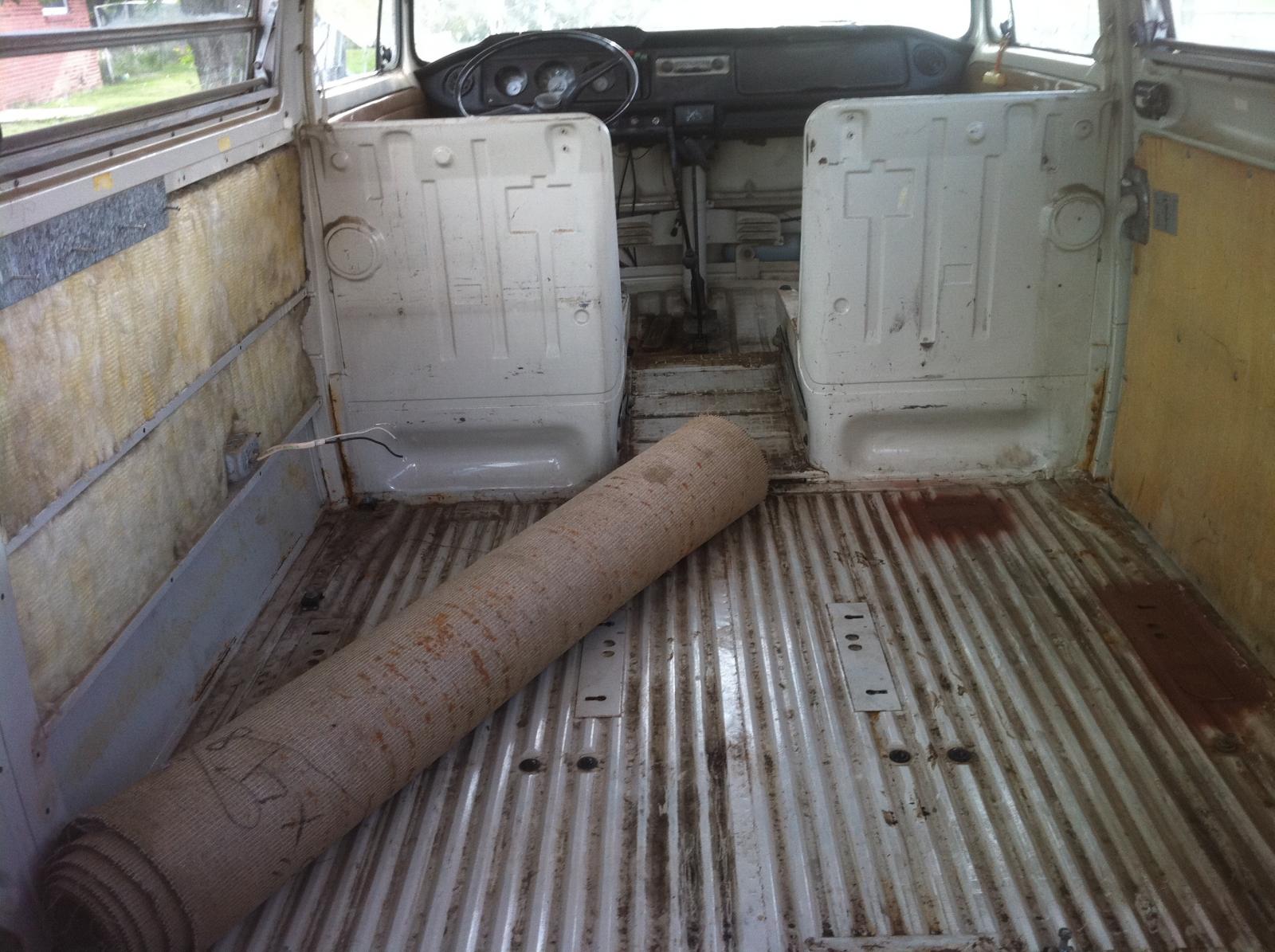

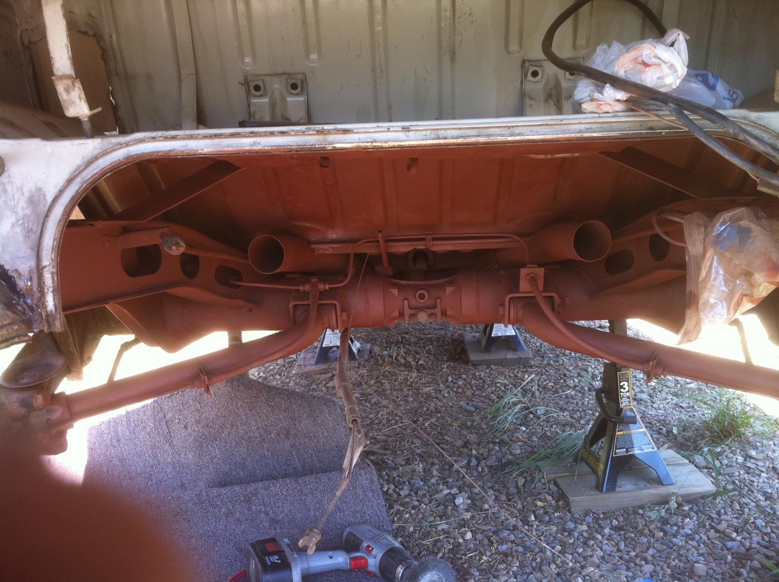

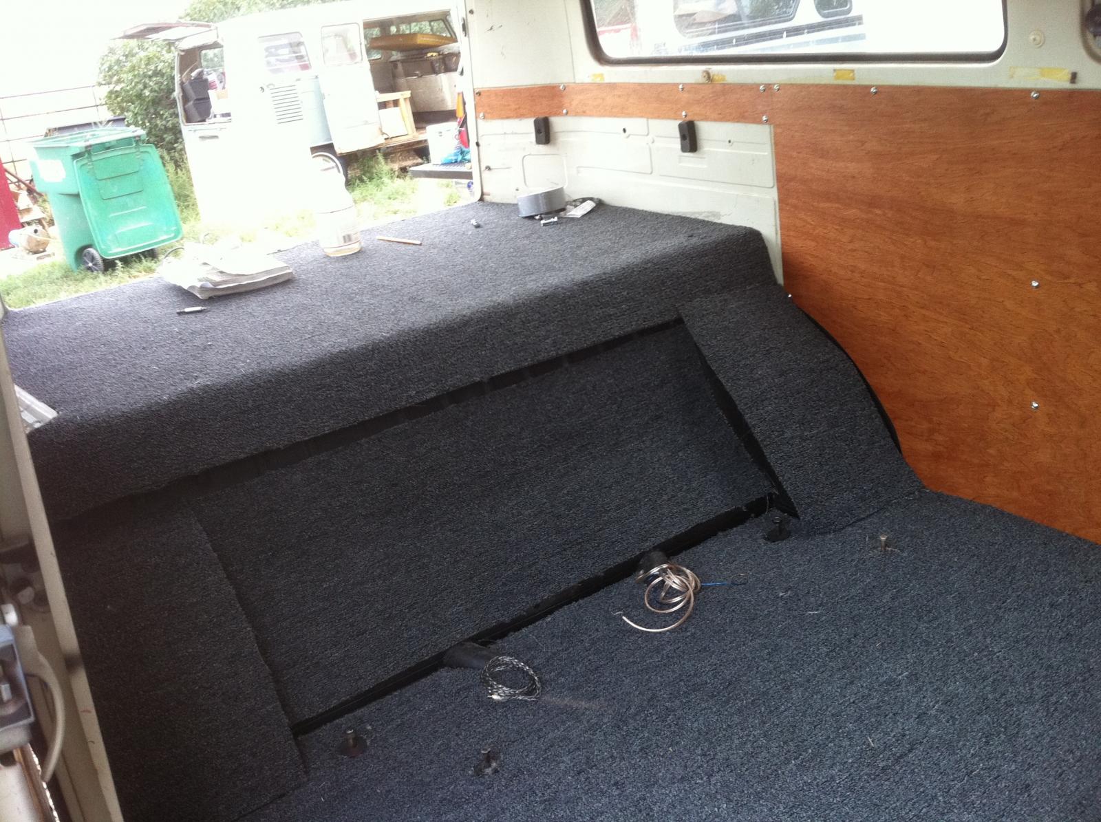

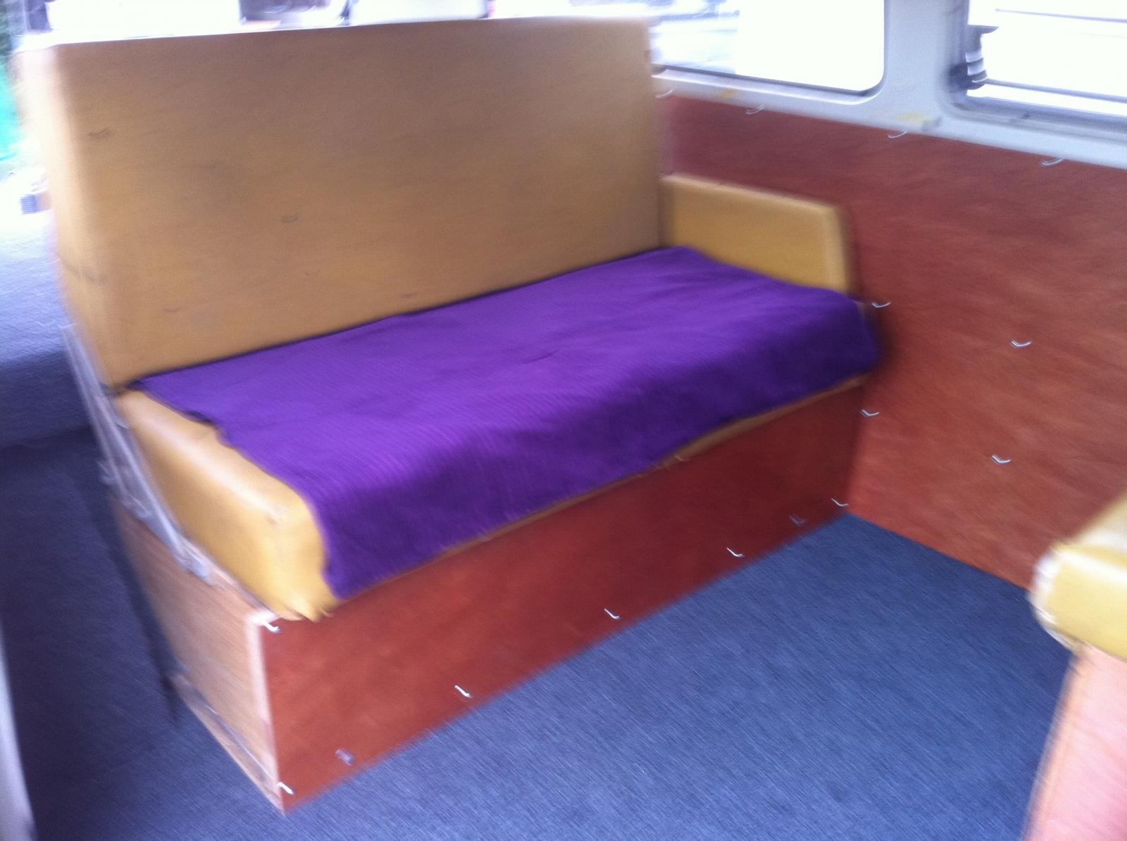

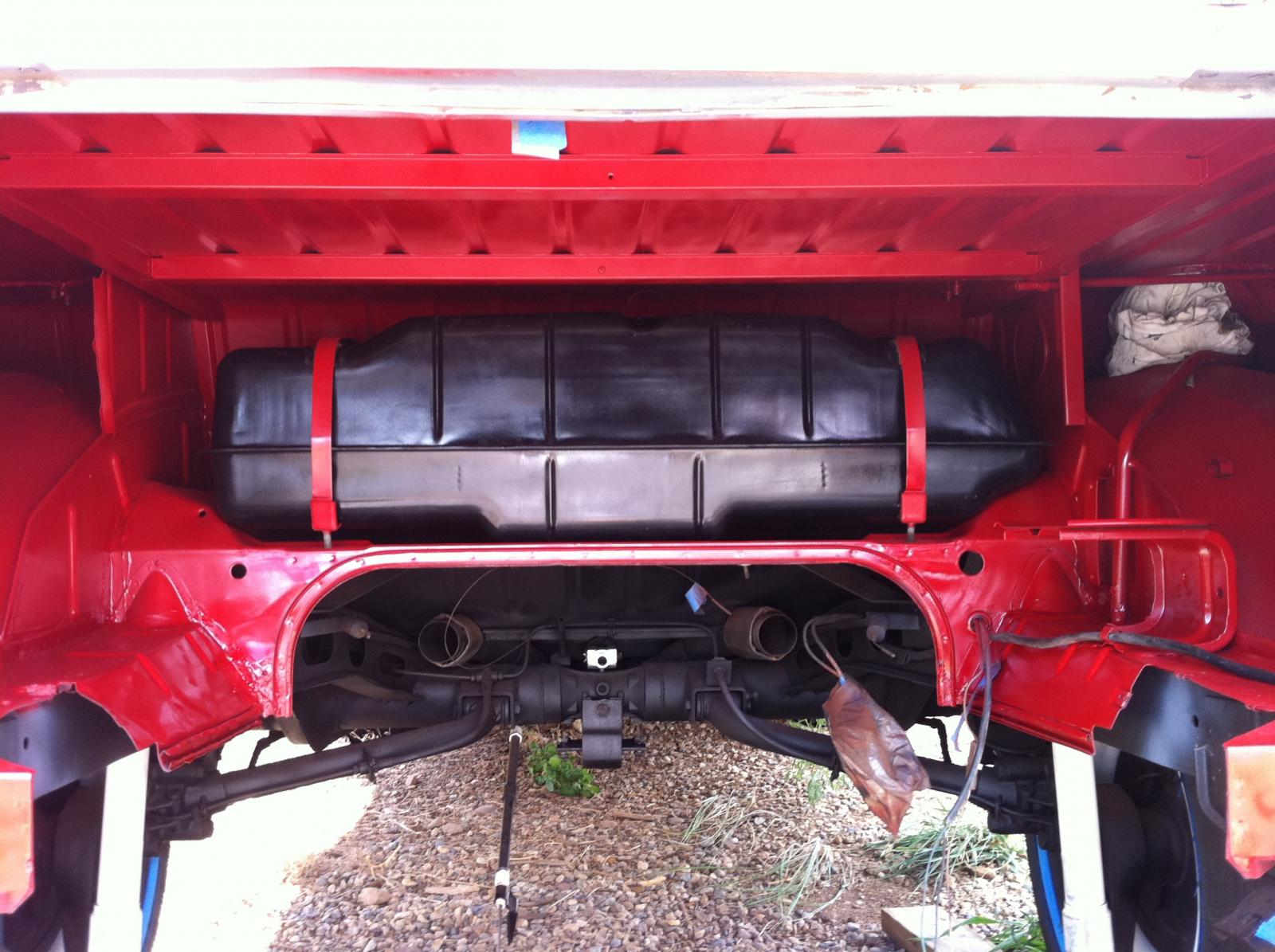

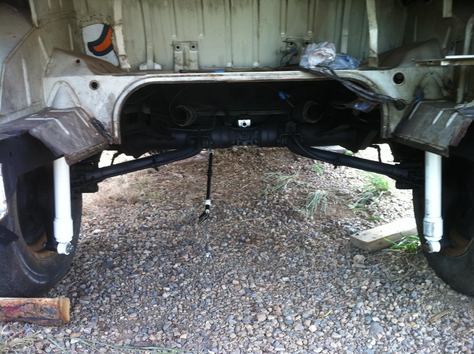

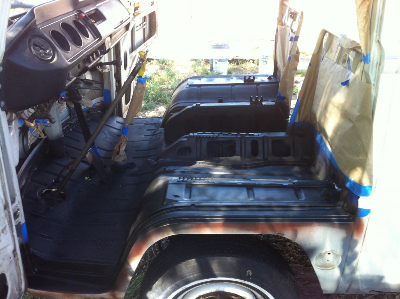

Man that was a lot of pics and I still have tons more but I will not bore you with those. I did all this work in the summer of 2011. Quick run down of what you see, sorry some are out of order.
I had the bus on jack stands for about 3 months. I gutted it, wire wheeled both sides of the pan, primed and used rustolum undercoating out of a spray can on both sides of pan. New shocks, steering dampener, ft brake pads, repack ft bearings, new rear wheel cylinders, rear pads and spring kit. Had to install new e-brake tubes (custom) and cables as well. New coupler, clutch cable and tires. I installed new rear bearings and adjusted the rear torsion. Installed a New windshield and seal. i Installed a new Kenwood deck with 6.5" rounds in the doors, 6x9s in boxes in the back along with a Kenwood 10" sub. It bumps!. I made all of the interior panels, stained and polyurethaned them. I'm running a 002 3 rib transaxle.
The first engine you see is a 1600cc DP. I put that in when I did this revive a drove it for 2 years. Good engine, leaked a little and was slow but it ran good. I just had that block and all the parts I could still use turned into the 2109cc you see. Great decision for me, tons of power at this high elevation and good mileage.
This bus has been my daily driver since I finished the build. I love it!!!

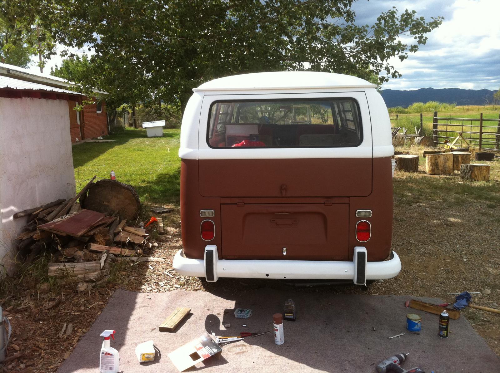

Thanks buddy, I spent a lot of time making this bus live again. I feel a ton of pride when I'm driving it.
This was and still is a Colorado bus. The pan is in great shape and the body is mostly strait. Although there are some rust areas that need attention, like the rockers.
I used rustoloum primer on the pan and rustoloum spray can undercoating over the primer.
Exterior is rustoloum primer as well. I'm sure one day I will have the body work done but its fine for now. I drive this bus everyday and camp in it a lot. I would be bummed if I spent a ton of money on the body and paint and it got pinstripes the first time we went camping.
Rims, hub caps and bumpers are also spray painted.

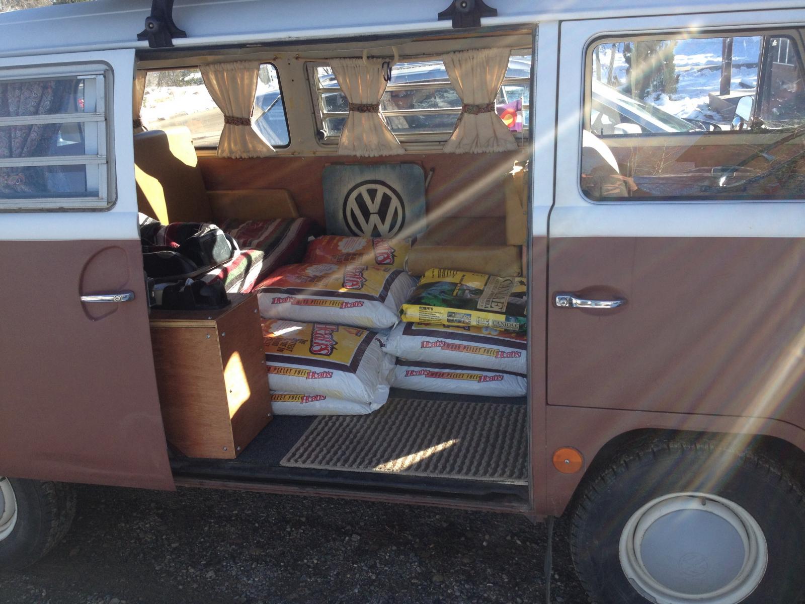

I know I have seen threads for what I'm posting in the past but I can't seem to find them. Here's the bone bus in my everyday life.
400lbs of pellets for the stove, child's play. There was a working with you bus thread I thought.

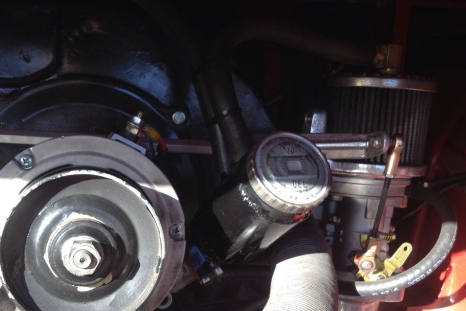

I picked up the Bone Bus today from my engine builder. I brought it back to him to last week to upgrade to Weber IDF 40s, from the Kadrons I was running. He installed Pertronix, a new throttle cable and rebuilt the linkage on the gas pedal.
It was about a 30 mile drive back game and the bus ran great! The engine ran real smooth, sounded throatier and didn't go over 180*. It was dark so I really didn't get on it at all, I was worried about the deer on the road.
I'm not stoked on where he put the fuel filter and that the fact fuse for the reverse lights is is right next tothe filter. I will be changing the location of both.
[img]
I didn't like how a lot of people run a big spring to the engine bay. So he made this bracket.
[/img]
I wanted the case to be vented more. So he is building me a new oil filler with two vents, I'll go back next week for that. [/img]
