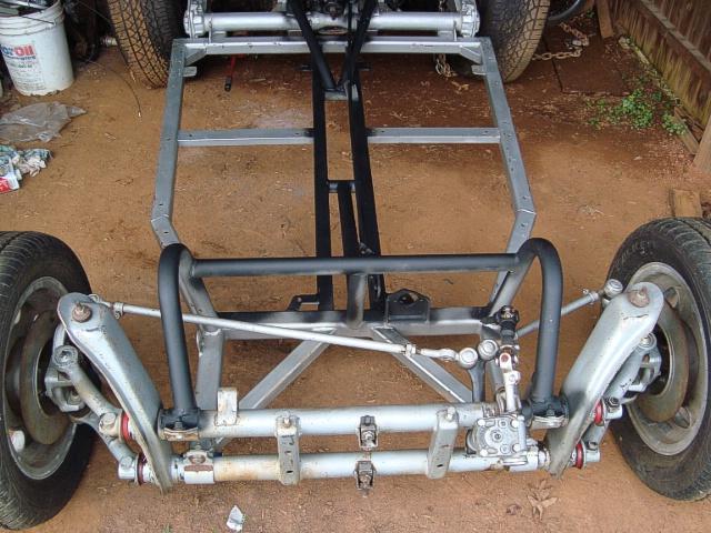

Starting point
"Dune Buggies and Watermelon Rock! .” (MOON BUGGY)

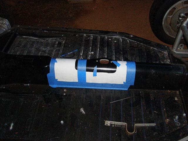

I purchased a Berrien buggy chassis and floor pan.
Decided to relocate the shifter back 5.5 inches.

What is the reason for moving the shifter back, for comfort, or are the seats moved back, or nature of building a buggy due to the shortened pan? Thanks.
70 Street Baja http://www.thesamba.com/vw/forum/viewtopic.php?t=566113
"Necessity is the mother of invention"
BL3Manx
Joined: August 29, 2006
Posts: 6768
Location: Northern California
BL3Manx is offline
PostPosted: Wed Sep 25, 2013 2:39 pm    Post subject: Reply with quote
It interferes less with your leg and "falls more readily to hand" (easier to reach). Buggy seats are usually lowered and a bit more reclined

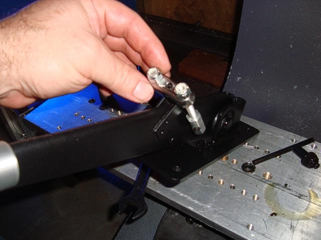

Took a different approach to the cut and weld method of shortening the handbrake.
I cut off 2.5 inch, machined a new handle and button out of some billet aluminum.
Also moved the mount back 4.00 inch on the Flore pan.

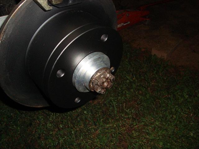

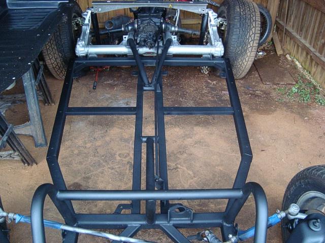

Had some type 3 rear brakes, the plan was to put them on the buggy.
Pulled the drums and rustmageddon.
Change of plans, disk breaks.
Decided to change the frame color to black.

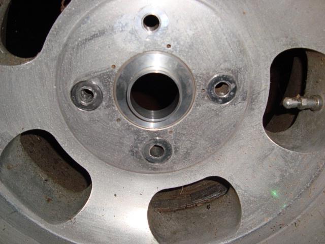

Machined some wheel centering hubs.
Makes mounting the tires easier.

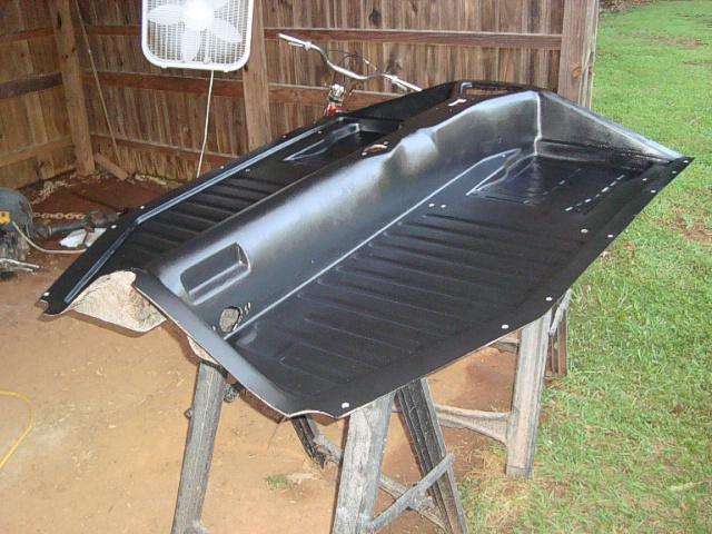

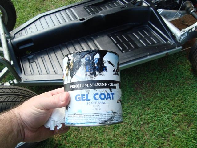

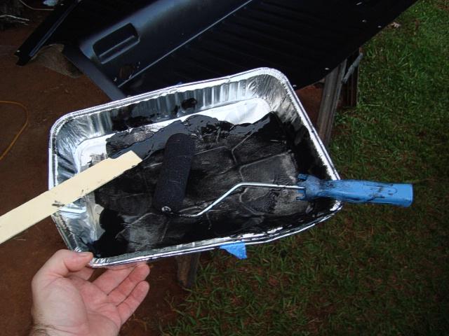

Adding bed liner to Flore pan.
Gel coat is showing scratches.

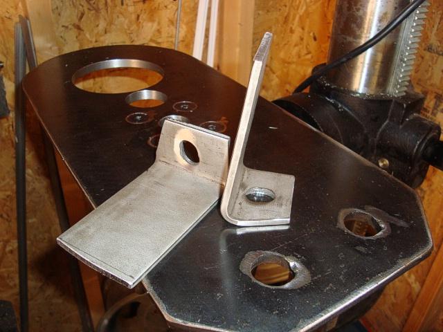

Battery box and lower show bar mounts.
Adjustable shift rod.
