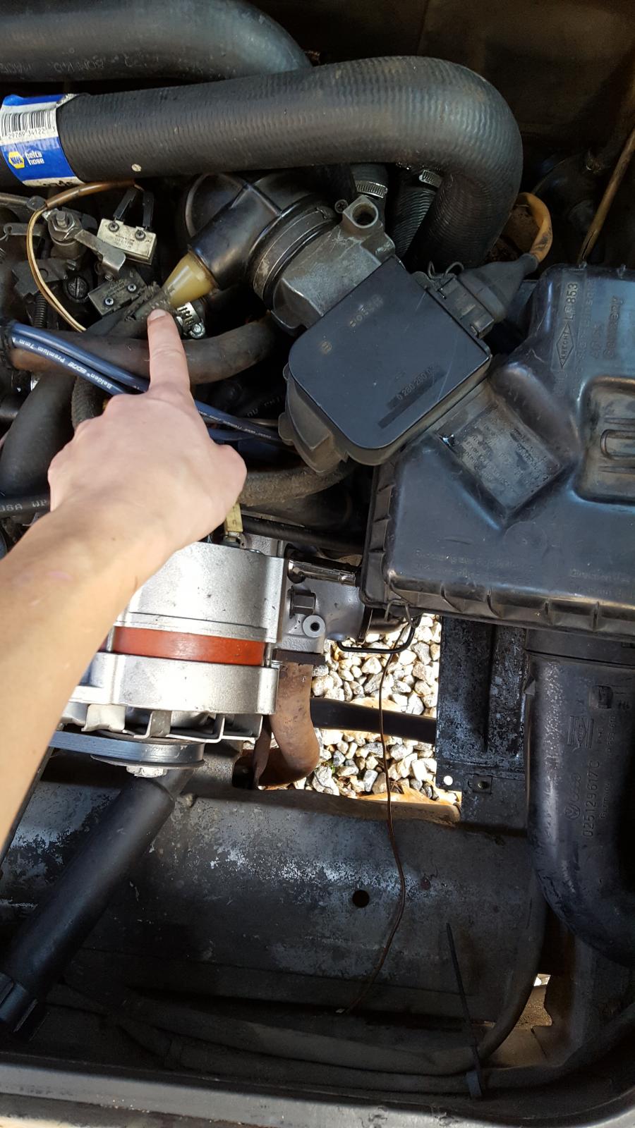

Found this hose , it goes through the rear frame member on the right side at the rear trailing arm. There is a grommet to prevent the hose from rubbing. I think it might be a vestige from the old motor prior to the engine conversion.

PostPosted: Mon Jul 29, 2013 7:53 am    Post subject: Reply with quote
That hard plastic elbow indicates that is a vent tube from the bottom of a charcoal canister.

PostPosted: Mon Jul 29, 2013 8:33 am    Post subject: Reply with quote
That is part of the fuel tank venting system........ Not the engine. Even if you had an engine swap, you still have the charcoal filter for venting. I'd reinstall it as it should be.

PostPosted: Mon Jul 29, 2013 8:45 am    Post subject: Reply with quote
The charcoal canister is missing. I had Stephan convert the engine, he may of relocated it.

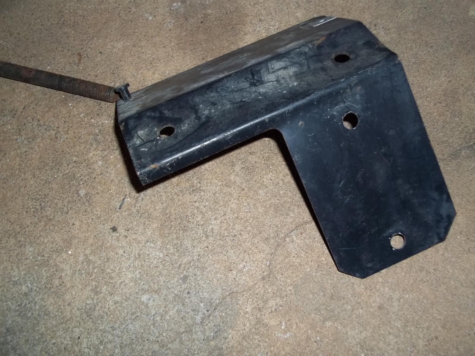

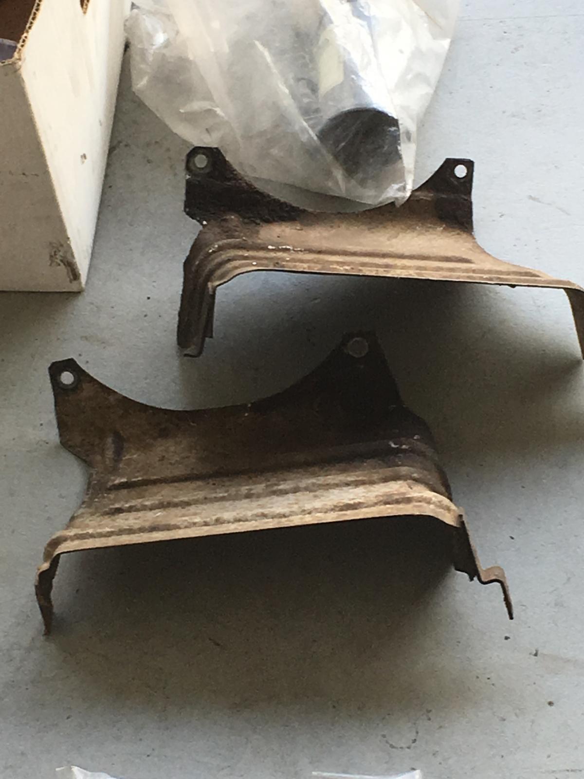

I found a box of parts and have identified some of them as MK IV VW stuff, and some Vanagon items. I have not identified these parts. Any ideas?
Part number listed on item as 06A103 500
No part number on part, there is a post on one corner.
oil pickup tube, but for what engine?
no part number
greebly

PostPosted: Wed Feb 11, 2015 6:34 pm    Post subject: Reply with quote
255-035-479 Looks like the base for the rear speaker pods on non A/C equipped vans.
255 843 188 There is a rubber bumper strip that covers the upper slider door track and that piece finishes off the rear of it. My non campers have it.

PostPosted: Wed Feb 11, 2015 6:40 pm    Post subject: Reply with quote
That's the bracket for the ECU/Fuel pump relay box

PostPosted: Thu Feb 12, 2015 2:05 pm    Post subject: Reply with quote
eeebee wrote:
another great call eeebee, thanks! You guys amaze me with your spatial recognition and memory. I was left with a box of parts after the conversion. I will post some of them on the karma thread once everything is identified.

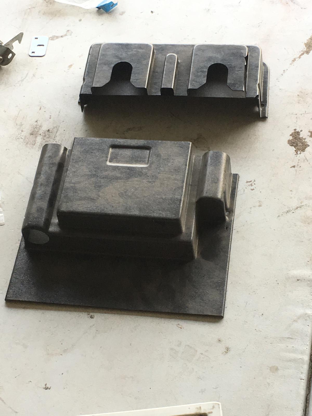

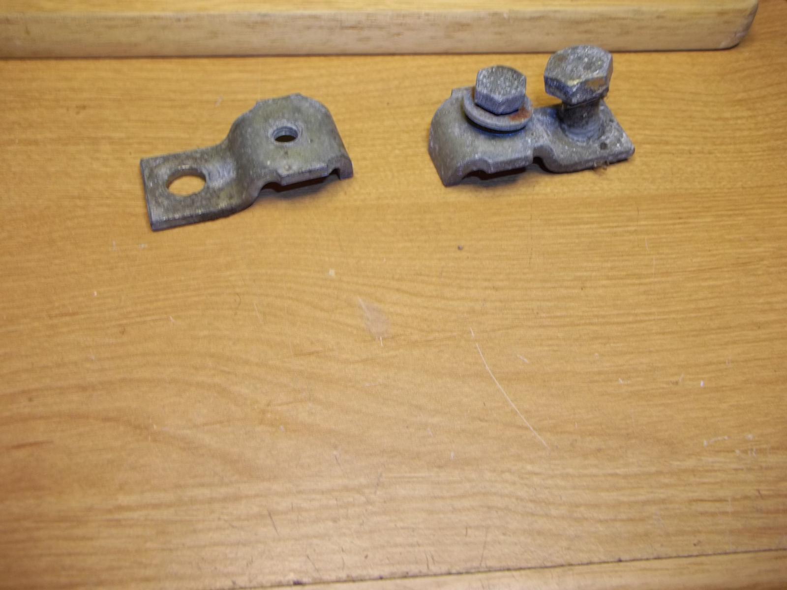

I found some clamps that I have no idea where they go. the look like retaining clamps for a cable?

PostPosted: Thu Feb 12, 2015 5:53 pm    Post subject: Reply with quote
Middle seat mount hardware.

PostPosted: Thu Feb 12, 2015 5:56 pm    Post subject: Reply with quote
I realized as soon as I read your post, yep, I have no middle seat, I removed the tracks. And the brackets must of been removed at the shop and thrown in the box. Thanks again.

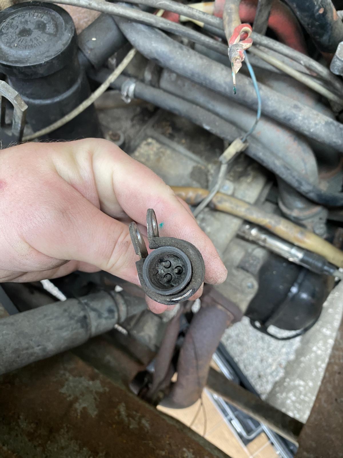

Found this while under my van tonight. It's a black box with an exposed nipple sticking out behind the spare tire carrier on the driver side.
What is this and is something supposed to be connected to it?

PostPosted: Mon Jun 15, 2015 9:13 pm    Post subject: Reply with quote
EGR / oxygen sensor mileage counter. 90.15 in the Bentley. Looks like your speedo cables bypass it now, which I believe is just fine. Others I am sure know more than I.

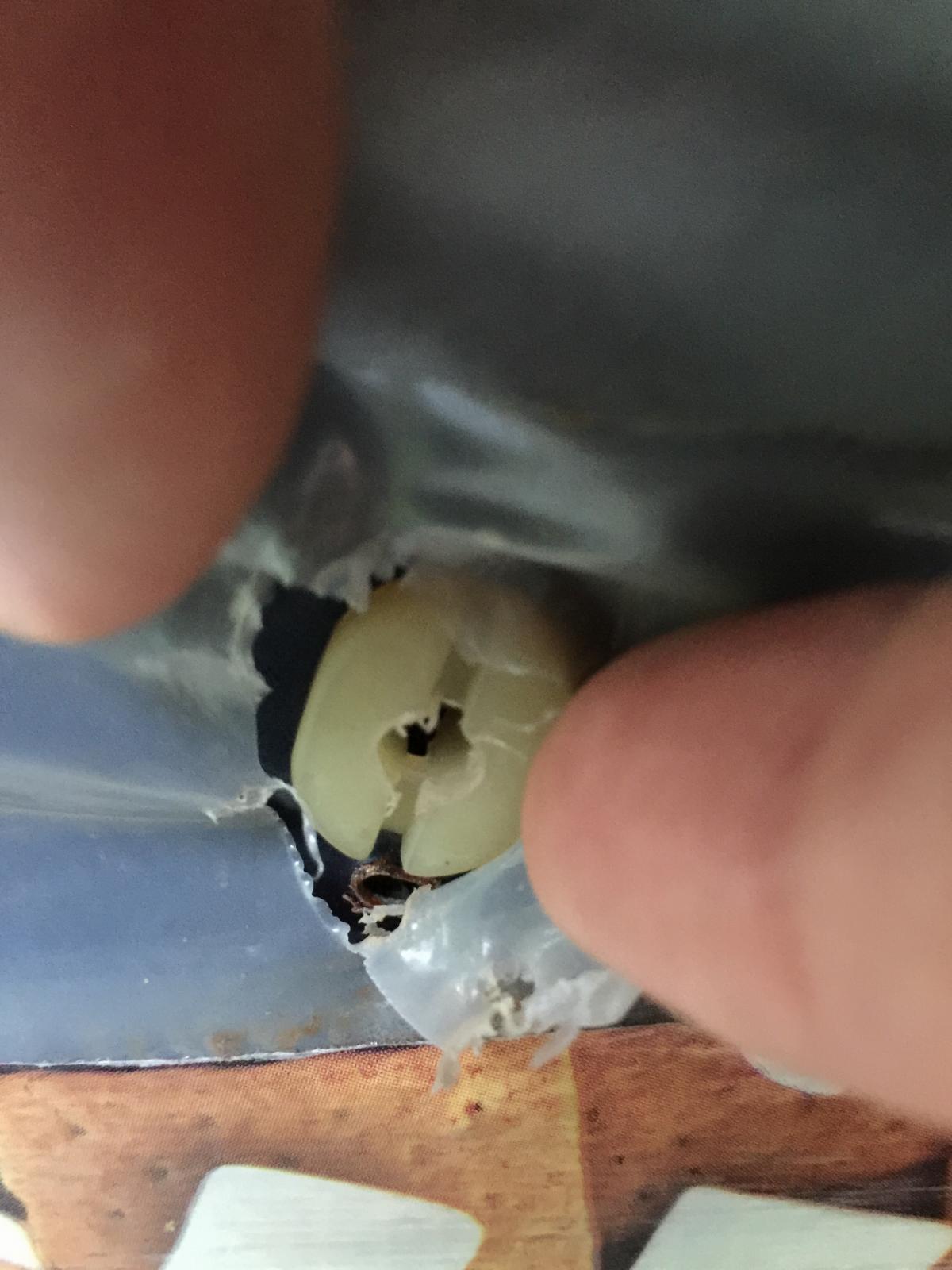

PostPosted: Tue Jun 16, 2015 6:54 am    Post subject: Silver hole/ring in dashboard next to air controls Reply with quote
I've seen this on a couple dashboards, but never really knew what it was for. Best guesses so far are an antenna for some reason, or a socket for a map light (thanks to detroitzoran on reddit), but I can't find a mention of that light anywhere.
