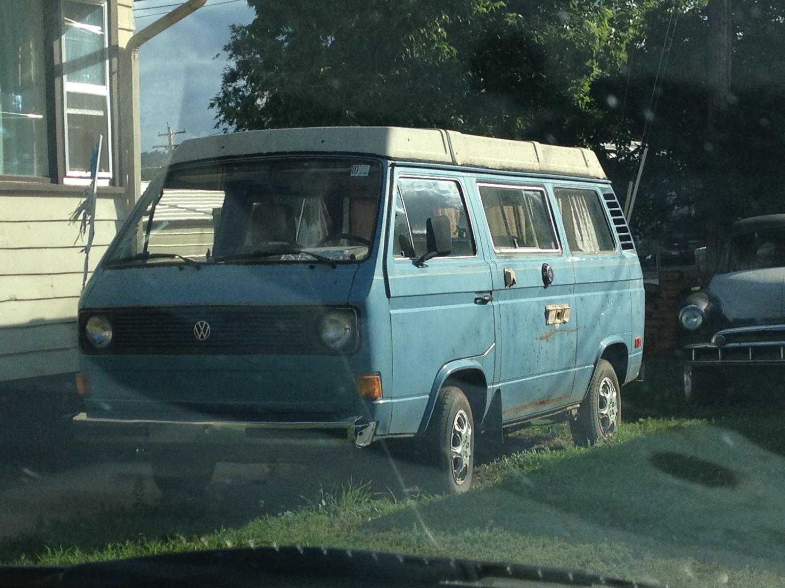

I just bought a 1980 vw vanagon westfalia and was referred to this forum. it has some problems, starting with the look I got when I towed it in the driveway, not running because of an engine fire, but there is hope when she realized no more tent. (sort of)

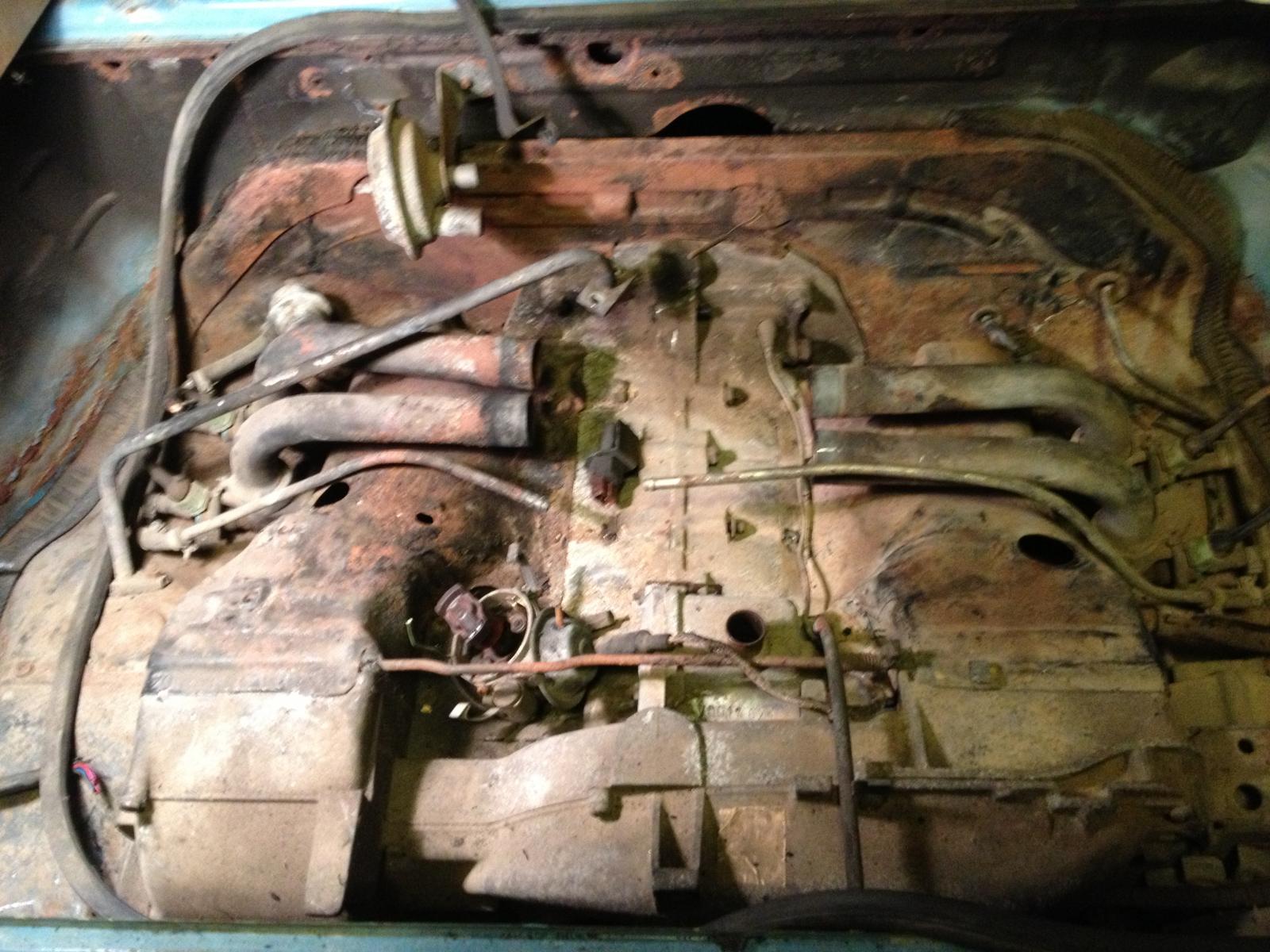

yes, moot, fire started from muffler shop torching off old muffler but probable original problem was leaking fuel line since the center of the fire was the cold start valve(?). the guy I bought it from thru in a Bentley vw manual that is really helpful and helped make the final sale.

Is the harness toast? IIRC, the ECU resides in the engine bay. Hopefully it didn't get toasted too.
The air cooled engine electrics aren't enormously complex. If the CSV is toast, depending on local climate, maybe delete? Is that part NLA? Or retro fit a CVS from a CIS or other engine management? I've read of guys wiring in a momentary switch to activate that part for starting only.
Electrical connectors for FI's etc, might be found on other VW's in a bone yard. As has been inferred, the later Bay buses use a 2.0 The Bay crowd will have tips and useful work arounds for any NLA parts.

harness is toast, I found a harness on the Karma board, if its still available, post is 3-4 yrs old. I cant pm anyone until I am a member for a day. don't know about the ecu, I know it wasn't in the fire, I have a before and after I cleaned it up pic if I can figure out how to post it.

You CAN do it. My 1981 after my fire looked the same.
After much cleaning, painting, replacing, and a few $$.
Good Luck.

Nice before/after shots guys.
The ratwell site Dan points has a page explaining the "double relay" and some speculation on that it may be possible to duplicate using standard relays etc.

It looks like the fire damage was mostly to the engine. The chemical in dry extinguishers is a base as opposed to an acid, but it is an extreme base and is as corrosive as an acid. You need to neutralize the base in addition to attacking the rust and paint in the engine compartment.
