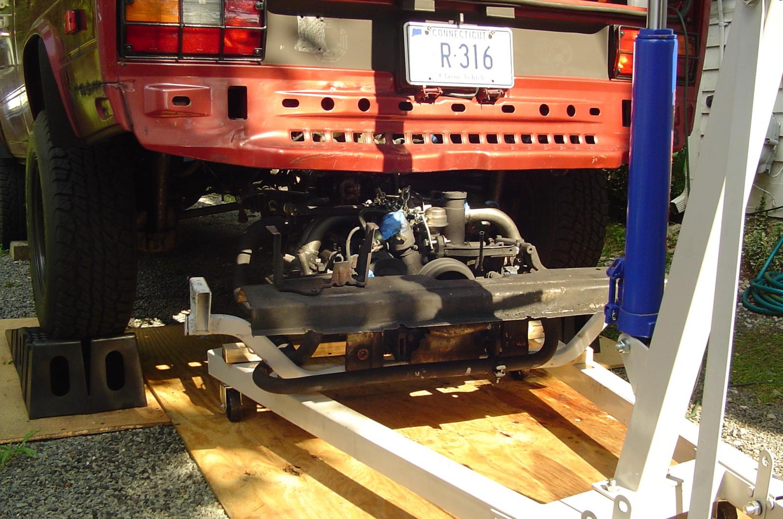

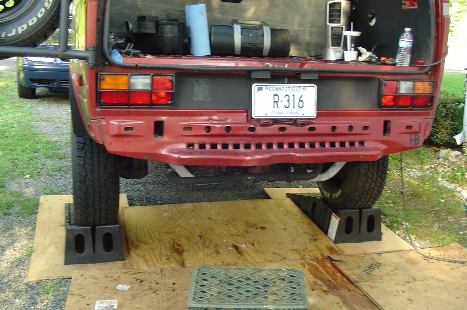

Just thought I post a few photos of what I did today. I finally installed this used 2.2 wxb I bought from Surfy Murfy about a year ago (who is a very cool dude). I used a cherry picker I got from AZ a coupe of years ago. One 4x8 sheet of plywood under the engine/trans, & two 2x4 sheets under the AZ ramps. I also had a couple of 2by2's that I used to set the engine on the legs of the crane. I rolled it under & re-grabbed the chain. A little wiggling & I got it in. The 2x2's also come in handy to leverage the engine in when mating it to the trans.
My biggest problem was the heat. In the 90's & the humidity around 80%
I'm done with bolting it up. Tomorrow I'll hook it all up & hopefully off to cape cod for a week tomorrow night.

Thanks. Regarding those ramps, they will fail on a gravel driveway (crack & break). You must put some wood under them. HF sells the metal ones, but they were all out, so I settled for the AZ plastic ones.

thanks. Yes for sure. I see what you mean. I likely would've put them on
plywood as you did. They might also shift once loaded up.
I have some spare lumber so will likely make wood ramps.

That's what I originally wanted to build, but went with an engine crane instead as I'm pressed for time right now. My DW is also slopped too. Enough that a pair of jackstands will tilt over.
Doug/Dave, good catch. It was a dual carb engine. Here's a photo of the actual engine when it had a pair of Weber's on the aircooled.net site. I can't find the build thread though from Surfy.

I just wanted to warn some folks out there. I should also mention that the plywood I got for my ramps is too thin. They are conforming to the ground & not flat on the top. Because of this, one of my ramps is swelling on the side. Not bad, but enough for me to notice it.
If you need to do this, get 3/4" plywood min.

I pulled my WBX with a shop crane, but need the gantry in order to be able to crawl around under the engine while mocking up/welding the crossbar

doing the same thing out here, ramps and my neighbors gravel driveway. I automatically placed the ramps on plywood, but good to know they are unsafe on just the gravel.

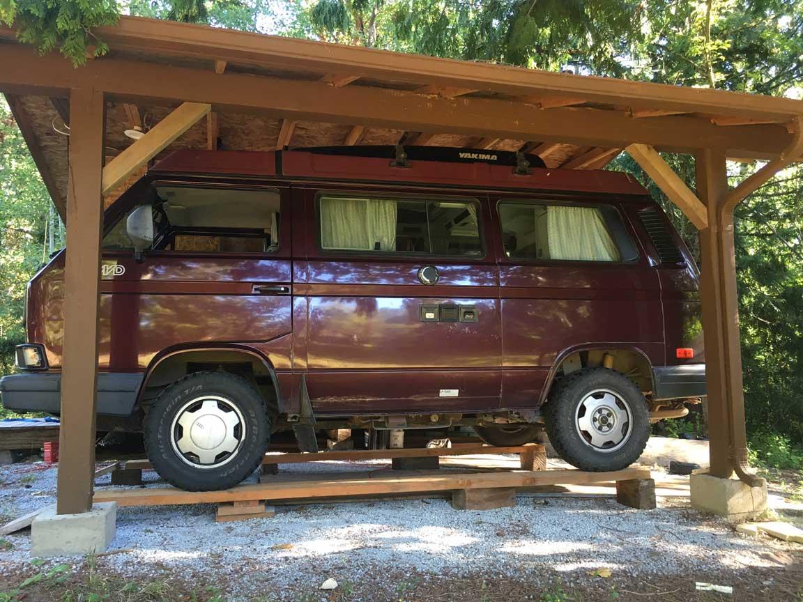

I'm working on plywood too. Level ramp for the van slightly raised has been a big help. A pair of 4x10 - 10ft would do well. Cost ~ $40 each new (?) possibly can be scrounged by some folks. Or 2X10s doubled.
This has been a great addition to my work area and was pretty easy. My boards are 2.25" x 10" doug fir (11 ft long). I've since added stops at the rears so it can't roll off the board. Someone might conclude that I'me geared up for spending too much time under the van....
