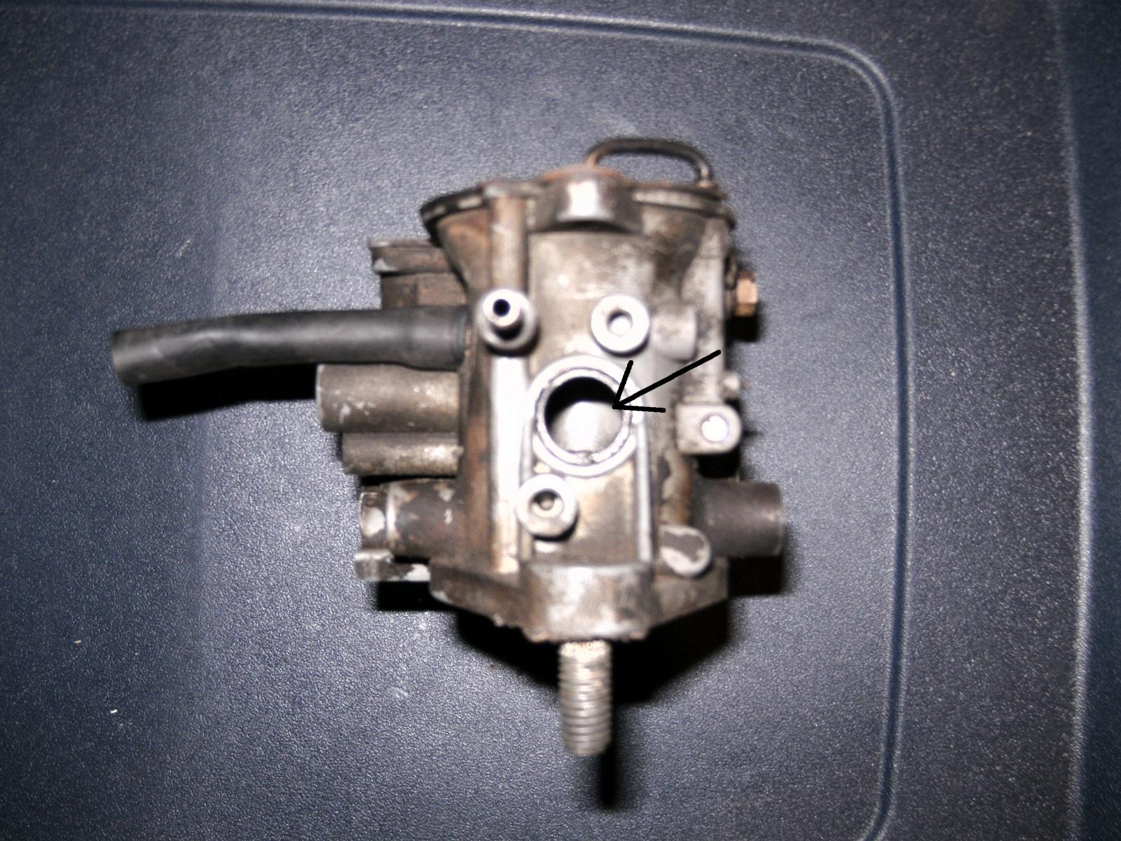

I just removed the venturi and wanted to post how I did it to.
1-Remove the air horn or whatever vw people call the top of the carb that covers the fuel bowl.
2-Remove the throttle shaft. Hit the shaft with a little heat if reasonable force does not loosen the plate screws. Remove plate first and then take off one or both nuts on throttle shaft and slide it out.
3-Remove plug that keeps venturi from sliding down. I used a piece of a wood broom handle that was about 4 inches long and placed that inside the venturi. I then placed a very small piece of wood on the plug/pin its self and used a screwdriver in between the two pieces of wood to pry the plug/pin out. Wrapping the screwdriver blade end with electrical tape or nothing at all would work too. It came out easy and actually flew across the room.
4-Remove venturi. I used a wooden dowel ;like the broom handle, and used that as a punch/drift on the venturi. The venturi does not have a lot of surface so angle the dowel pin on an angle so your putting force to the side as well as down. I heated mine up but I think it was stuck because of carbon. I had to give it a few solid taps with a medium ball peen hammer.
Here is a picture of the plug/pin removed. [img]http://www.thesamba.com/vw/forum/album_page.php?pic_id=1100506[/img]

Well done. The wooden dowel doesn't leave marks.
