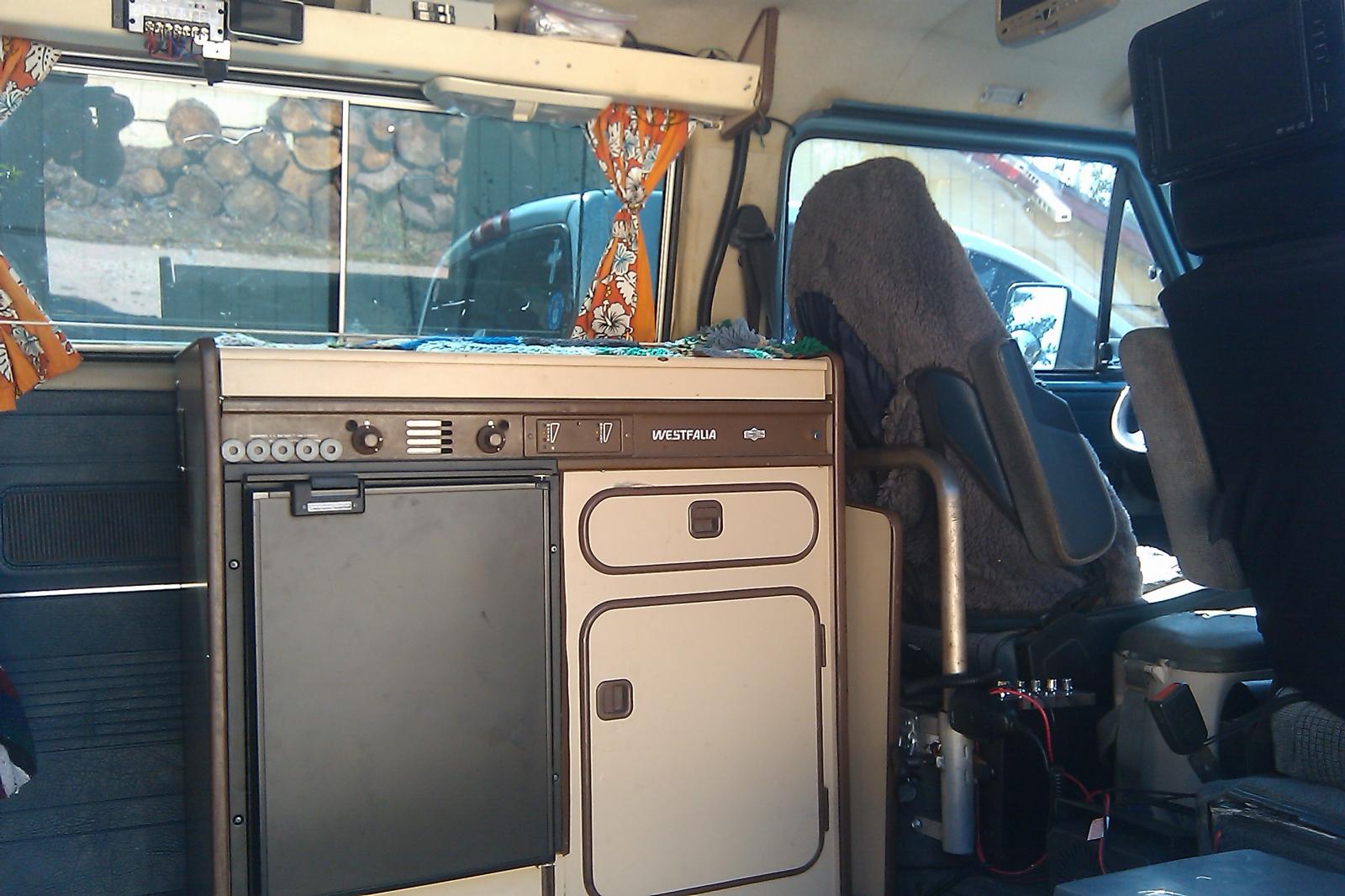

I picked up an Edgestar 45Qt about a month ago that sits right behind the passenger seat. Took the old fridge out and using that for dry food storage. I thought I may miss the space that the floor model takes up, but just got back from a 3 week tour with my wife and son, and didn't really miss it. Makes for a good seat or a foot rest when you have the passenger seat turned around.

I have it both ways. Isotherm CR49 in place of stock fridge and for extended stays I bring the Engel MT45 that, as others have said, fits very well behind the passenger seat and acts as a seat, table, footrest, etc. My solar panel set up keeps up with power demand as long as sun is shining. Family of four plus friends that usually come along with their own vehicles. The Engel MT45 was a great find, used, here in the classifieds. I could not resist.
