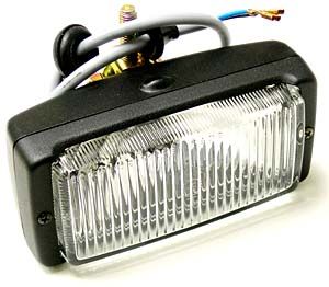

The PZ foglight have been unavailable for a few years now. I have seen a couple of used sets come up every now and then for $$$, some of which have cracked or starred lenses. I am trying to track down a source for replacement lenses, either OEM Hella or another of similar dimensions. I have emailed Projekt Zwo and received this response:
Dear Mr. Otiswesty,
Thank you for your enquiry.
The fog lights for the Vanagon Type II T3 are
unfortunately not available any more.
Our supplier Hella does not produce them any more.
It has been Hella number 1NB 119 916-007.
Kind regards
projektzwo GmbH&Co.KG
Gabriele Schuster
Anyone with info on these lights or if you know of a vehicle that used the same foglight, post it up here! Applause

When I looked into it for the lights I had I found Hella doesn't make them anymore either. Have you checked Ebay or Van Cafe who used to sell them?

Just the Hella fog light not the black housing. The light was a special shallow sealed lamp that is no longer made.

the lights were supposed to be same as a early merc , the nearest lights available now as the hella ones are no longer available are made by ring in the uk

I am pondering making a mold and making some, problem is finding a shallow light to go in.
These have long been out of production. They were simple ABS plastic probably vacuum formed.

thats what the ottienger lights do they are smaller in size but loads deeper so you have to cut bodywork , but replacements are harder to find than the projekt zwo ones

No need to cut the body. Better to cut the bulbholder's lens off of the rear reflector part and use an adhesive to attach a new lens from a different light with a similar lens shape.
The question is then, which light to use that has a similarly shaped lens?

Sorry I haven't had a chance to check into this yet. Here are my notes so far...
The biggest problem with the Hella lights that Projektzwo used are - they actually touch the back of the plastic housing and the housing is sandwiched right up close to the front of the Vanagon trapping in heat. This causes the plastic on the housing to get all heat distorted - not the optimum set up.
The other bummer is that the plastic housing is used as the back cover for the lights and this really doesn't seal all that well. It is very, very limited for adjusting up, down or in any direction. You basically mount up the housings with the lights in and go. Best scenario would be to have the lights solidly mounted like my PIAAs bolted to something metal and have the plastic housing just go over and around the light instead of being a mount for the light.
The Hella lights used are less then stellar in actual light output due the old design. Of course, I don't have a lighting problem on the front... Smile But, I would like to upgrade or make better fog lights. HIDs would be awesome.
Someone should get a mold made of these old Projectzwo housings and re-design with new style of lighting in mind.
You can see in this photo the plastic is wavy due to overheating by the Hella bulb.

Possibly a Porsche 944 fog light [think OE fog lights] might fit in this location space ? or the housing can be re-designed to fit around these. The good part about the Porsche 944 fog lights, they have build-in adjusters. Although, they might be too big. I've owned two Porsche 944s... hmmm, I'll have to dig into this more too.
