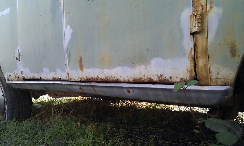

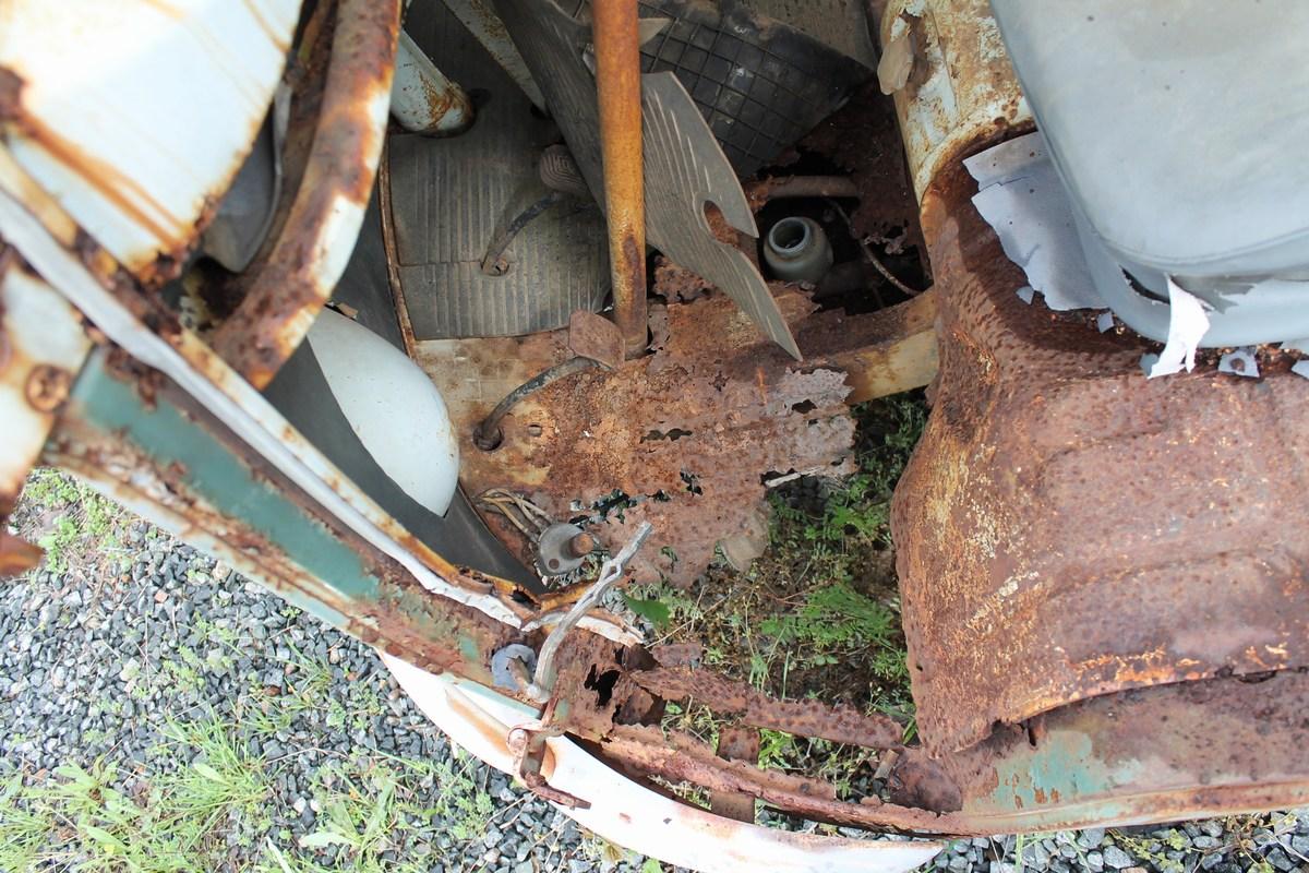

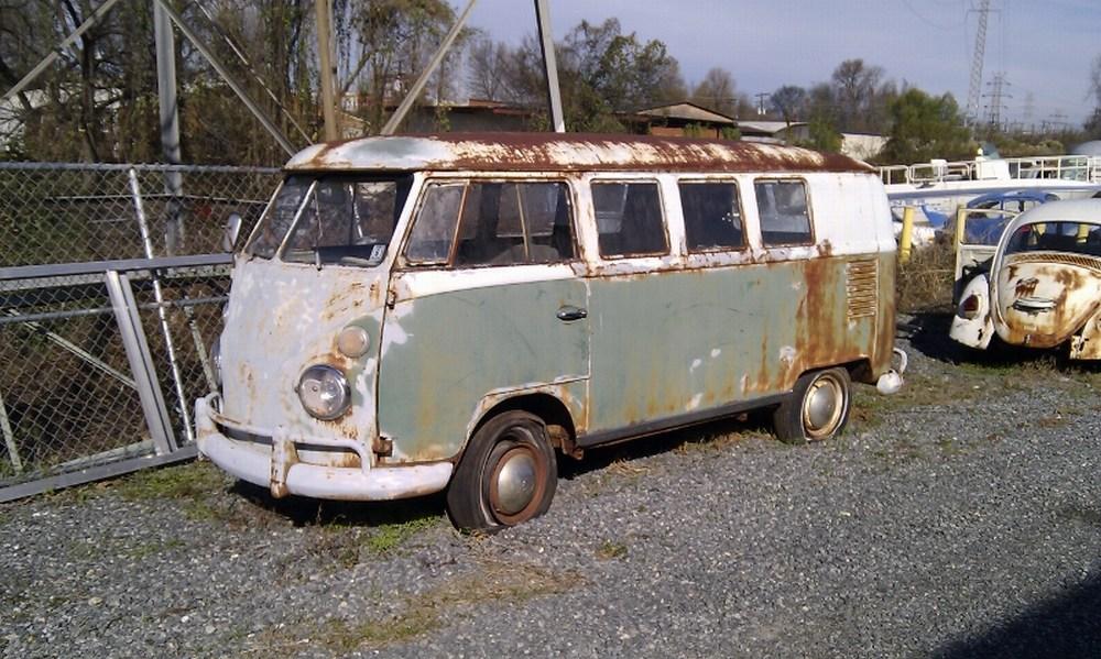

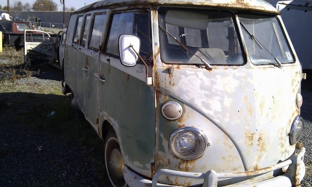

Where to start with Green Mountain rust bus? Well obviously its really rusty and just begs for help. This sweet ride was found in Lake Toxaway North Carolina by a close good friend and former coworker a few years ago and has been sitting in Charlotte waiting patiently for much needed help.
I will be honest I have tried to talk him out of fixing it more then once but he like so many vdub owners is crazy!! I mean that in the nicest way possible Very Happy . Lucky for him I am one of those crazy vdub guys. So here we go on what I know will be a long and headache filled project.
Some shots from where it sat waiting patiently.

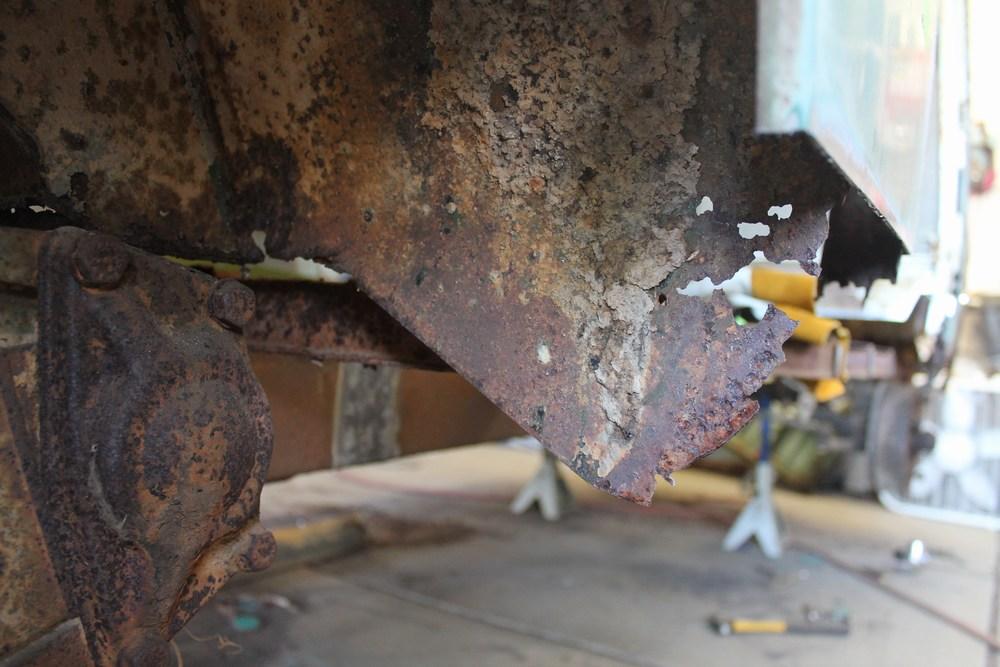

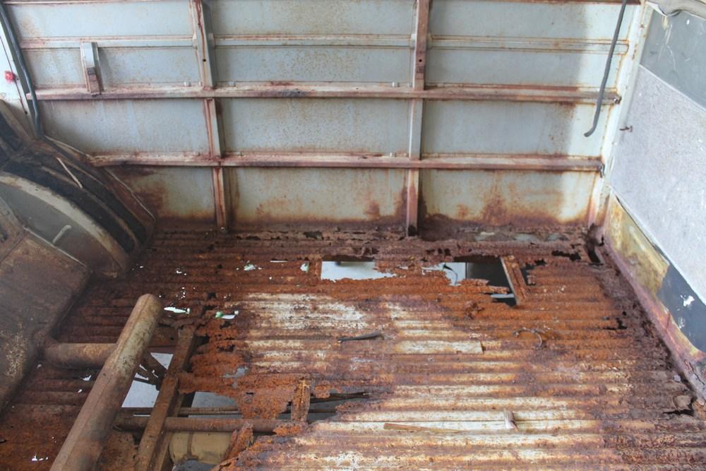

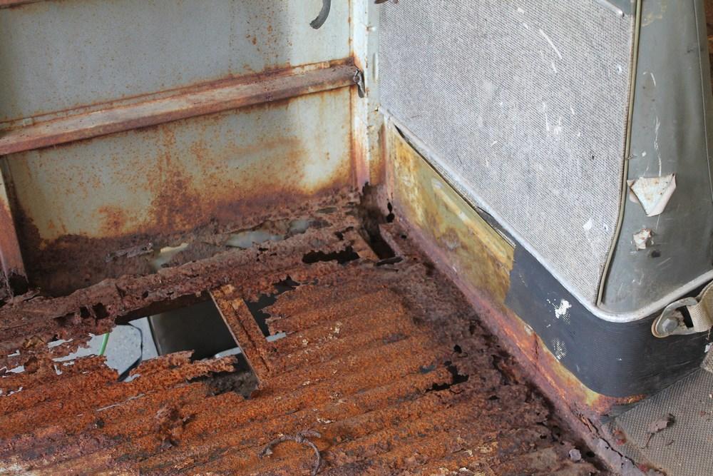

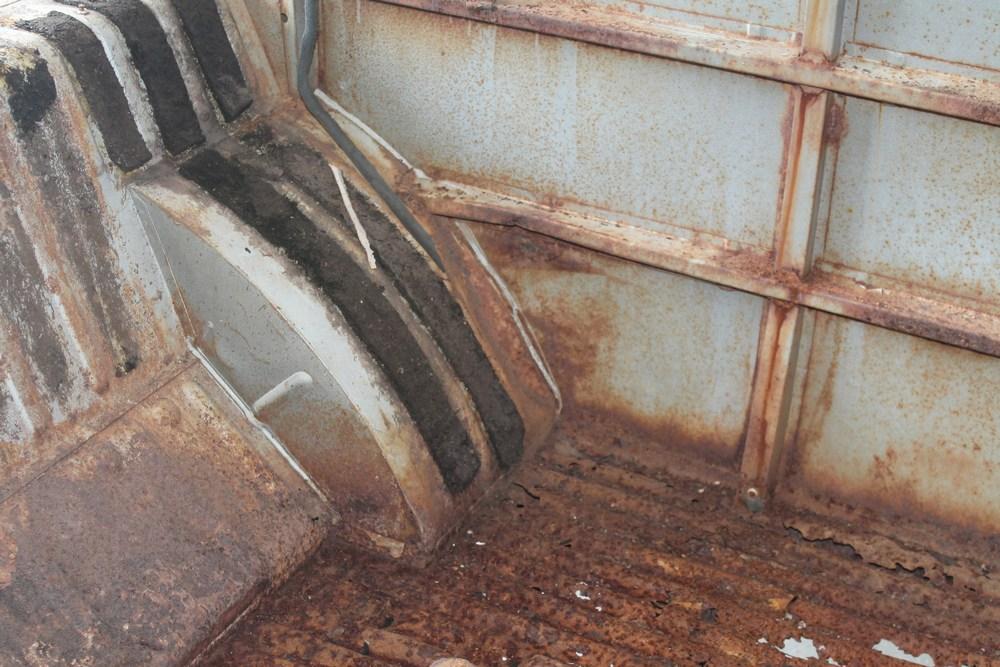

After bug bombing the crap out of Green Mountain I started cleaning it up and rolled it in the garage. I am going to start with the cargo floor and center section so here is a few shots of what I am up against.
I have gerson cargo floors but will make outriggers, top hats and jack points from scratch.

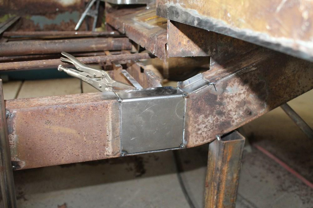

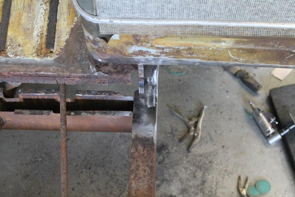

After removing what was left of the floor and some of the bulk head a nice surprise reveled itself.
After a little fitting the panel is ready to weld in. I left a small gap all around and beveled the frame and the piece to ensure plenty of penetration.
Welded up and ready to grind smooth.

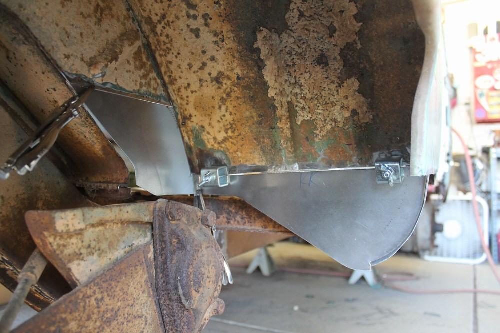

I also got the outriggers and rear splash panels made. Should start mocking up right side inner rocker and outriggers this weekend.

I also forgot to mention in the first post that the owner wants to save as much original paint as possible so the painter will have his work cut out for him. This is also the reason we didn't blast the bus.

wrstp wrote:
Very nice welds.

brettsvw wrote:
wrstp wrote:
Very nice welds.
I second that!

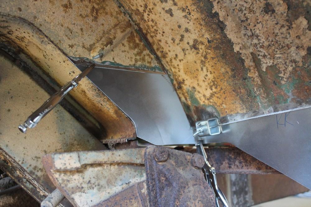

Got started on the right rear splash this morning.
Ended up being more then just the splash. I know I was shocked too.
I also set up the inner rocker and outriggers. The rear outrigger needed just a little tweaking but over all real happy with fit.

volksfahrer.nl wrote:
brettsvw wrote:
wrstp wrote:
Very nice welds.
I second that!
Funny, as I was looking through the pictures I saw this weld and started to count how many photos there were for my edited quote of this pic. Then I realized that others saw the same thing.
When I weld, I celebrate the occasion that my work comes out any where near this nice. Well done!
