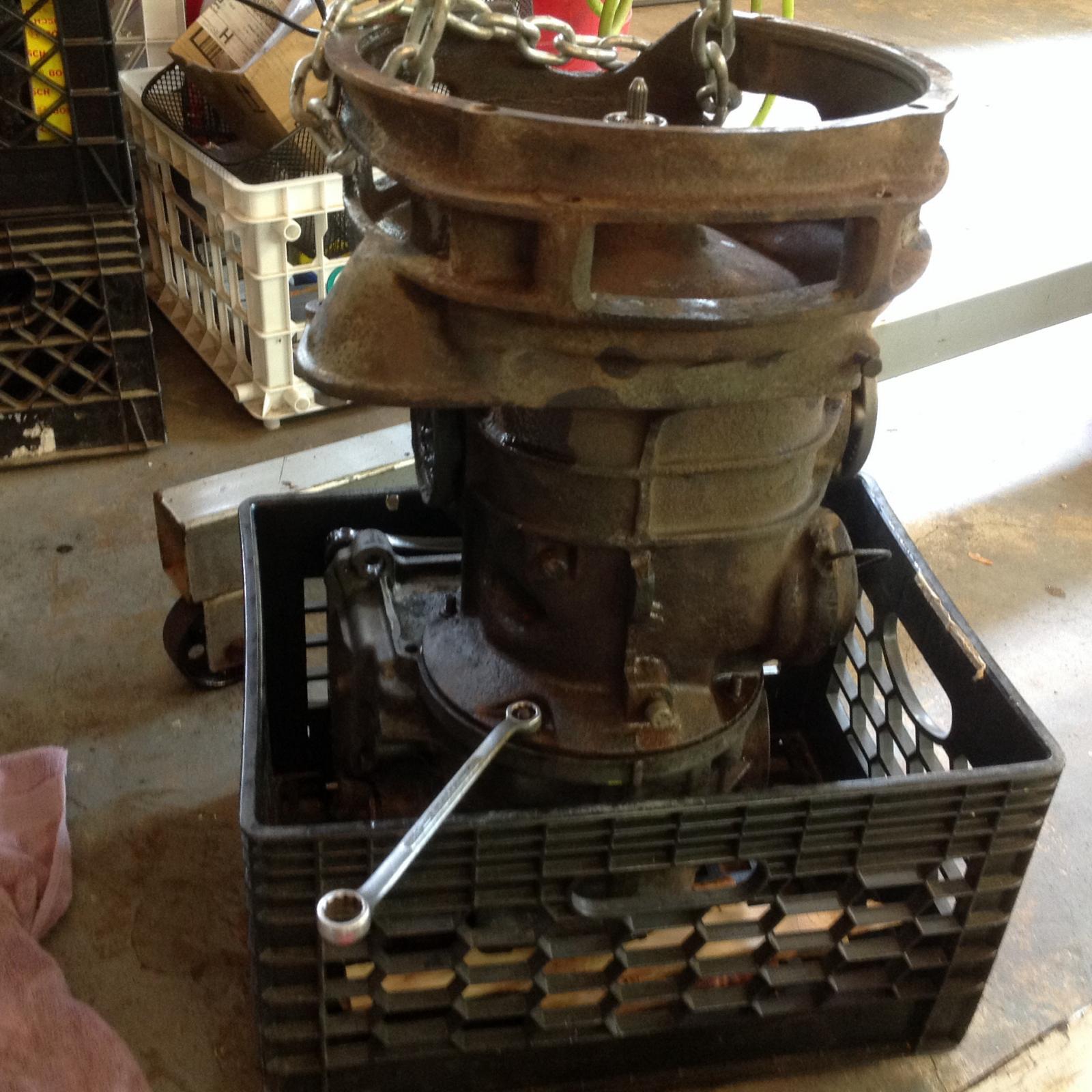

Remove the Transaxle assembly from the Van.
Drain the fluids.

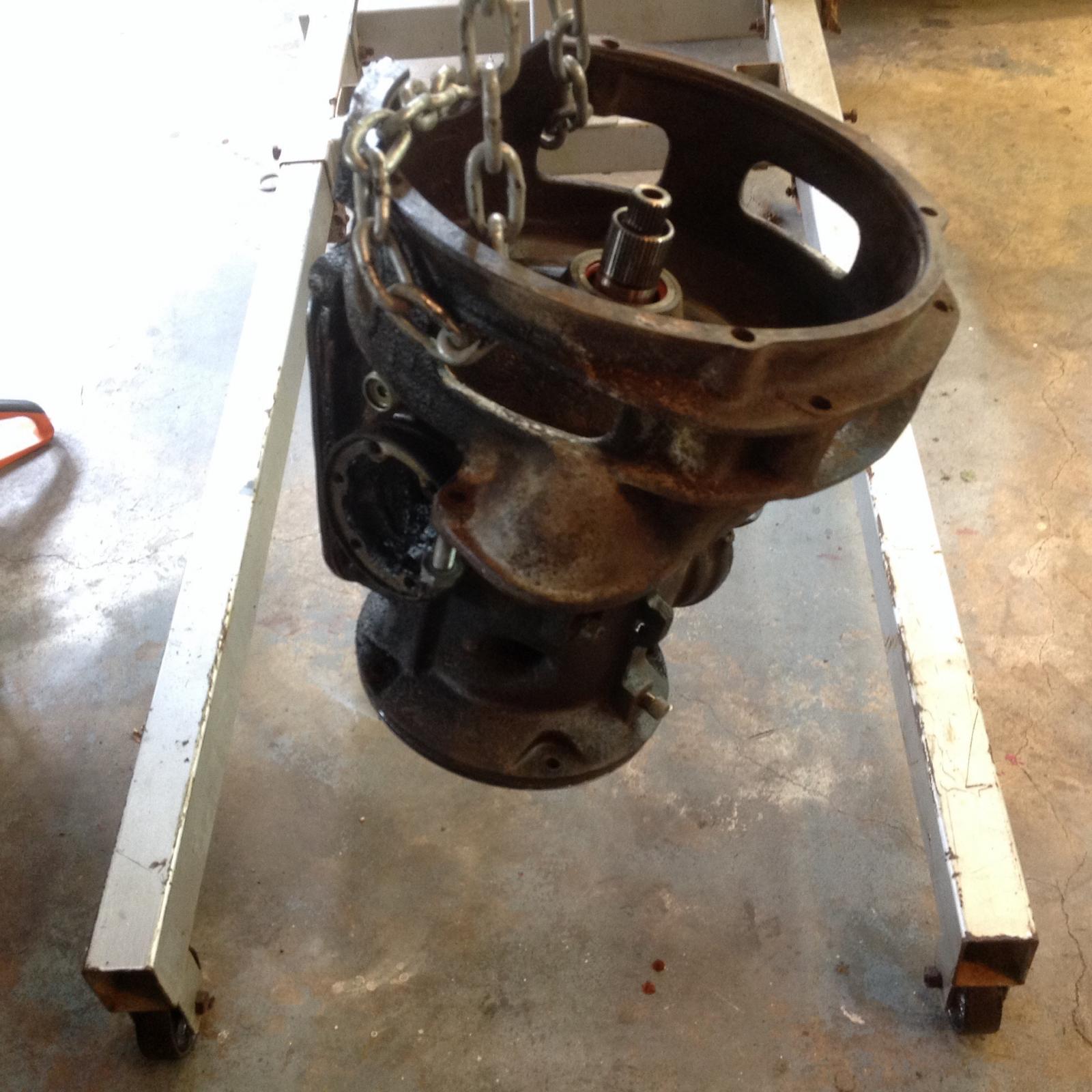

The entire assembly is heavy, each separate assembly is still heavy so enlist a strong helper or do as I did and use my engine hoist.
I stood the assembly engine end up in a Milk Crate. I blocked the unit so as not to tip over.
The chain around the bell housing helped for sure! ......
The two units are held together with just four (4) 13mm nuts with washers under each nut.
Remove the four nuts and washers........

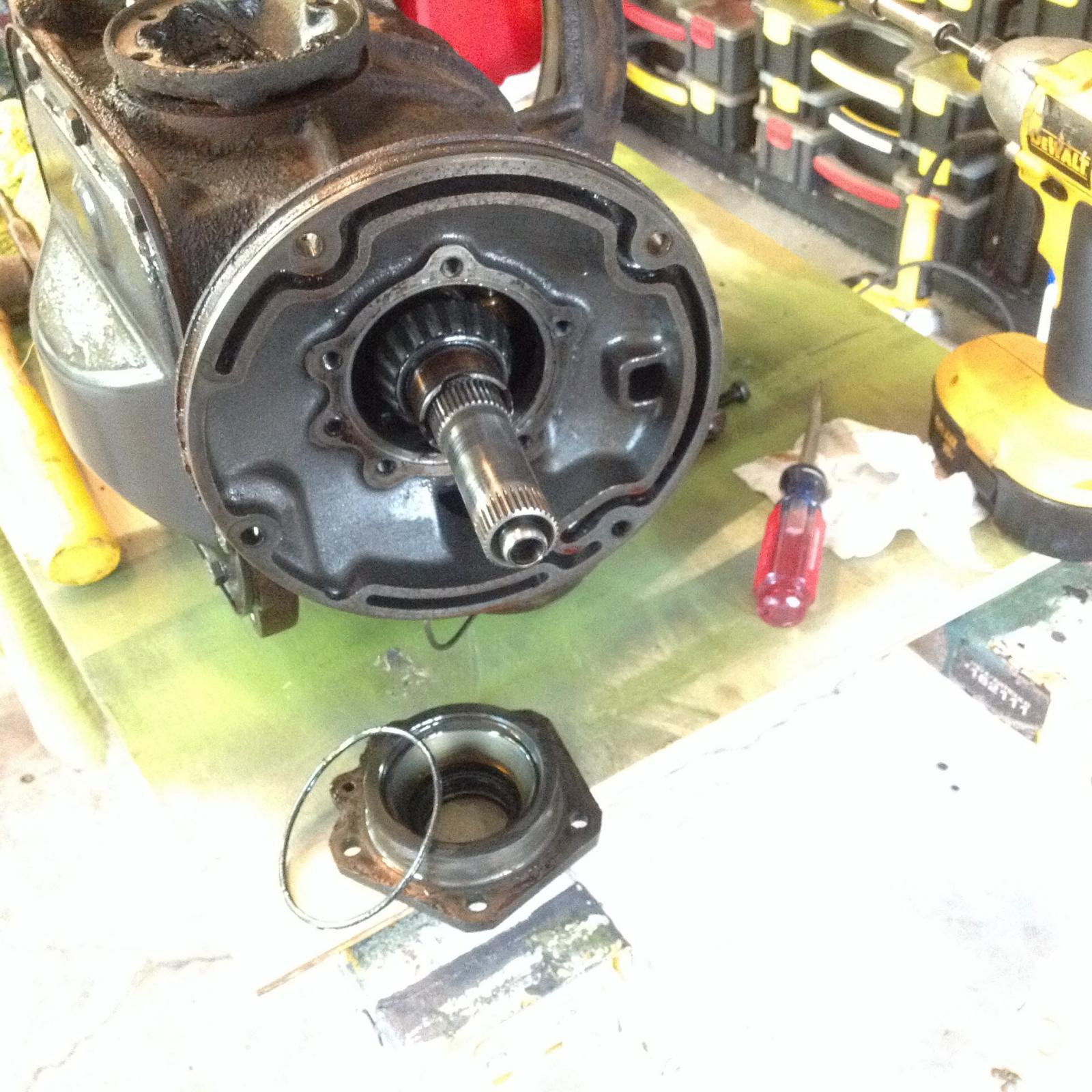

Once the nuts were removed I raised the Final drive assembly but the Auto trans held fast to it.
Having read about doing this I knew that there was a large ORing around the circumference of the final drive unit.
Here is a photo showing the ORing and the corrosion that I needed to break free.......
I took a block of wood and a hammer and while the unit hung a half inch or so I tapped around the final drive allowing gravity to help separate the two.
It did........
Here is the final drive without the Auto Trans.......
I put the final drive unit on a bench so I could work on it.
You can see the nose cone that supports the shaft, it is held on with five 13mm head bolts.....

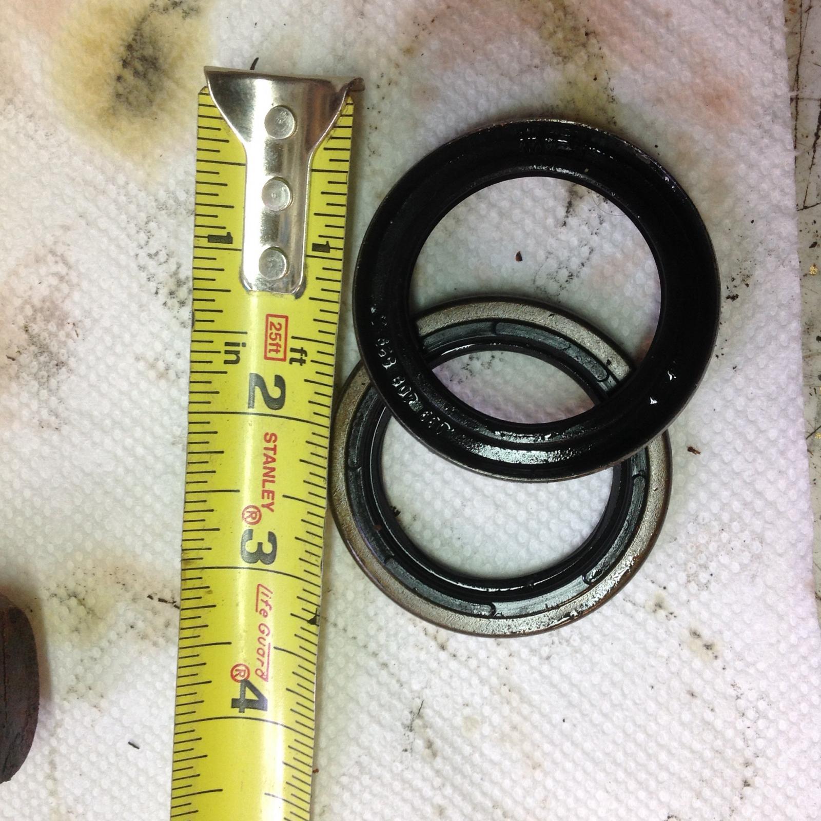

A close up of the seals......
While the seals can be dug out in place, I chose to remove the housing and replace them in a more rational manner......
Here are photos of the housing showing the two seals in place. They are installed outside face to outside face........
The old seals......

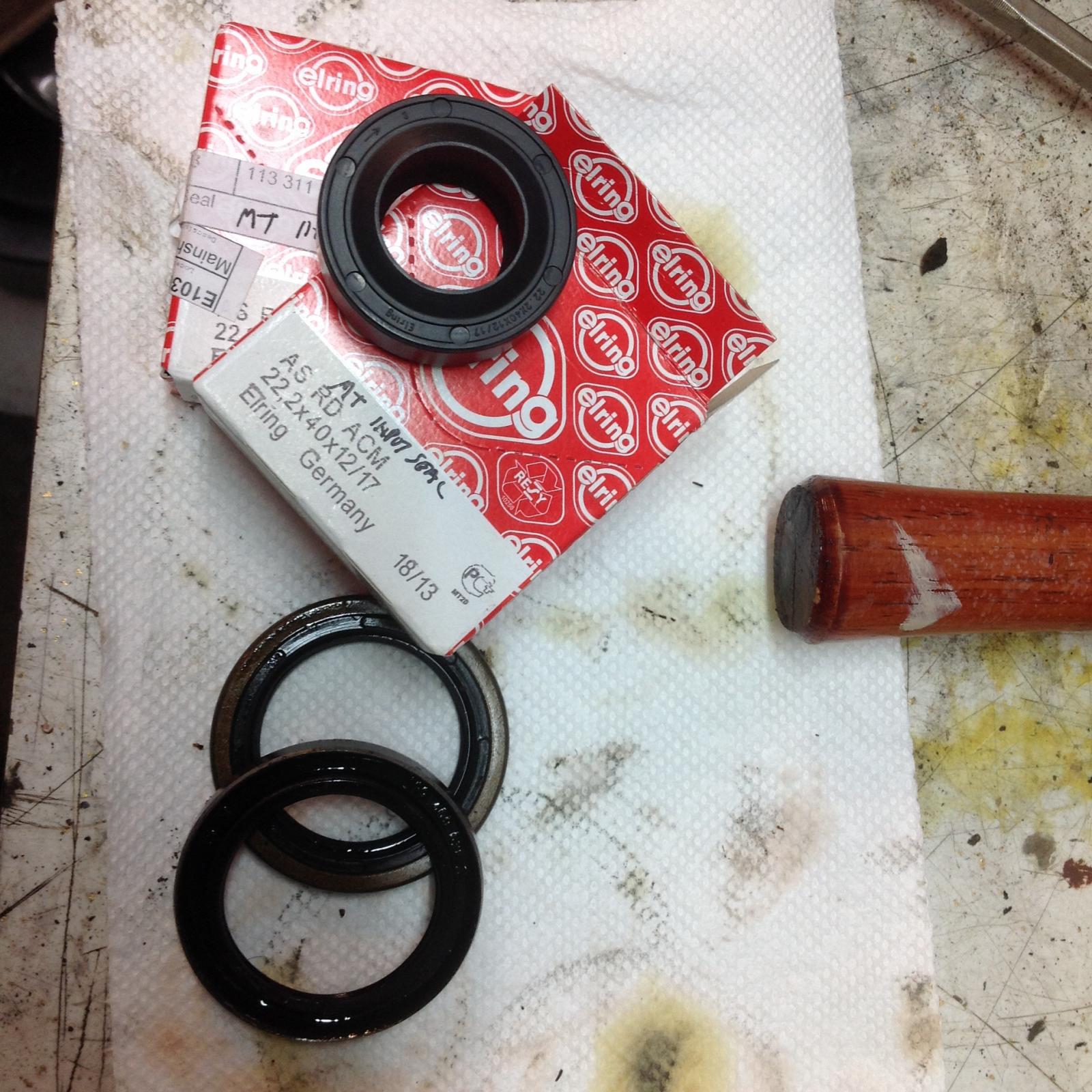

Sadly my FLAPS sold me two of these...... Manual Transmission input shaft seals!!
I try to shop local but sometimes...... Grrrr.......
Anyway, placed an order for them (and several other items) with VanCafe..... Normally 36 hours to my doorstep here in NJ via US Mail.

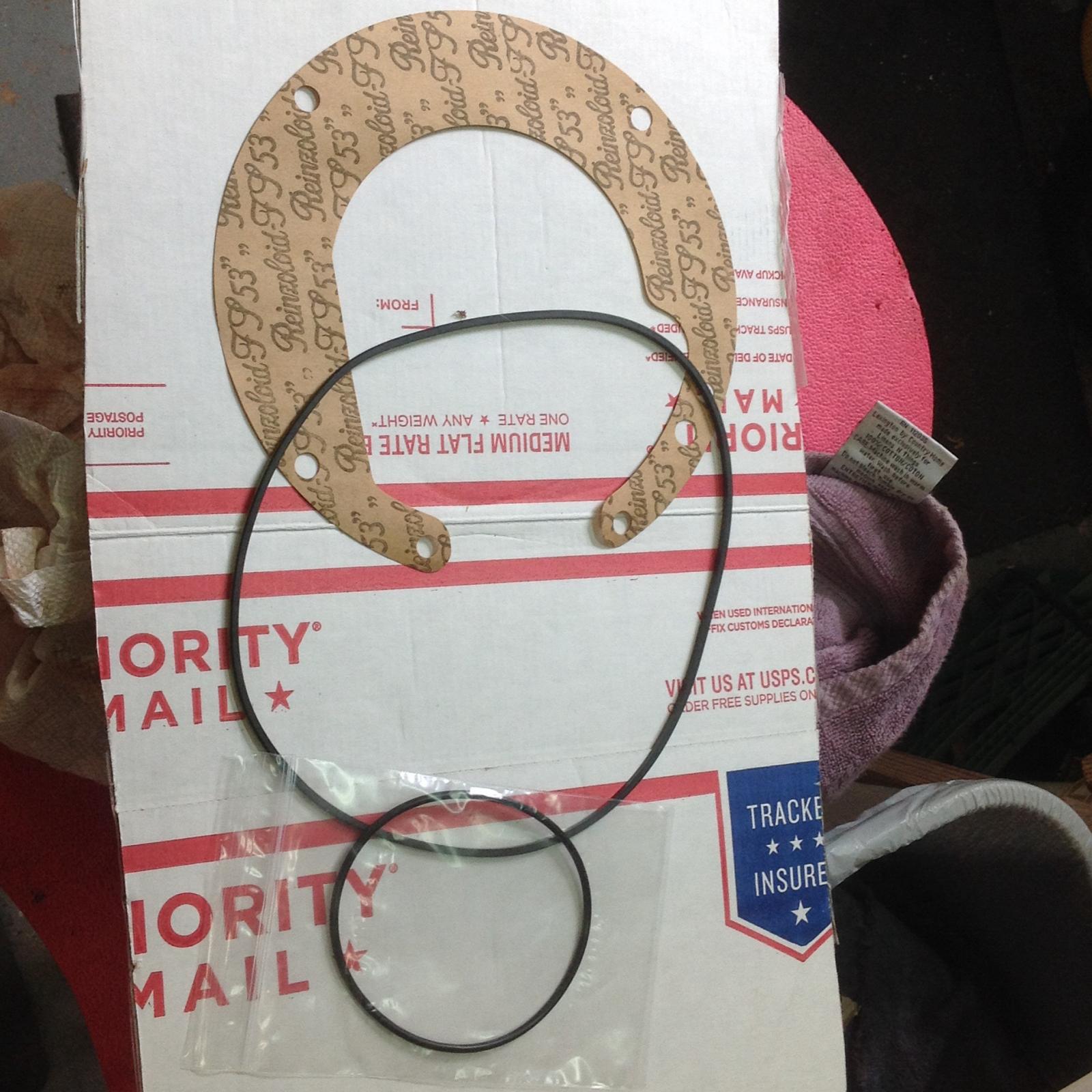

The seals under bearing cap, the two ORings?
O rings..... 78 x 3 and 6 x 2 under the bearing cap.

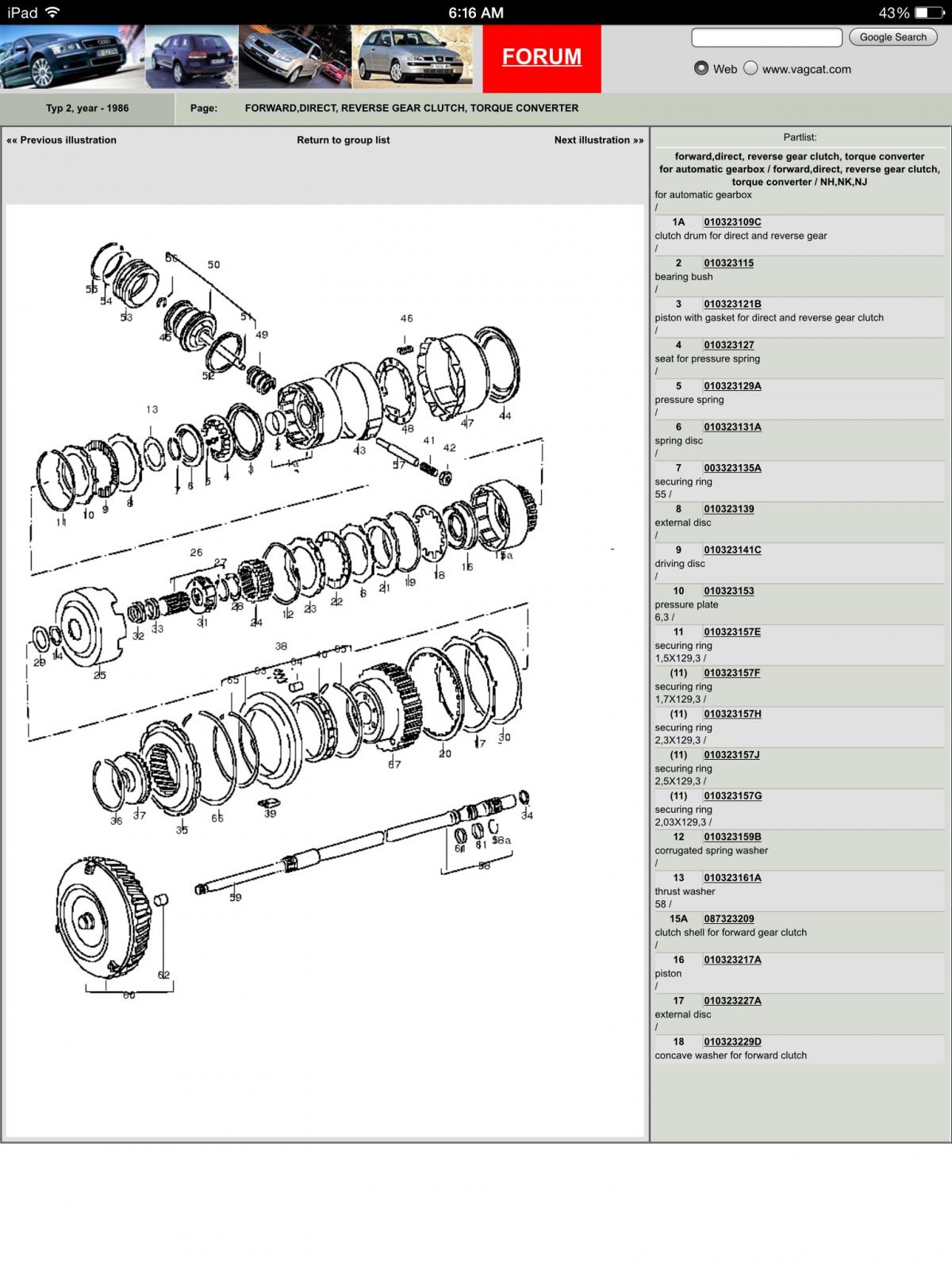

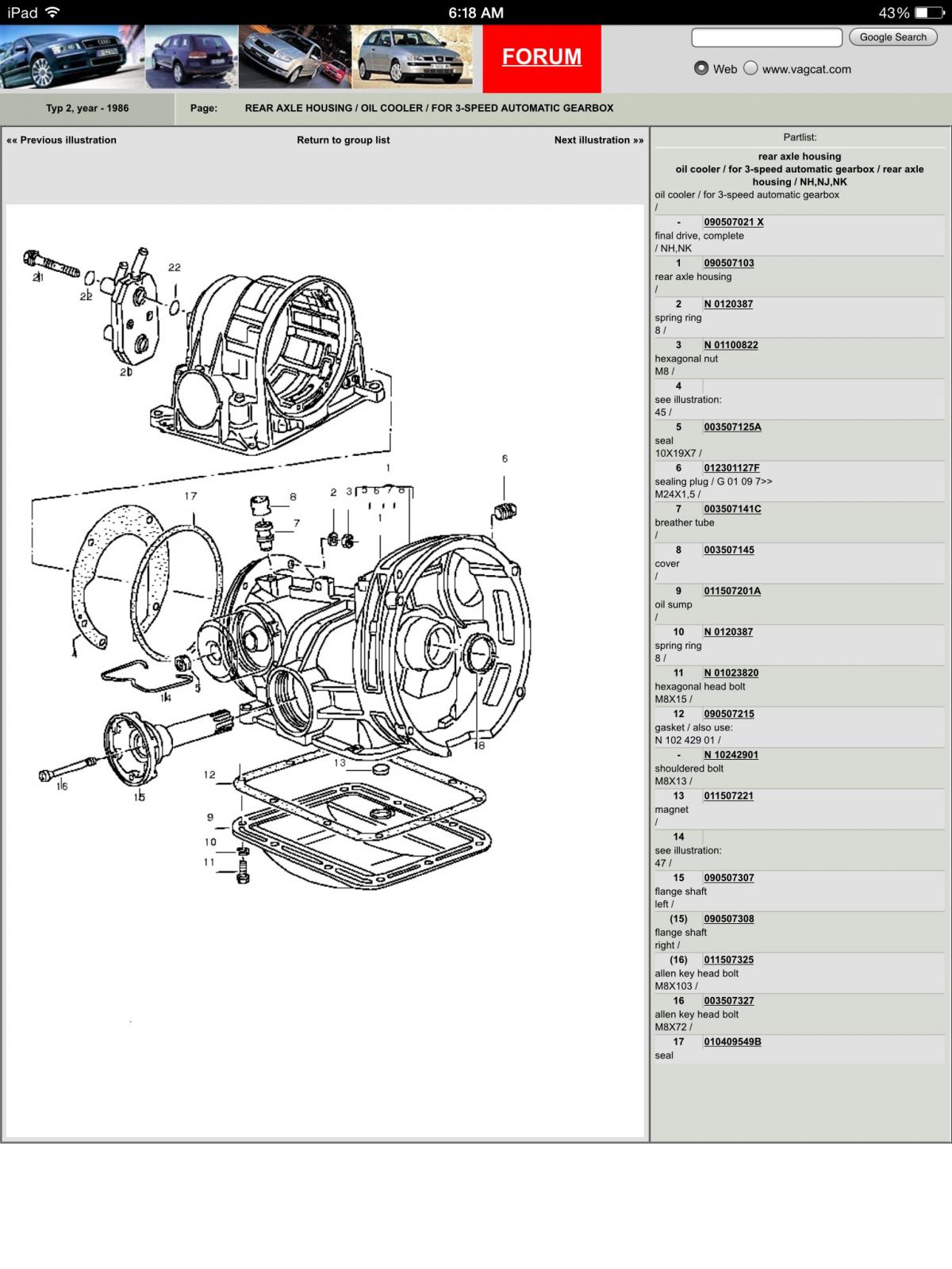

The governor shaft seal is #5 in the next to last drawing and the pinion shaft seal is #1 in the last drawing.
I assume you know about the torque converter seal?

djkeev
Joined: September 30, 2007
Posts: 32989
djkeev is offline
PostPosted: Sun Aug 02, 2015 6:35 am    Post subject: Reply with quote
Merian wrote:
very useful thread
but don't you also need that O-ring? you aren't going to reuse it are you?
and I didn't see it in the pic...
Well Gee Thanks for putting that seed of doubt in MY brain!!!!
I was going to smear some silicone grease on the old seals and the reinstall.
But now? Just ordered some seals!
I Never ordered from them, I'll see how they ship! Hopefully QUICKLY!!!! VanCafe quick?
3mm x 78mm
2mm x 6mm
Buna-N 70 Metric ORing

PostPosted: Mon Aug 03, 2015 10:13 am    Post subject: Reply with quote
As it turns out the Oring Store is in Idaho, has my Orings in stock and is shipping priority mail today.
Laughing
Dave
