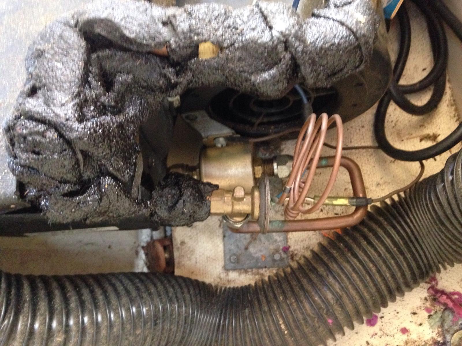

Someone asked if each Evaporator had an Expansion Valve,
Answer is..... Yes.
Photo of the rear......
Could not see it but felt the front one.
I also took a photo of the Behr Dual Evaporator Wiring Diagram....
There is only one Condenser mounted in the system. The compressor has a T fitting at the suction side where each Evaporator returns to the compressor.
The Reciever Dryer is located in an impossible to reach spot behind the RF headlight!
I did not replace it for the system still held a slight R12 charge before I evacuated it.
