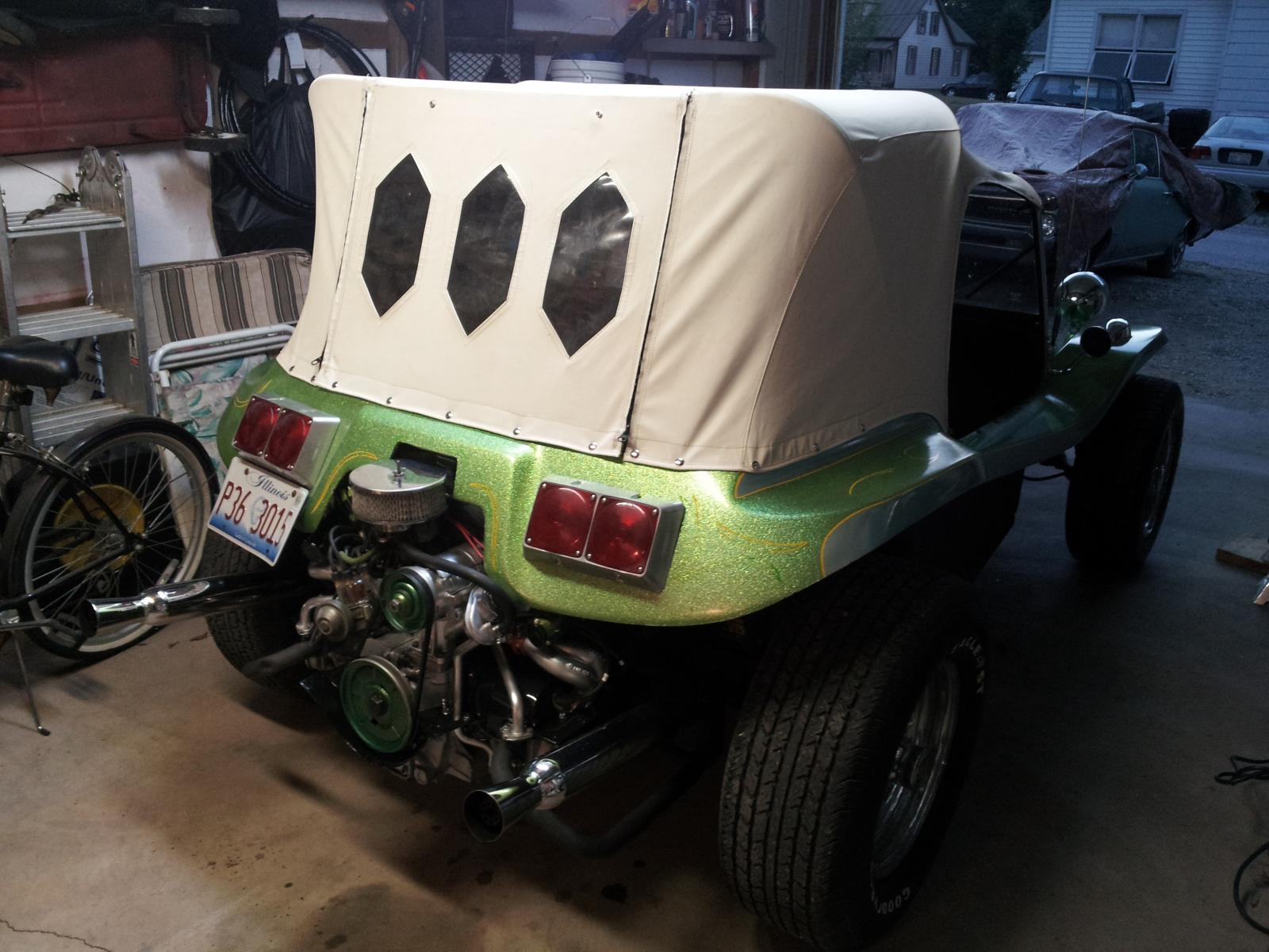

Does anyone have some pictures of how the tube frame is on the Manx soft top. I have a nos top that came with side curtains with one of my buggies and it matches up to exactly to my Manx II , So I need to have the tube frame made.
Here are some pictures in a moment.
thanks Marc.

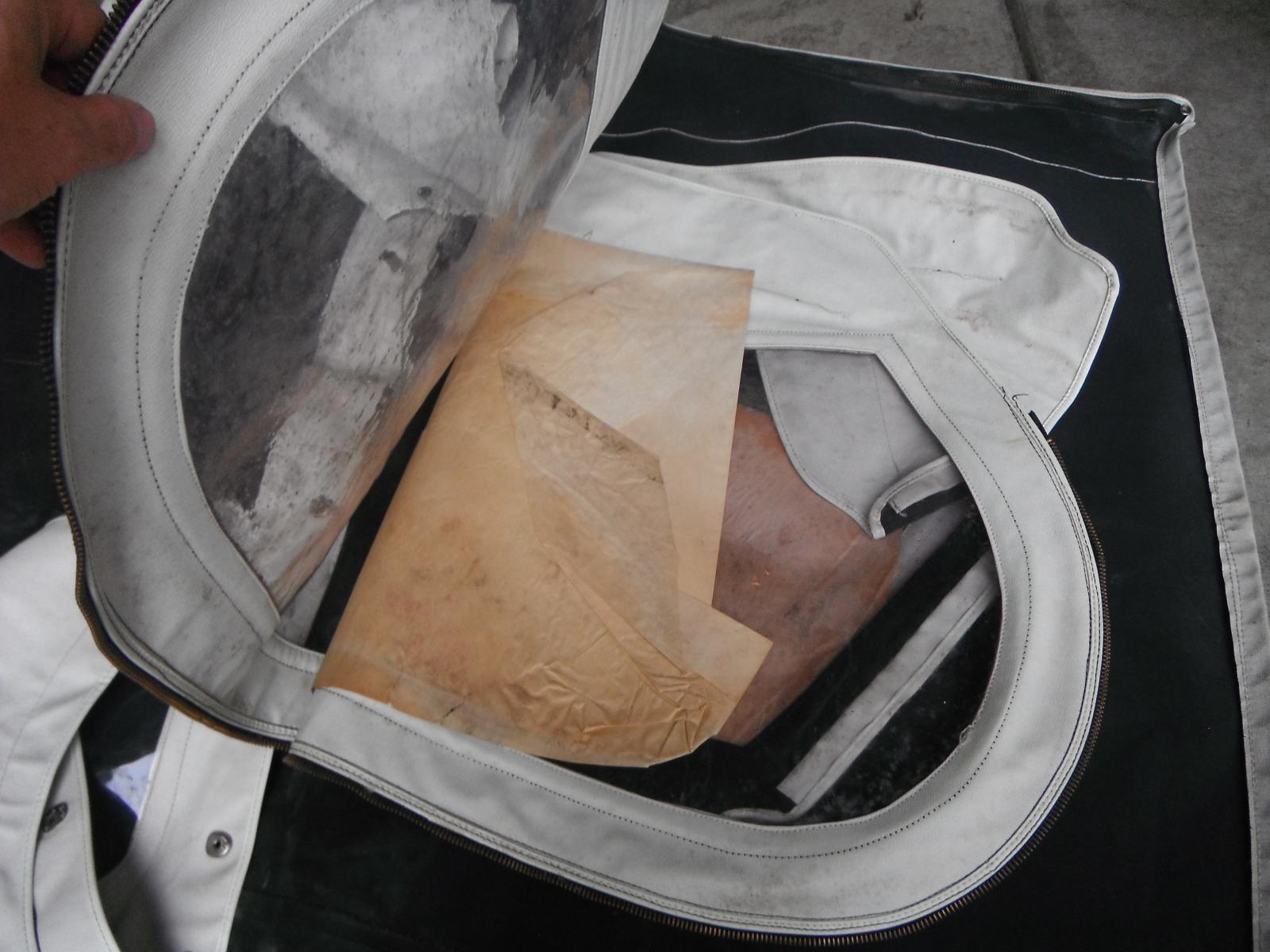

Not sure if if its a real Manx top were their several manufactures? I know some had rear side windows. It has the spike receptacle and you press it over; the side curtains zip on the top to the top ,and has snaps to the body on the inside.
So again the white top came with my emerald Manx and was never installed.
There are no snaps screwed into the green Manx , it just came with the top.
It even has the brown paper in between the windows.
So I saw the snaps on my yellow Manx and they Match up perfect even the inside snaps.
That's why I am wondering if this is a factory Manx top?

Here are Picture's of the Manx II and the soft top that lines up perfect ,If it's a real Manx top I don't know

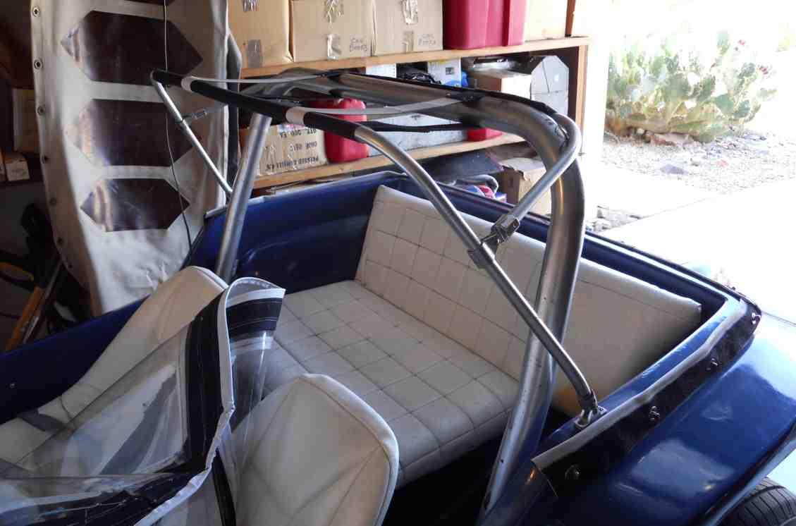

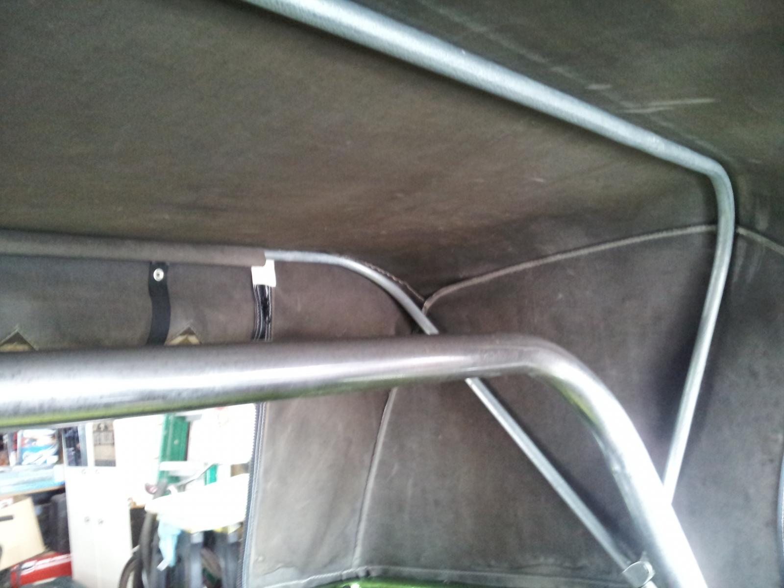

Here are a couple of pics of mine. The dimensions are as follows:
17.5x43x17.5 and 23.5x43x23.5
The 23 one goes to the rear and the 17 to the front. It adjusts for fit. The rear bow is inside a sleeve and there is a strap that keeps the bows from spreading too much.
LMK if you need more information _________________ Or you can call me………Tim
My two pennies…your mileage may vary
I’m not a complete idiot, there are parts missing |

This picture shows top bows for an original style top as seen in the original Manx catalog. This configuration hides bows when using this style 3 window top from being seen from the outside. Note straps between loops to keep the top tension tight so it does not flap at speed. The velcro strip around perimeter of body holds the top on without any snaps showing (not original).
Picture of original style top. No blind spots when driving. No snaps showing.
Picture from original Manx catalog. Price approx. $127.00 or so with side curtains, top bows, and all fasteners.
