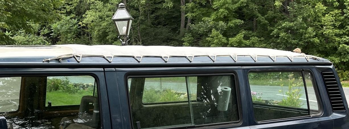

Bike... Post some pics to get more of a response. Tell us what you are trying to achieve in terms of the use of the car after the mod, and we can help you with ideas, posts, troubles and how-tos. For example, I have a 95% daily driver, but I wanted the ability to stand up for loading awkward cargoes, 5% camping and even the ability to have an open roof like my '87 factory sunroof which I loved.
What I now have, love and wouldn't go back for the world. A fiberglass hightop could be made and clamped to the rain gutters too.
This started as a normal tintop.
Anything can be done if you want it.
Duncan
