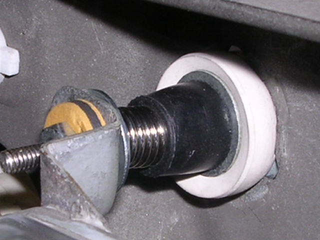

Built a replacement out of faucet grommets, #10 bolt and a spring.

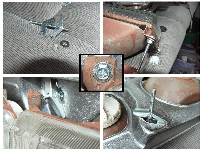

Here is my contribution to the DIY headlight adjuster. These are nice because they just screw on and you can get the parts from Home Depot or Ace. Total cost is around $1.00/ea if you buy enough to make 5 or 6.
I like the type of drywall fasterner that has both a screw and a hex head. A lock nut and washer is used to snug up against the bracket in case you can't see it in the photo. I thought maybe the two fasterners pushing against each side might make it hard to turn the screw, but nope, easier than stock. Disclaimer: I haven't done a long term test, but feels great.
