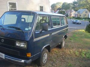

Here is the before shot.

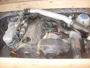

And the money shot. This is the old Corrado G60 supercharged i4 that has since been pulled. It was fast but it looked like it was going to fall out at any minute. PDX Aaron is the new owner of the motor if you are interested.

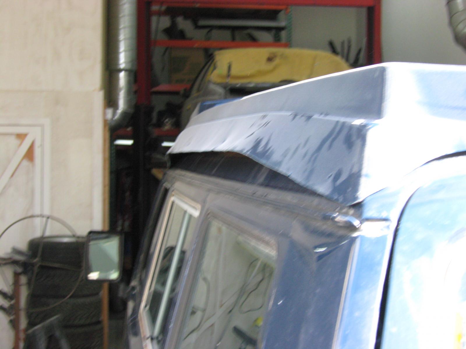

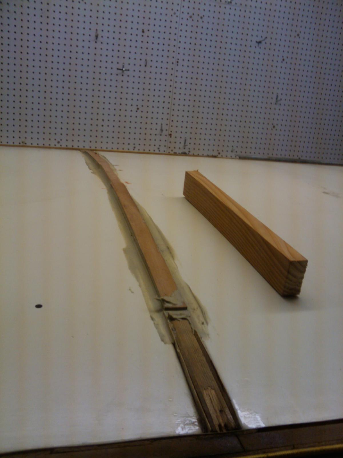

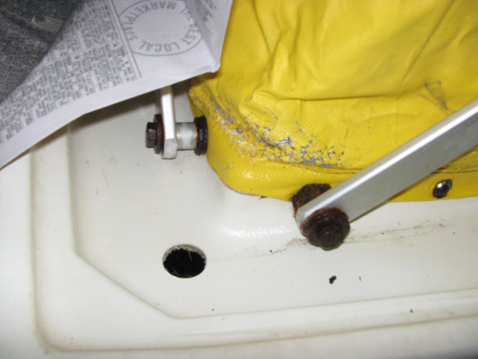

The top had a few "wows" in the main structure. The wood under the base was all rotted and being held in place by the rust holding on the hardware. The interior plastic was cracked. Some of the hardware was missing or badly corroded. The yellow canvas was in ok shape. It had lost its rubberized coating in a few places and there were a few issues with the screen but that was about it.
Before photos.

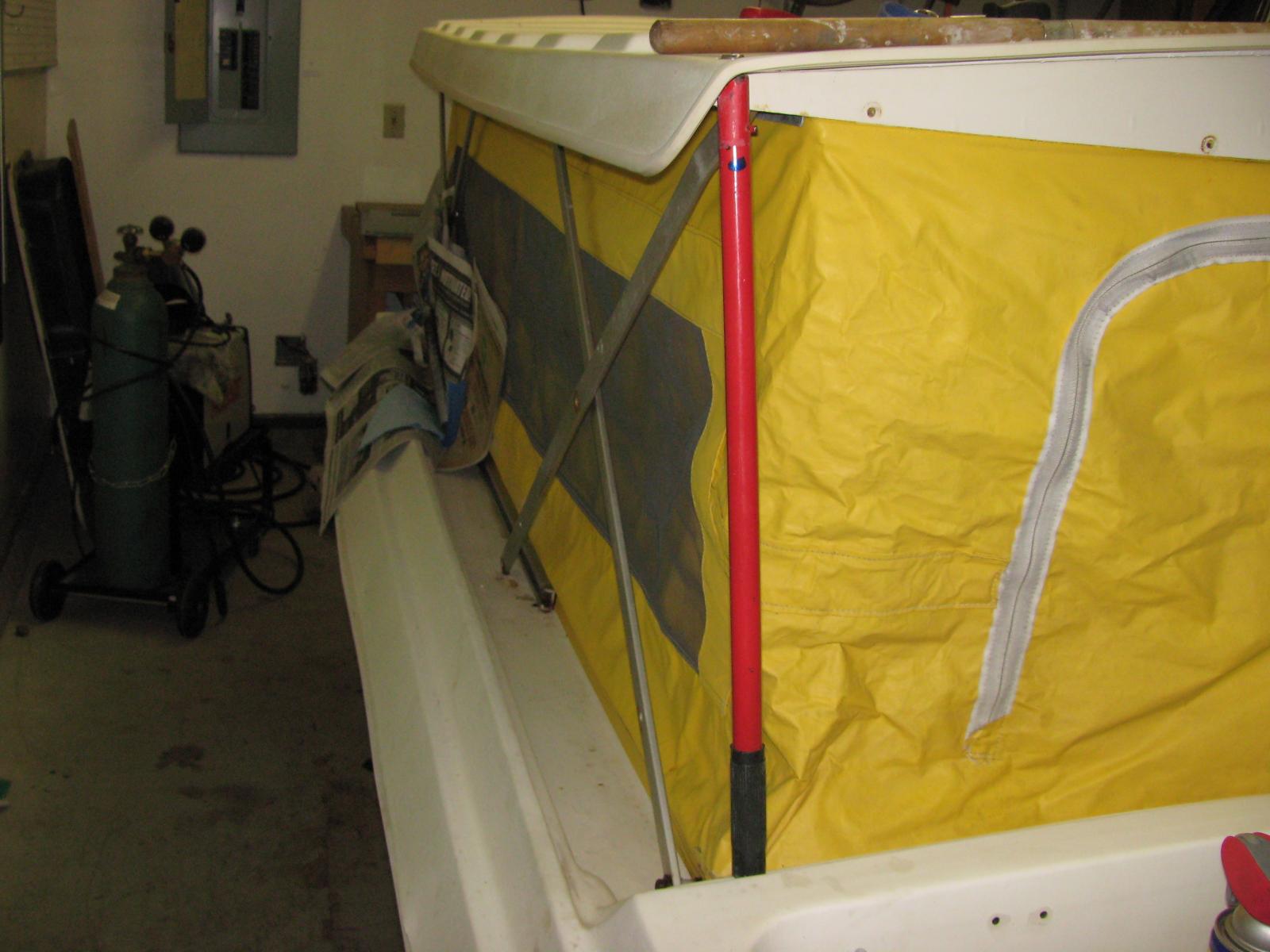

Unfortunately, the top had been stored neatly on a saw horse on one end and on an anti-gravity well filled with dirt and spiders on the other. Fiberglass and plastic don't play well in the sand box under those conditions. After consulting my fiberglass buddy from glass from the past, who was still reeling from my Audi TT big turbo kit build gone bad, I got him to visit my garage under the condition I didn't have him help in any way, shape or form.
He advised the liberal use of a heat gun.
I used clamps to hold long boards to the sides. I slowly heated the surrounding plastic/fiberglass sides while increasing pressure with the clamps. I left it in place for a week. Good for wood as they say in the land surveying world.
Here it is AFTER straightening. Note the "wow". I use a lot of technical industry terms.
And the wow showing its face when the top was just placed on the van.
The bottom piece was pretty rigid. The top hat was also pretty stout and in good shape. The interior plastic was brittle and cracked. I got it all taken part ok. I had to drill out or cut off some of the hardware.
I then set out to replace all the wood substructure under the base with redwood and lots of construction glue. In hind sight I wish I had primed all the wood. Didn't get pictures.
I replaced all the wood in the interior plastic piece with redwood, construction adhesive, and new stainless screws. I also painstakingly glued new plastic strips to the back to chemically weld the cracked bits back together. It all cracked later. In retrospect I should have had the whole thing covered with some kind of upholstery material and not wasted my time trying to fix the cracks.

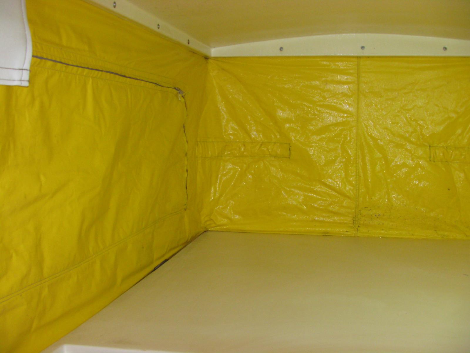

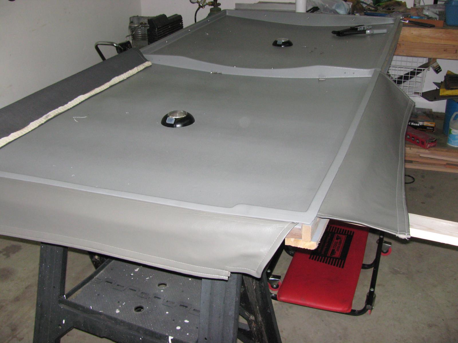

I didn't like the skanky white-ish fabric that is used to wrap around the opening. The velcro and rusty staple stains look like hell.
I washed them with simple green and then water/bleach. It still looked like the old mans white tshirts. So I decided to try out some vinyl fabric stain.
This is where I learned that being OCD doesn't always pay out. I thought I'd get fancy and tried to use some of that new spangled plastic dip on the ends of my newly polished/restored aluminum lift rods. It cured for weeks before I had a chance to put it on the top. The rubberized material leached into my new white canvas from bus depot and then sluffed off with the slightest touch from matter. Stay away from that garbage.
Here is the interior plastic piece ready for reinstall. I removed the old busted-up light and replaced it with a couple switched LEDs. I think the vinyl fabric stain worked outstanding.

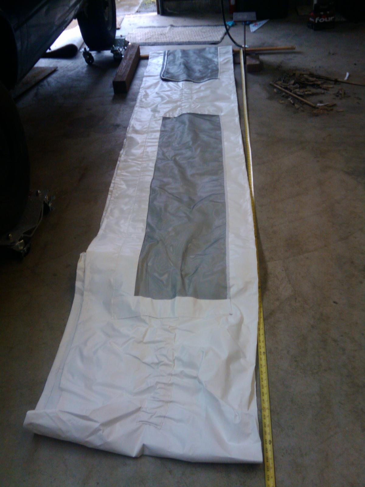

New canvas. Measure twice, order wrong. Forest Gump's mother said "stupid is as stupid does". At the time I didn't understand what that meant. I do now.
When ordering canvas make sure that you measure the circumference of the middle when open. I measured the curb at the base of the opening. For extra OCD measure I'd recommend that you also measure the top curb where the material hits the canvas and send all three into bus depot.
I kind of measured the circumference of the curb when the top was fully assembled and the old yellow canvas still in place. This didn't help with my precision either. In the end Bus Depot said to measure the middle when the top is open. I also learned that there are two sizes for these and I'm willing to bet that the CountryHome Camper top is a 3rd size - but don't quote me on that.
Again my old friend fate would jump in to help mitigate for my stupidity when the tent bus depot sent me had been mis-manufactured and had the elastic all jacked up. They were happy to send a new one. To this day I don't know the exact measurement or method of measurement.
Next step. Putting it all back together. Shoving 10# of sausage into a 1# bag.
