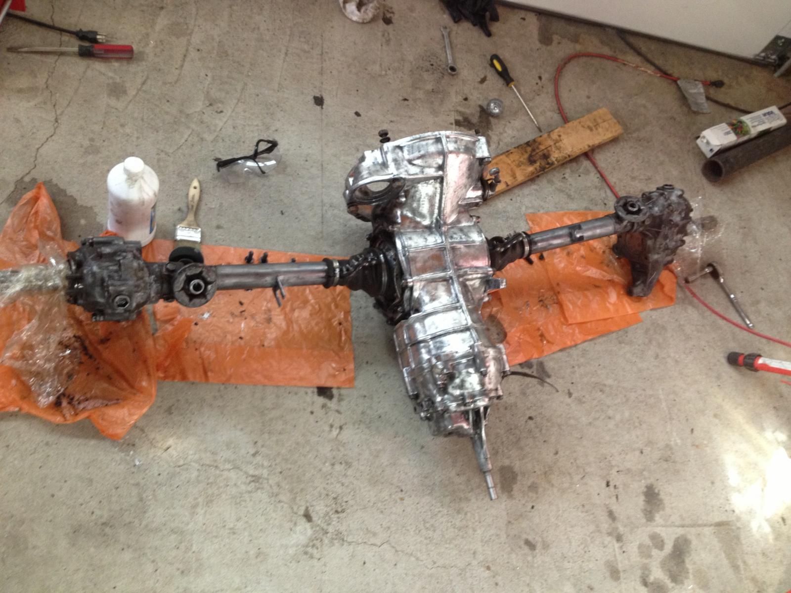

The transmission and reduction boxes are removed and I started te process of degreasing, and wire wheeling any corrosion. The axles and boxes were ten treated with POr-15 metal ready rust inhibitor. The tranny, axles and boxes are going to be inspected and resealed.
As you can see I wire wheeled the transmission. It was covered in seepage and flaking old black paint. I plan to keep it O natural at this point.
After the axles and boxes are inspected and sealed I plan to paint them with POR-15. If anyone has examples of there boxes painted with this product it would be helpful. Input on pros and cons also helpful?

I wouldn't paint the transaxle with por15 since it is kinda thick paint and probably won't let heat out of the tranny
I would just do a few thin coats of hi-heat black paint like the factory did
Just to clarify the transmission will not get painted, just the reduction boxes. I'm leaning towards POR-15 the reduction boxes as they were rusted and wish to stop it as best as possible.

curtis4085 wrote:
They get hot also just like the tranny does

I wouldn't use Por 15 on your axle tubes either. I mean they aren't gonna rust through anytime soon. They will most likely outlast you. Just clean them up and get some black in a spray can. I really like the Rustoleum Paint & Primer in one.

Looks nice! but just so you know with the extent you have cleaned that transaxle bare oxidation will develop on the aluminum alloy. Its not like typical "rust" but rather a flaky white substance. But it looks nasty. Id put something over it the tubes and the RGB's you don't have to go crazy protective but something will be nice!

POR-15 would work on real clean RGB cases and seal the rust but I agree that things like axle tubes should be cleaned and scuffed up, and a rattle can paint sprayed over them. My favorite paint for things like transaxles, cooling tin, shift levers, etc. is plasti-kote engine enamel. Where ever I have used it, it has lasted. The only trouble is finding a store that stocks it. It can be ordered, though.

Campy thanks for the info. I have used lots of POR-15 on my other buses. Have done mostly undercarriage but have also had great results on floors and beams. I always clean and treat things very well before applying top coat.
Just love how bullet proof this stuff is.
69VWCarl thank you for the heads up. I am thinking of using some Joe Gibbs product to preserve and protect. This is the second tranny I have done this too.
BarryL you know it!! When ever I wire wheel I put on multiple layers. Running a wire wheel on a grinder at 30,000 RPMs are way to fast for the wire wheel to stay together. This time I ended up with couple stuck in my arm and inner thigh Shocked I still have some fragments in my forearm from doing the undercarriage on my 79. No pain no gain.

Don't get POR15 in the threads of the filler and drain plugs. Not sure how to avoid it, but...

When I did an underbody on up restoration of my 1963 camper some 13 years ago, I had painted the underbody and wheel wells grey. A few years later, I decided that I wanted there to be more protection so I cleaned everything with wax and grease remover, scuffed the paint up so the grey POR-15 would stick, and coated the paint with it. I think that I used several sponge brushes. I, also, coated the top of the front floor. The POR-15 flowed really well but it is shinier than the paint was. I am still driving the bus and none of it has come off. Last year, I did the same thing to my 1959 double door: I put grey POR-15 over the underbody and wheel wells. This time, I did not paint it first, though. I had a shield over my face and my head and body covered when I did it (very important).
Regarding wire wheels, the way to go is to put a twisted wire wheel on an angle grinder.

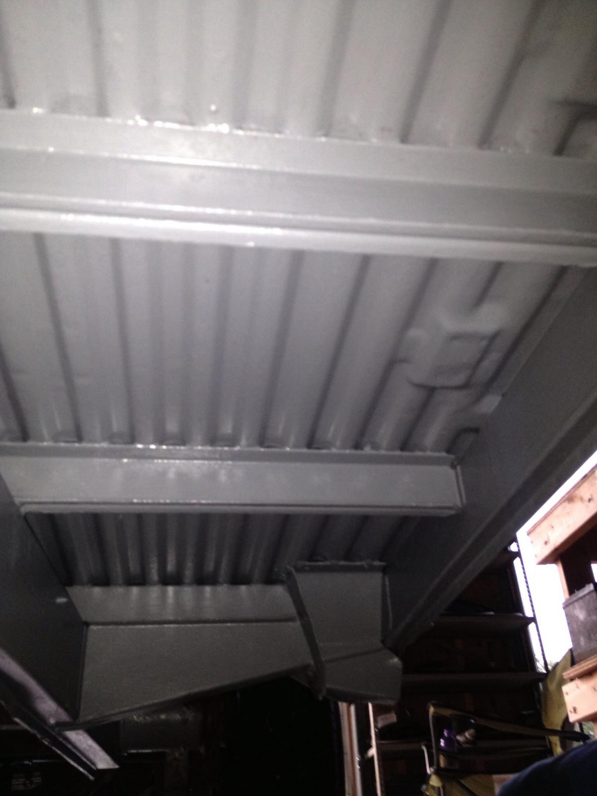

So I've decide to just shoot the reduction boxes and axle tubes with a high temp satin black. The POR-15 I started using but it peels up in sheets very easy. And yes I filled the directions and used all of there products for cleaning and prep. Only thing I can think that may have compromised the bonding was temps may have dipped to low during cure. Had the heat on but...
Which brings me to my next question... I'm planning on wire wheeling my undercarriage. Was leaning towardsedia blasting it but fear the sand getting in places I cannot access and it holding moisture over time rusting things out from the inside.
So can those that have been down this road give me some advice on the pros an cons comparing media blasting to wire wheeling an underbody. I'm am an ing on POT-15 the undercarriage in grey. Have given thought to etch priming, epoxy and industrial paint. Hit me with the goods people.
I also have surface rust in engine bay and could use suggestions for addressing the rust and painting. My first thought is same as above wire wheel either POr-15 prime and paint. Or just wire wheel, etch prime and paint. Am leaning towards etching and painting as POr-15 is a bear to sand any imperfections smooth.
