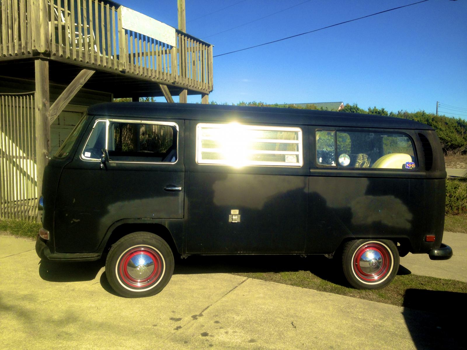

I've been researching the different ways to lowering a bus, and it seems the nicest, easiest way is with the kit off of Wagenwest. Only issue is it's pretty pricey for me at the moment. Wondering if there's any other places you could recommend on how to do this, kits sold? or maybe someones stories on their attempts at it! Thanks for your help

I lowered one with different wheels only, works great. 15 inch Fuchs in front with low profile tires dropped it 2 inches and the rear is 17's with low profile tires. _________________ 1971 Deluxe Sunroof Bay 1905 stroker, dual idf40's, 74mm Scat forged crank, engle 110 cam. CB 044 heads, AutoCraft rockers, chromoly push rods

drop spindles + re-indexing the back = pretty cheap.
probably cost less than a set of properly rated tires  _________________ 88 Van WBX, A/T - 93 Multivan 5cyl 5M/T - 13 JSW TDI 6M/T - 2012 Touareg TDI Sport |
