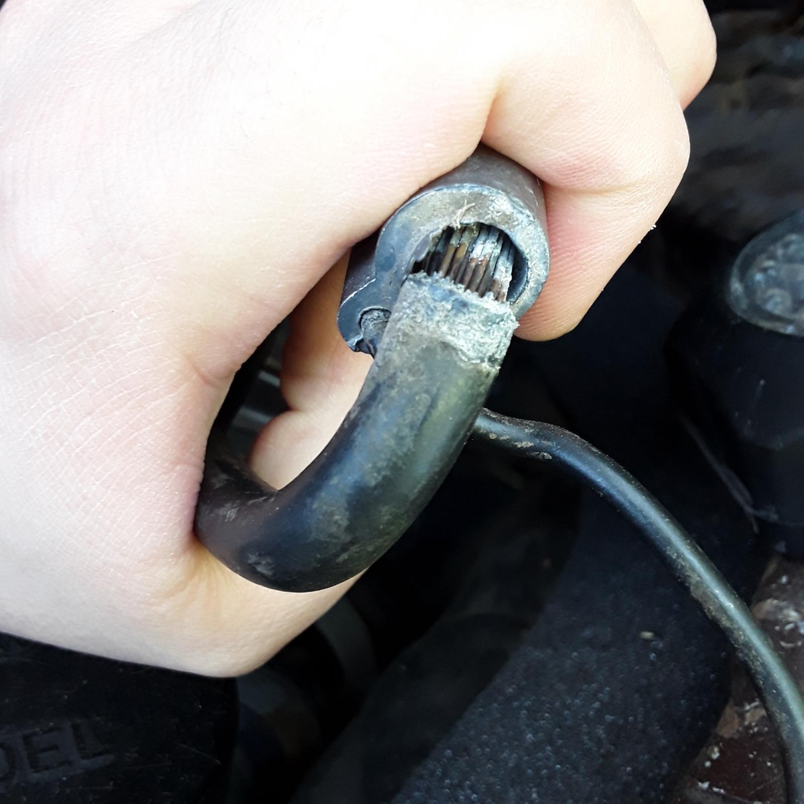

Looks like i figured it out.. figured it had to be the positive battery cable, so i pulled it out and it looks like the copper was exposed in multiple places. replaced the cable with a 46 inch and it’s worked great since this morning.
Thank you everybody for your help, as always, VERY much appreciated
