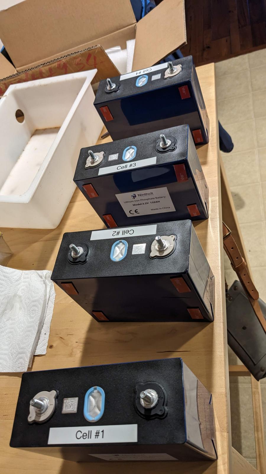

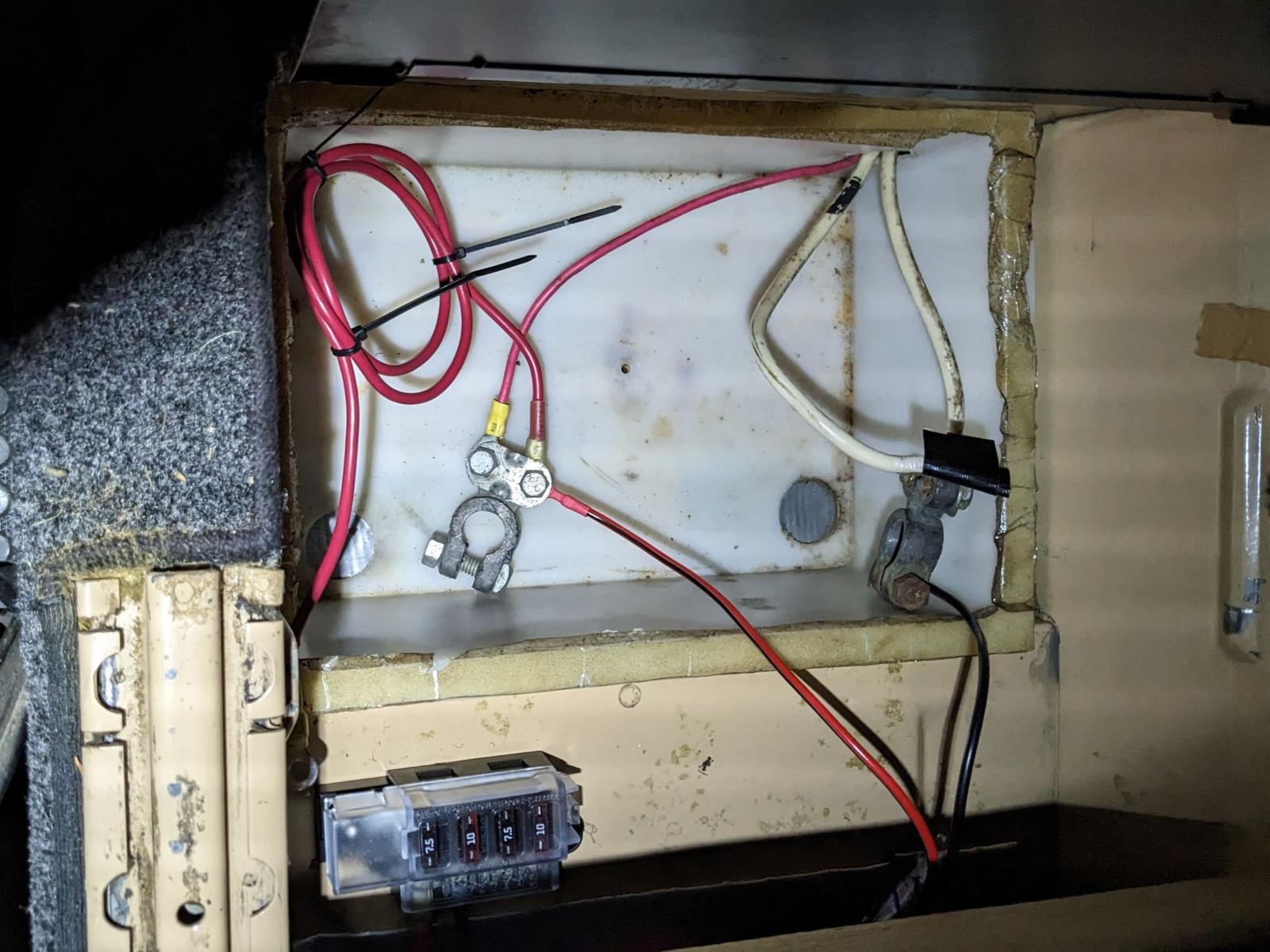

Here is a photo of where the battery will live. The ASI Riviera campers came with a thermo-formed plastic battery enclosure designed to fit the vanagon battery box, complete with vent holes on the underside for off-gassing out of the living space. There is an upper half of the enclosure that is not shown in the photo. The small fuse panel shown is how the fuse 8 and 9 circuits (interior lights, radio, and cig lighter) are currently powered by a portable battery when camping. This will eventually be connected to a bus bar near the new battery.

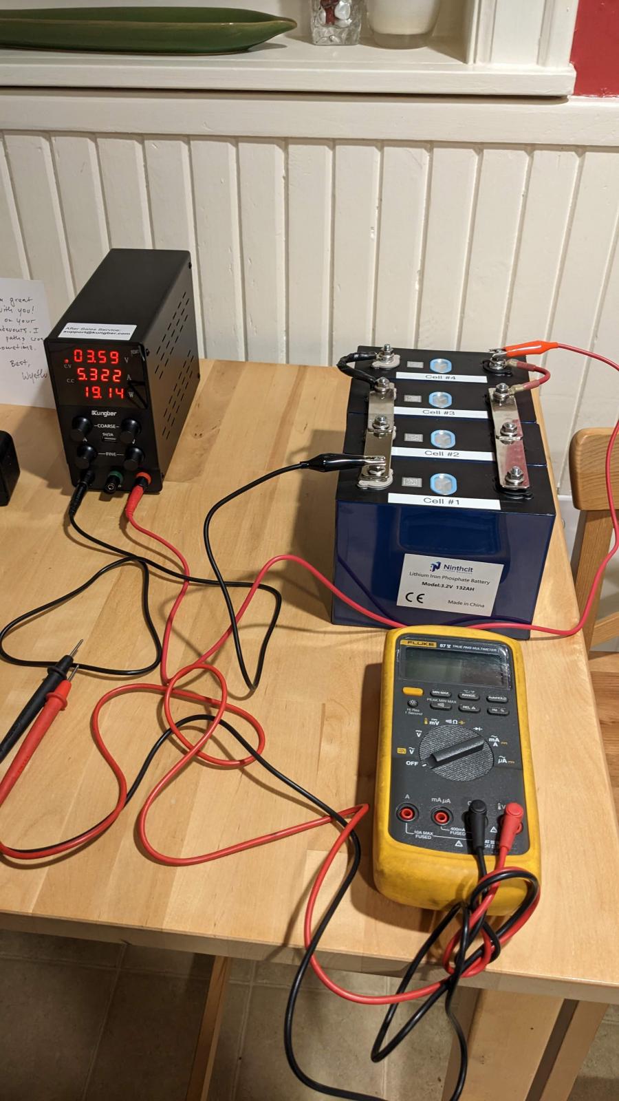

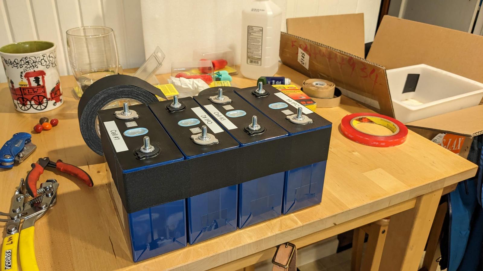

Top balancing the cells in parallel to 3.65 per cell took 3 days, running almost constantly. To speed this up next time, I would charge the cells in series to 13.6 and then switch to parallel charging for the final charge and top balance.
Be sure to use a volt meter to check the polarity of each cell terminal (in case any are mislabled), as well as the output voltage of the power supply. My cheap 10amp power supply was off by about 30 mV.
Individual cells were labeled and assembled to each other using small pieces of VHB tape. Intent being that the gaps between the tape and cells will help with airflow around the cells.

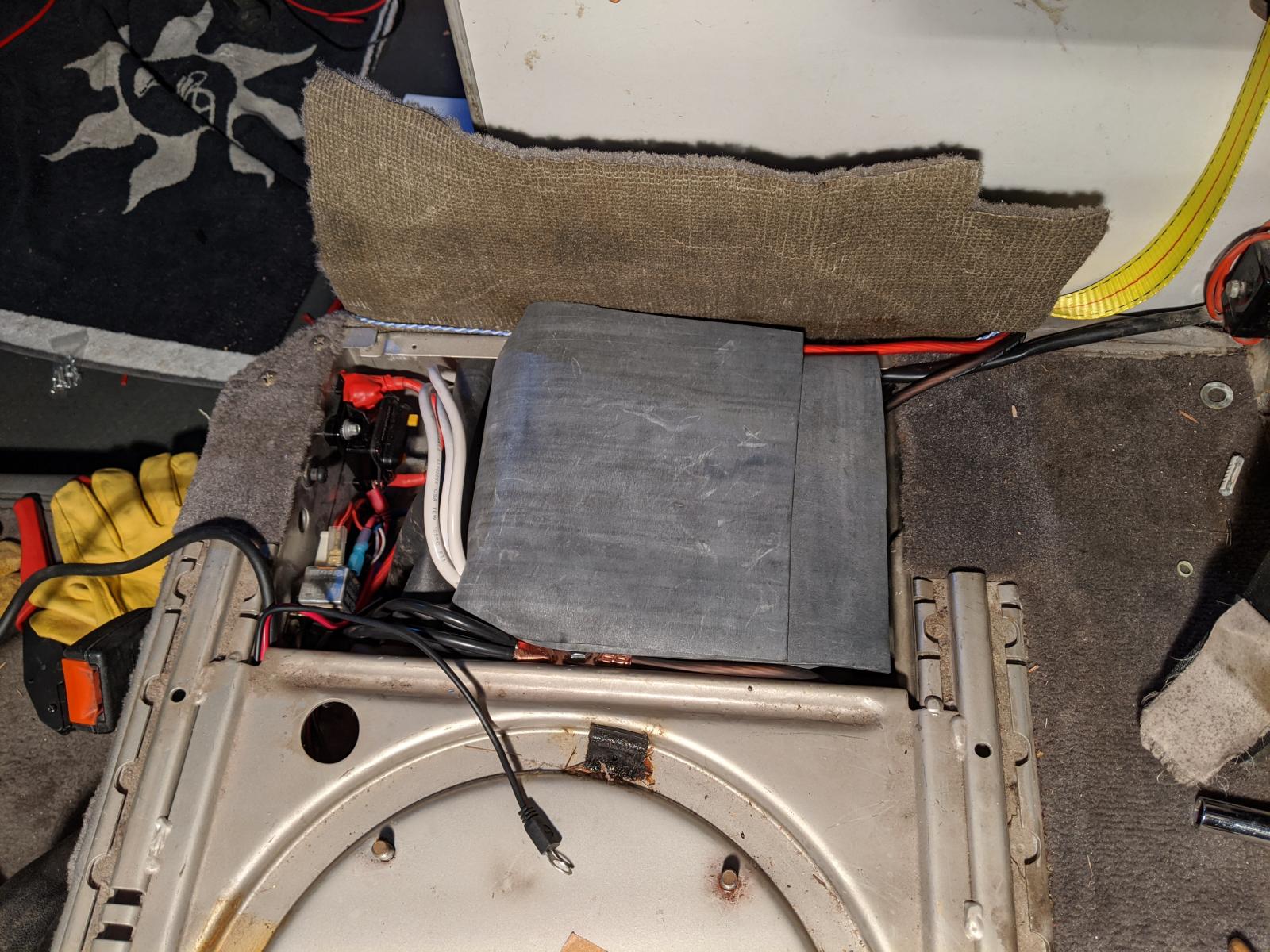

I then used thick electrical moisture sealing tape in two strips along the bottom to give the cells padded feet. Historically, I've used this tape to protect and quiet bicycle chainstays from chainslap.
Next, a layer of Gaffer's tape was wrapped around the cells. I'd never used this type of tape before, but it was recommended by Overkill Solar. It seems similar to duct tape but leaves no residue behind.
Next, the BMS was taped to the side of the cells using VHB, and the external temperature sensor was taped to the side of a cell using a few layers of Kapton tape.
Last assembly step was to measure, cut, and crimp the balance leads. Be sure to triple check which lead goes to which terminal. Do not connect the balance plug into the BMS until all leads are connected to the correct terminals, or else the BMS may be destroyed.
And finally, the battery installed in the van! I really like how well the cells and BMS fit inside the Riviera enclosure. The only bummer is that the lid of the enclosure no longer fits under the hinge. I have some plexiglass that I may use to fabricate a different size lid in the future. Until then, I will insulate the underside of the hinged battery box cover.

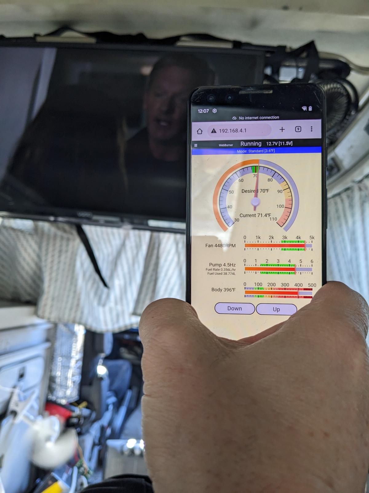

My total wattage on the heating system at "idle" is 40 watts, including the battery heater. Total at heater full blast is 60 watts. I didn't turn on my bus router, plug in my cell phone to deliver USB tethering or turn on the TV, so that will have to wait for tomorrow, if anyone wants to hear how much power all that uses if I were throwing all my draws at it Wink I did try out my Starlink with the system when I first got it. That would have provided about 10 hours of entertainment time on one charge of the battery. My use of a USB tethered router makes more sense to me than lugging Dishy around.
At ~60 watts, my BMS reports about 28 hours left, after keeping the bus warm since 7 AM until noon, not that it was at full heat production the whole time, but if it were somehow to get a LOT colder and need to keep going full blast for the rest of the time until I got back into the garage that is what I was seeing. The BMS says 15aH used from 7AM through 12:50 PM. I am so tickled Smile
The 2KW CDH with AfterBurner easily keeps the bus at 68F in this weather.

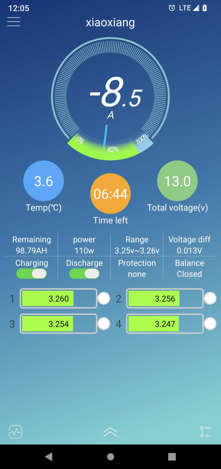

Here is what the Overkill Solar BMS phone app looks like while powering a spare headlight bulb. It provides an impressive amount of information and adjustability to the settings.
I have not done a capacity test to see how close to 132ah the cells are. I have a Victron shunt coming which I hope will give me more insight into total capacity while in use.

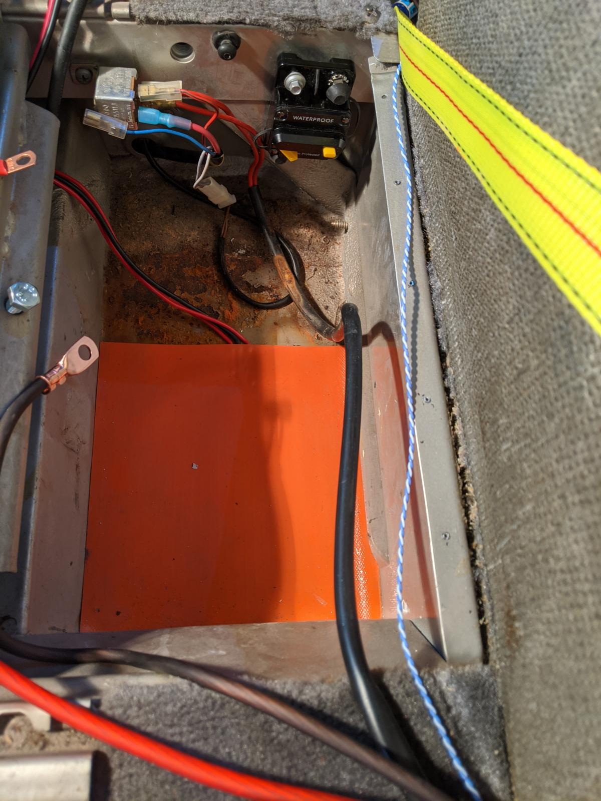

Heater pad under battery location (driver side)

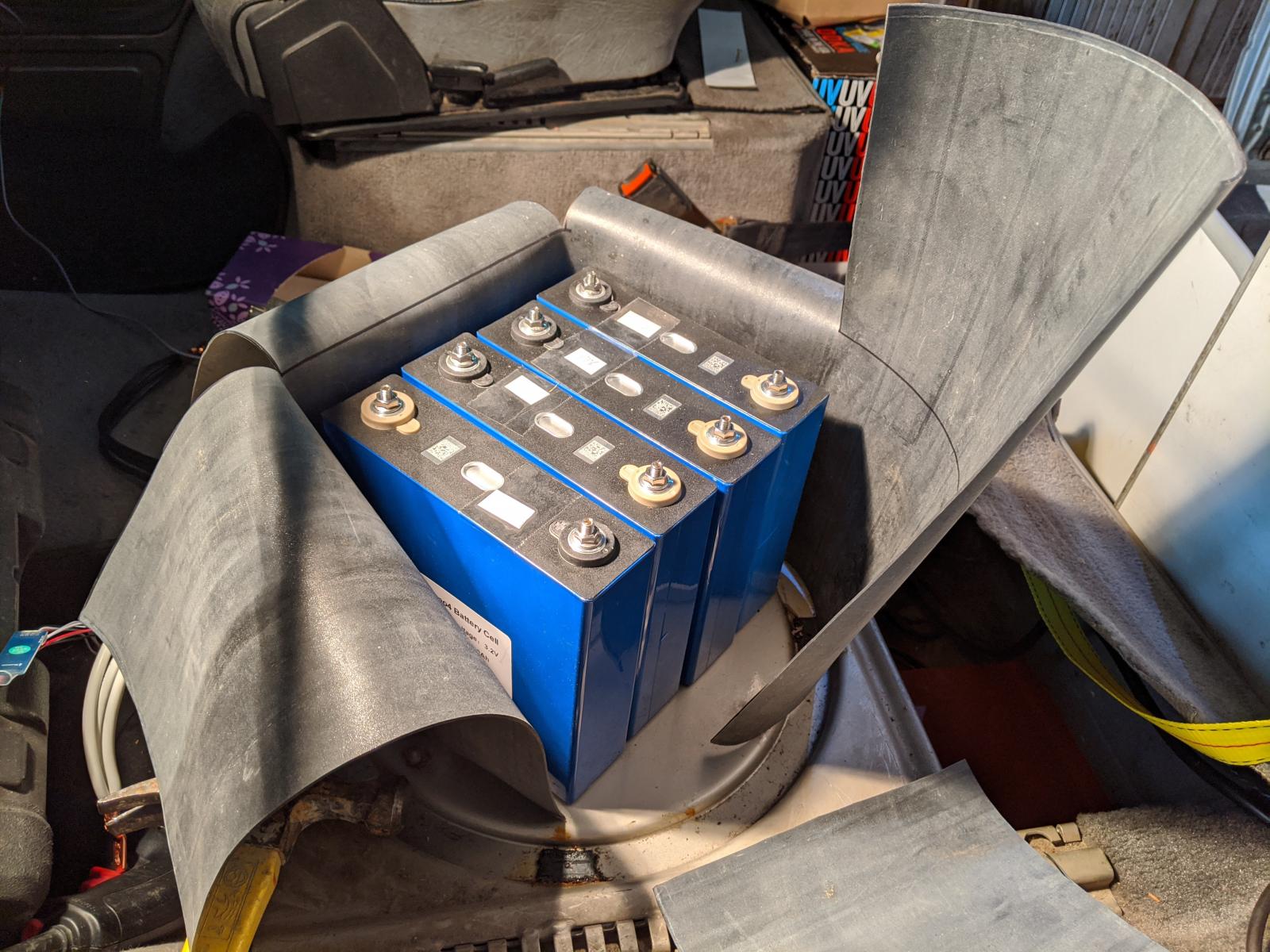

Got frustrated sticking my head in the cupboard and decided to make a easily removable sub panel to mount the inverter and fuse panel.
Used some roofing rubber to make a flappy box to both secure and isolate the cells.

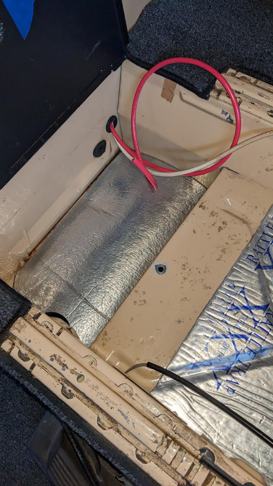

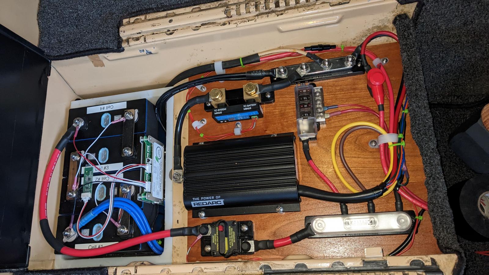

To keep the battery warmer and more cushioned, I put down a layer of reflective floor underlayment. This, plus the plastic battery enclosure, will act as a thermal break from the cold sheet metal in the wheel well.

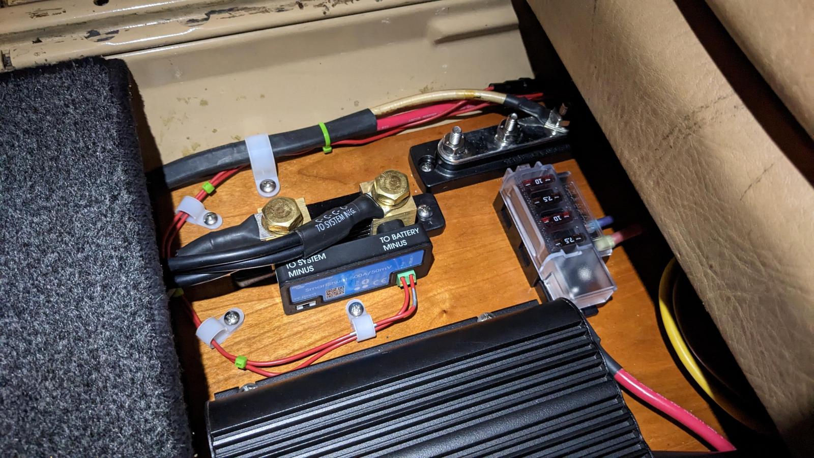

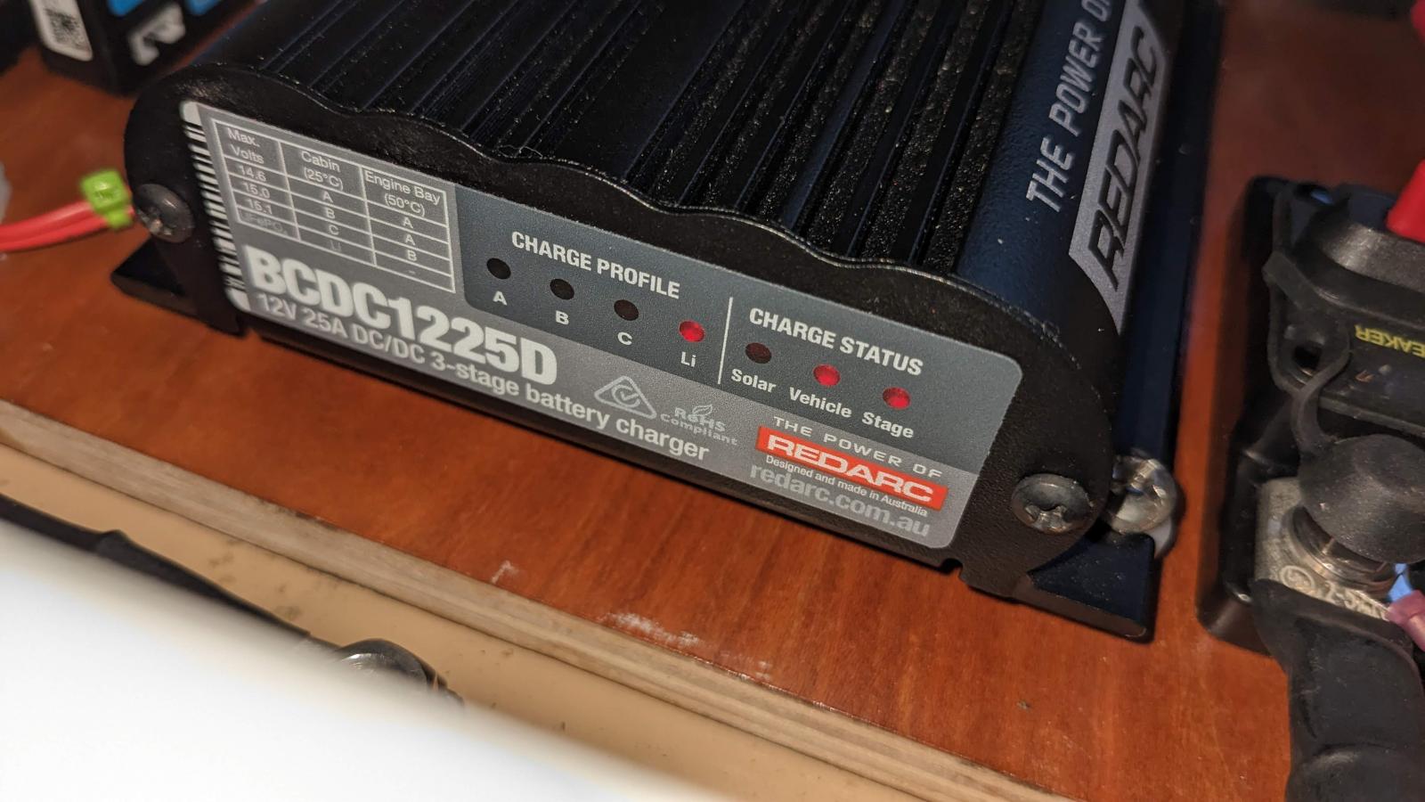

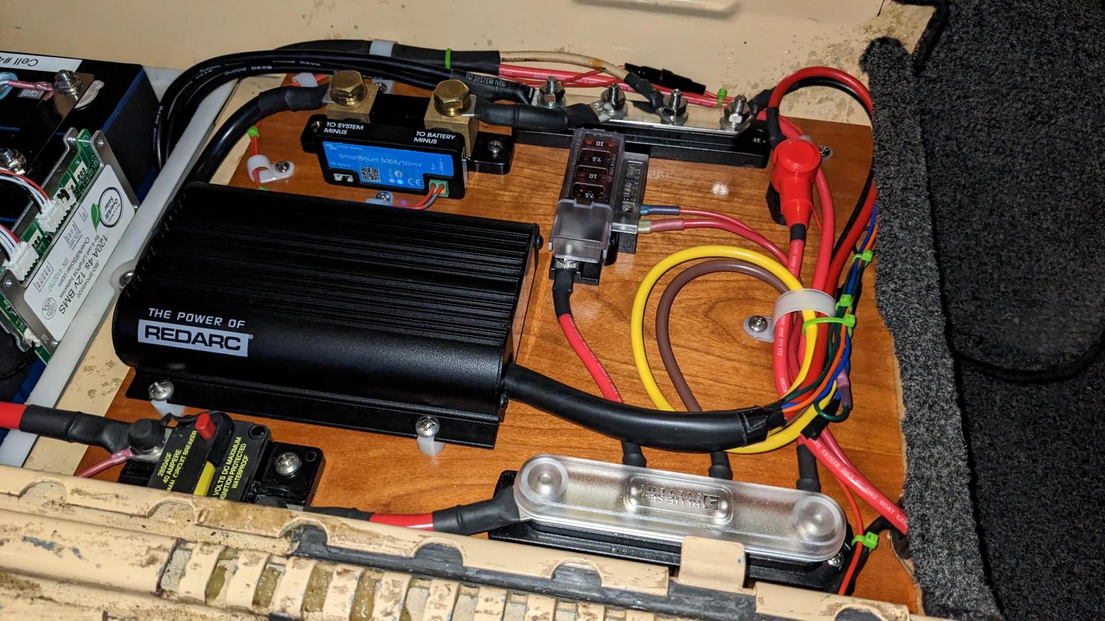

I finished this battery phase of my electrical project over the weekend. Well, "finished" for now anyways. I may go back and add a battery heater, and I will likely be adding a portable solar panel connected to the Redarc charger in the future. One step at a time since I'm doing all this for the first time...
Completed layout under the driver's seat:
I've read that the Redarc charger can get hot, so I spaced it off the panel to provide extra airflow.
System overview, all cleaned up before reinstalling the seats. By trimming the upper shell of the Riviera battery enclosure, I was able to get it to fit! The LiFePo battery now lives in an insulated enclosure, and the hinged lid can still close.

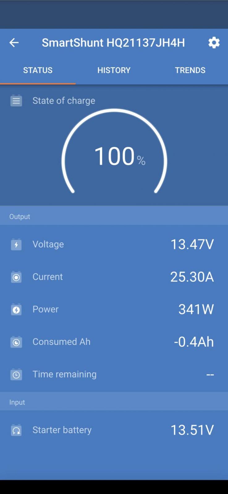

Here is the Redarc powered on for the first time, engine running.
Getting the full rated 25 amps! After running for a few minutes, the current dropped to 0 amps, as it should for LiFePo4 being brought to full charge.

PostPosted: Mon Feb 06, 2023 2:46 pm    Post subject: Re: 132AH LiFePO4 easily fits inside the battery box Reply with quote
Your shunt isn’t hooked up correctly. Easy fix though, remove the most rearward connection to the negative buss bar and attach it to the shunts forward post. Remove the short jumper from that same post. Then add a jumper from the shunts rear post to the negative buss bar. In essence you want any and all electricity to have to flow through the shunt.
BK
1991 tin top GL
Some BMWs.
1988M5
Joined: January 23, 2016
Posts: 848
Location: Tucson, AZ
1988M5 is offline
PostPosted: Mon Feb 06, 2023 3:57 pm    Post subject: Re: 132AH LiFePO4 easily fits inside the battery box Reply with quote
To quote page 9 of the manual (https://www.victronenergy.com/upload/documents/SmartShunt/9172-Manual_BMV_and_SmartShunt-pdf-en.pdf)
“ Note that there should be no other connections on this side of the shunt or on the negative battery terminal. Any loads or chargers connected here will be excluded from the battery state of charge calculation.”
FYI
BK
1991 tin top GL
Some BMWs.
BrownLoaf
Joined: January 21, 2021
Posts: 112
Location: Bellingham, WA
BrownLoaf is offline
PostPosted: Mon Feb 06, 2023 8:46 pm    Post subject: Re: 132AH LiFePO4 easily fits inside the battery box Reply with quote
BK
BK, thank you for catching this and for providing the explanation! I now understand that the loads on the negative bus were bypassing the shunt.
Once I make a trip to the local marine store for some more cable lugs, I'll make the new cable and install it between negative bus and 'system minus' side of the shunt.
83.5 Vanagon Riviera WBX 2.2 "Brown Loaf"
87 Vanagon Syncro Tin Top WBX 2.1 "Bubbles"
BrownLoaf
Posts: 112
PostPosted: Tue Feb 07, 2023 9:32 pm    Post subject: Re: 132AH LiFePO4 easily fits inside the battery box Reply with quote
This evening I made the new negative cable and installed it.
I'm excited to finally have a proper house battery system in the camper, and one that can be expanded upon!
Cheers,
Logan

PostPosted: Wed Feb 08, 2023 9:50 am    Post subject: Re: 132AH LiFePO4 easily fits inside the battery box Reply with quote
If the big thick wire on the left is the battery negative, why is there another wire connected to the same post of the shunt? The battery negative should be the ONLY connection to the shunt input post, so that all current flows through the shunt.

PostPosted: Wed Feb 08, 2023 7:45 pm    Post subject: Re: 132AH LiFePO4 easily fits inside the battery box Reply with quote
The thick wire on the left side of the shunt goes to chassis ground. The battery negative is connected to the right side of the shunt.
