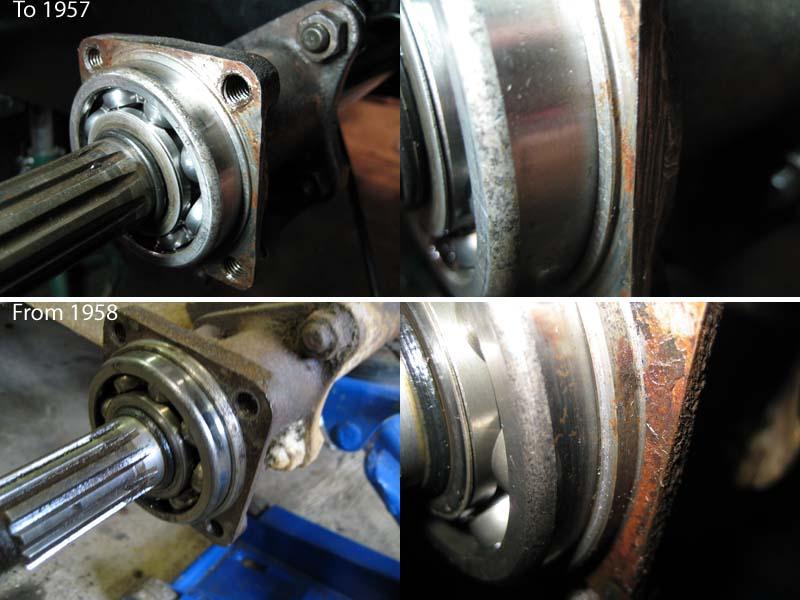

After doing some searching and reading online it seems that the 56 oval had a few different sized rear axle bearing covers. I read the thread posted here that shows how to tell which covers you have by measuring the ones that came off your car. Problem I have is my 56 oval project came to me mostly in boxes with lots of parts missing, including the bearing covers. Is there a way to tell based on build date which ones I need? Best I can tell my chassis was built Dec '55.

I found these pics off a thread long ago, I had all kinds of problems with the fitment of my axle tubes and covers. After buying the wrong ones from a local vw guru... And lots of wasted gaskets this was my savior... You have to see what kinda axle tubes you have and then match them to the right caps or they will leak. The easy way to look is the "male" ridge on the cap or if the male is on the axle tube. The pics explain it pretty well ill check back to see if this is enough later one today hope it helps.

The above post is correct and excellent but perhaps you might have missed the fact that you need to look at your axle tubes first to find out what you have before you go shopping for bearing covers. A 56 car could have any one of those three axle tubes in it due to previous owner changes.

yeah if you look at the lower picture it shows the axle tubes and the two main kinds you will most likely see. I have a extra set of the 58-64 caps if needed. Notice the caps and how the 57- ones have the male ring on the cap and a small one on the axle tube as well. The 58-64 ones have a female cap and a longer male axle tube ridge.
