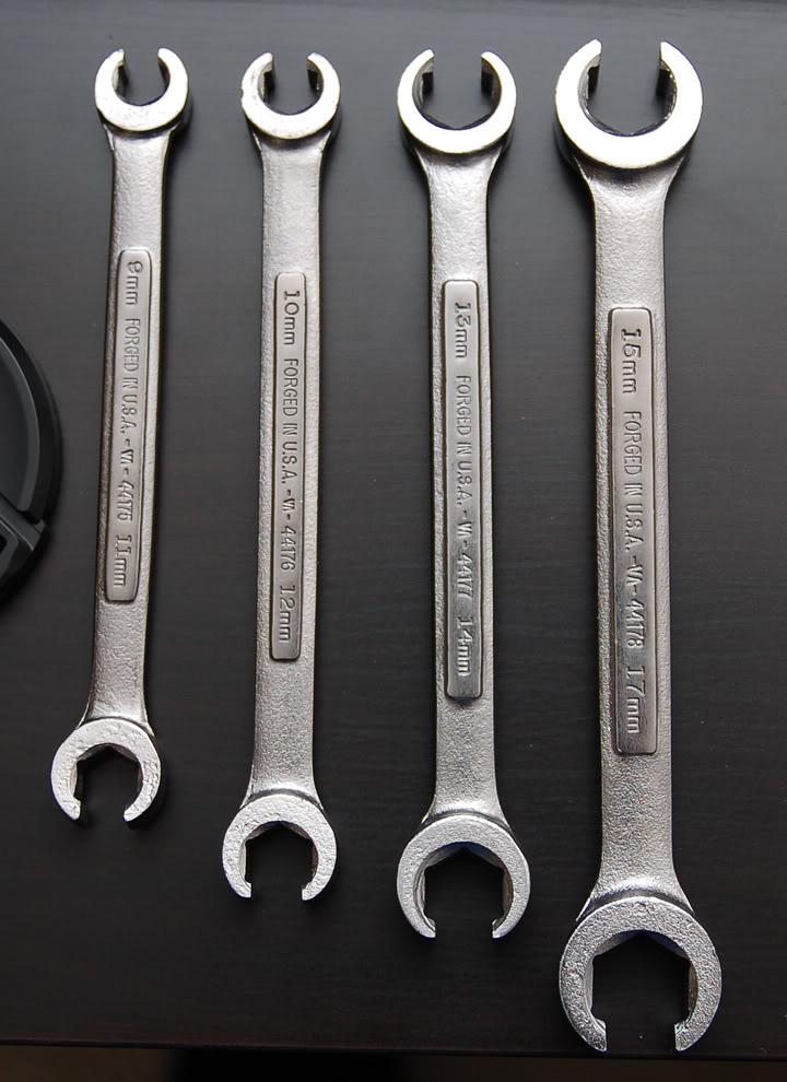

I'm going to buy a set of those wrenches. What size is the nut on the brake fittings? Seems like my 7/16 fits better than the 10mm.

It is usually a good idea to hit the flare fitting nut with a small wire brush so the correct sized tool will fit properly.
On a rusted up swelled brake line fitting a 3/8's will fit pretty close but is usually a little loose and will round the hex before the 10mm would.
A guy should be able to take a look at any fastener's condition, know full well that a wrench--even the correct one will not all by itself get a rusted up flare fitting loose.
This is where the heat comes in--heat, install the flare nut wrench , and off the fitting comes.
What were you using to get these fittings off--a crescent wrench?
T.K.

PostPosted: Mon Nov 30, 2015 10:07 am    Post subject: Re: Applying heat to brake fittings? Reply with quote
chris garrett wrote:
Terry,
Mostly 11mm.

Brain fade, I meant 3/8ths.

Well I just bought a 10mm/12mm flare nut wrench and guess what? It doesn't fit. So they are actually 11mm? The one wrench I have never owned-an 11mm.

Yes, they are 11mm.
Brake line flare nut wrenches are great until you get one totally stuck, then they bugger up a hex as well as any normal wrench.
That's when you get out the vise grips and get the sucker off.

And the hose ends are 14 mm.
