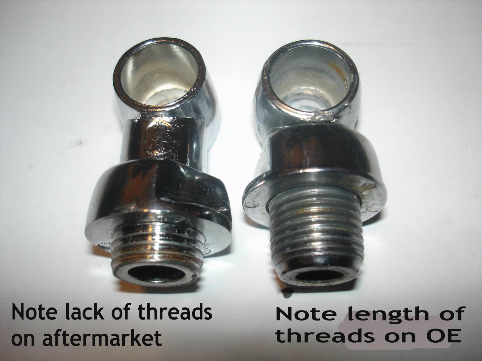

My 70 bus came with two very de-silvered outside mirrors.
Have tried a couple different flavours of replacements from CIP, also a couple originals from a local bus.
The CIP versions, not unexpectedly, don't bolt on tight to the body, loosened within a day at the swivel joint next to the body, and loosened within a couple of weeks at the back of the mirror. All of which means they don't stay adjusted for more than about 10 minutes of Edmonton potholes. Smile
Tracked down a couple of original mirrors from someone locally who was parting out a bus. They stay tight at the body and swivel joint but the back of the mirror is again loose enough to vibrate out of adjustment after a typical trip to the store.
Anyone find a better version of repro... or know a way to bolster the originals so they stay tight at the back of the mirror?

Mirrors are one of those things where the originals just can be beat. the hard part is finding them in decent shape. One thing you can do with yours, if you the heart to do it, is bust out the glass and service the little spring and nut that is inside so that it tightens appropriately. Then you have to find new glass. My attempt have having a local glass shop shape glass to fit failed pretty miserably.
I had the same problem of the threaded mounting part being too short on mirrors I got from Bus Depot. Otherwise, they were nice -- good metal, nice binding around the glass:
http://www.busdepot.com/211857514f
and
http://www.busdepot.com/211857513f
Don't even bother with the black plastic ones, except in an emergency. They vibrate so much that you can hardly see anything:
http://www.busdepot.com/211857514h
To solve the problem of the threads being too short, you need to replace the mounting part. You could use the original ones, and if you get lucky the taper in the hole will match, but I've seen a lot of versions of that, too.
Here's a source for NOS VW mirror nut mounts:
http://www.thesamba.com/vw/classifieds/detail.php?id=1051720
I got two, and they fit well, but still do not look quite as good as the German originals. I wonder if these are really from Brazil, though the seller says Germany. At any rate, they do work. If they weren't so expensive I'd get more of these.
So, I think the best bet aside from original is the Bus Depot mirrors supplemented by the NOS mirror mounts. That ends up being about $55 per mirror.

PostPosted: Sun Apr 20, 2014 7:28 pm    Post subject: Outside Rear View Mirror Reply with quote
Tcash wrote:
Thank YOu
1975 Kombi wrote:
The factory OE mirrors have a longer thread length and the nut has a recess to allow the threads future extension. I bought Wolfsburg mirrors and the thread part is not enough and there is no recess in the nut. So the combination of the two Wolfsburg parts does not leave enough thread to screw into the door. Also the door has a tapered recess that does not allow the threads to catch until they are in 3 thread. I couldn't get my new mirrors tight either.
OE arm is on the right.
Tcash wrote:
The exterior mirror mounting nut is spot welded to the door. You need to drill the spot welds out and weld a new nut in or install a nut from the inside.
kreemoweet wrote:
The mirror captive nut is M16x1.5. You "might" be able to clean up the
threads with a tap. Otherwise, a very tricky cut and weld job to restore the
stock setup. You might then want to look into alternative mounting methods.
Adding Passenger side-view mirror
http://www.jbugs.com/product/133-000.html
https://www.airheadparts.com/vintage-vw-parts/side...11857517-c
http://www.mamotorworks.com/VW/product/exterior-rearview-mirror-to-door-mount_306088
Good luck

I bought my mirrors from WW with the short thread as mentioned earlier. I was able to successfully cut longer threads onto the pieces with the right sized metric die. They've been working great on my 2 buses for several years now.

Do you remember which version? IIRC They sell 3 different "quality" levels... the cheap ones broke instantly, didn't have any luck tightening the intermediate version, but maybe that was just a fluke.
Thanks again, all!
Vince
There does seem to be three different levels of mirror out there. My bus had the very cheap ones when we bought her and they never stayed put. We always had to adjust them after shutting a door or in a strong headwind. I just upgraded to the high-end repro mirror. The box they came in had the WW logo, tho I didn't get them from WW. The mirror to door seals came from WCM. I only have maybe 50 miles on them, but I can now shut the doors and hit a pothole (not that I do that often!) without my mirrors getting out of whack. So far I'm happy with them, but time will tell. I have also heard from one person that the middle level mirrors aren't much better than the cheap ones and they also had better luck getting the high-end mirrors.
I'll admit here that I was asked to write a review of a product for VW Heritage and while I ended up choosing the mirrors, I intend to be honest about my experience so far and in the future. For what it is worth, I agree with everyone about original mirrors - they are best.
My experience is written up on my blog and includes some photos for comparison for those interested:
https://zerotosixtyeventually.wordpress.com/2015/1...nd-review/
Erik
71 Camper
http://zerotosixtyeventually.wordpress.com/
