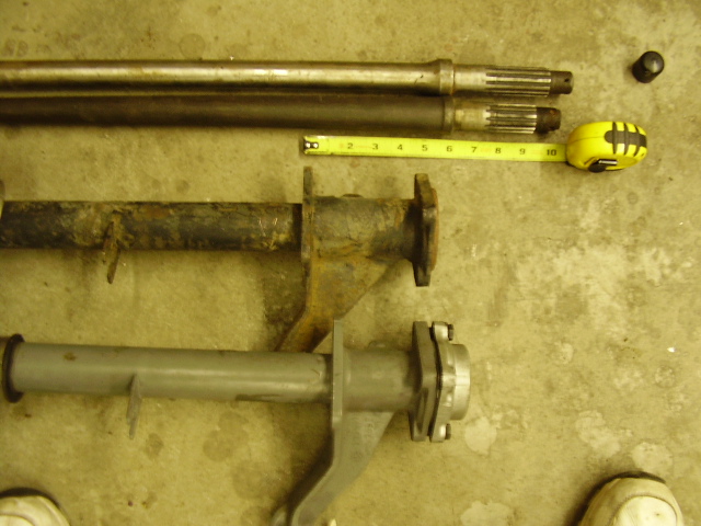

fluxcap wrote:
Sorry man, don't have any short axles to measure, but found this pic from another thread with a yard stick in it to give you an idea until somebody can get exact measurements.
66 and earlier short axles on left
67 long axle/short spline in the middle
68 long axle/long spline on the right
VOLKSWAGNUT wrote:
Yep... look at the end casting..
Its either wider than the average hand width..... or not..
Short Left... Long Right..
Long top Short Bottom
Now telling the difference between a 67 long tube or 68 long tube .. thats additional advice...

So hub = drum..
Since you seem to be so sure you need an extra spacer..
The most common practice is to use an extra outer spacer between the drum and nut.
Plus... there is the right one. No weld required.
Such as.. http://www.pacificcustoms.com/mm5/merchant.mvc?Scr...ange_high=
Additionally.... there are two different axle nuts that can be used to provide proper locking pin alignment..
Non Flanged
https://www.wolfsburgwest.com/cart/DetailsList.cfm?ID=111501221
Flanged
https://www.wolfsburgwest.com/cart/DetailsList.cfm?ID=311501221

PostPosted: Sat Jun 23, 2018 2:44 pm    Post subject: Re: Axle length Reply with quote
Hello everyone and I hope I am posting in the correct forum, if not someone please set me straight,
Ok I have a 67 ghia and need rear tire to fender clearance so decided after hearing it so much to do the short axle swap? Before I go to the expense of purchasing the short axles I was hoping someone would give me some advise!
After pulling the trans and removing one of the axles I discovered that according to specs I have a 1968 trans with the long axles long splines? So my question is what parts do I need other than the 26 inch axles to complete the swap? Will stock 4 lug brakes and inner bearing work?
Any help would be greatly appreciated and repaid!
Thanks mike

PostPosted: Sat Oct 06, 2018 1:15 pm    Post subject: Re: Axle length Reply with quote
I am installing a rebuilt pro street tansaxle. I have some SAW 2260 axles, it's a 62 bug. It has the short end castings. I am reassembling it and noticed the inner spacer was not there. Ordered new spacers and can't get bearing cap to sit flush. I measured everything see photo. A .250 spacer should work, but the shoulder on axle doesn't allow the spacer to go in far enough. Are the SAW axles meant to be used without spacer or a different bearing?

PostPosted: Sat Oct 06, 2018 1:20 pm    Post subject: Re: Axle length Reply with quote
Issue is only on driverside.

PostPosted: Sat Oct 06, 2018 3:47 pm    Post subject: Re: Axle length Reply with quote
What comes.to mind is to make sure that inner spacer isn't installed backwards on the driver side.

PostPosted: Sat Oct 06, 2018 4:41 pm    Post subject: Re: Axle length Reply with quote
Might have the wrong bearing cap on the driver side? There are several different depth caps depending on year and end casting. Compare it to the passenger side. Or it's possible you have different end castings side to side. Measure how far bearing sticks out of end casting on both axles .

PostPosted: Wed Feb 20, 2019 11:18 am    Post subject: Re: Axle length Reply with quote
Changed from short to long axles on my splitbeetle. Problem now is the damper doesn.t line up anymore. They fit perfectly on the shorttube but the angle is different on the long tubes. Is there a readily made kit for this or do i have to make my own spacers?
