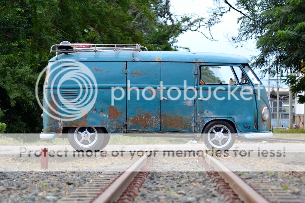

With the purpose to enjoy it and give it a ride without doing restoration work in structure, I refreshed the engine, brakes and gearbox to put it to roll ..
I share some pictures:

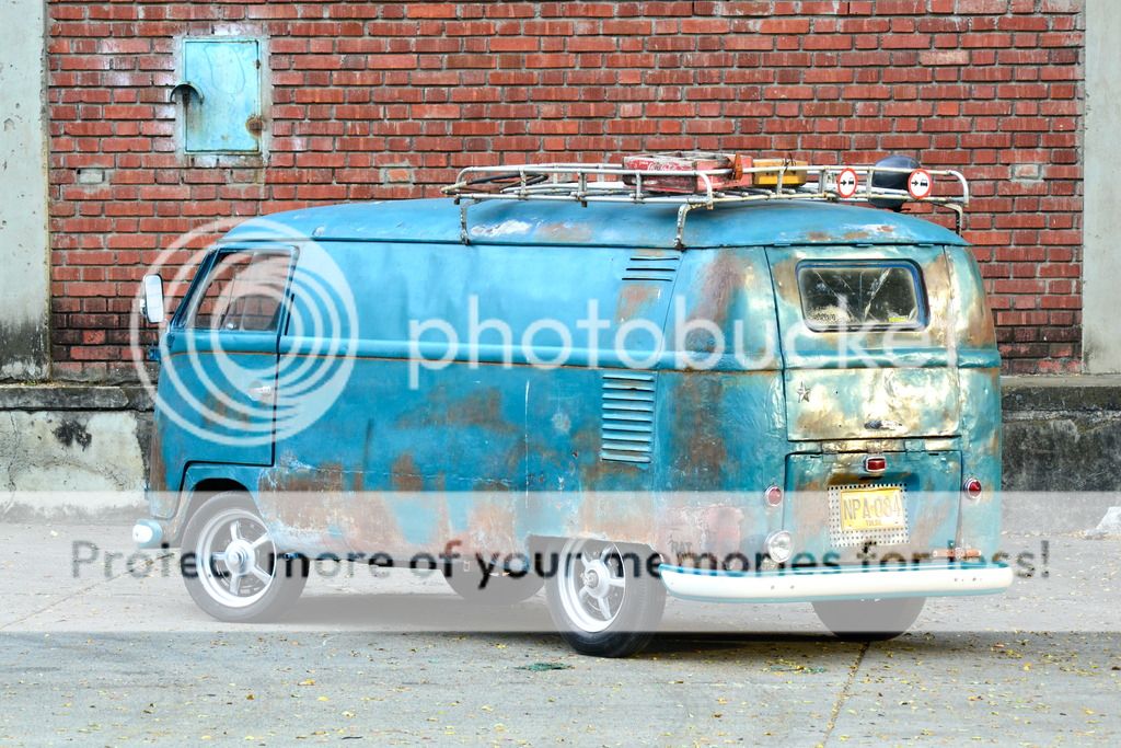

PostPosted: Wed Jun 10, 2015 7:03 am    Post subject: Reply with quote
After some work, here is the result! Definitely we do not need tons of money to enjoy it.

PostPosted: Wed Jun 10, 2015 10:48 am    Post subject: Reply with quote
Very nice! Should close up the holes in the engine lid though, not good for the cooling of the engine.

PostPosted: Wed Jun 10, 2015 11:30 am    Post subject: Reply with quote
Good thing , I thought it was better with the holes!..

PostPosted: Wed Jun 10, 2015 12:13 pm    Post subject: Reply with quote
Pepillo wrote:
There is a air draft of sorts behind the bus when you are driving. It tends to keep the exhaust in that area, those holes suck the exhaust back into the engine bay instead of the cooler air where the vents are located at.

PostPosted: Thu Jun 11, 2015 6:50 am    Post subject: Reply with quote
YOUBUGME2 wrote:
Pepillo wrote:
Thanks for information , clearly I'll close the holes.
