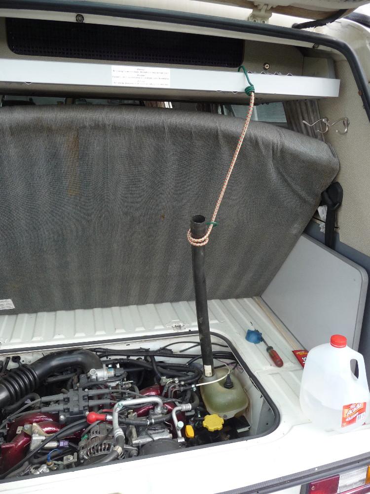

Just to throw another method in the mix -- many use what is commonly called the 'Libby Bong' which employs gravity in lieu of an electric pump but gets a similar result to my method. A search on Libby Bong will turn up details.

You can do a poor mans Libby bong if you have a spare front radiator hose. Just like the Libby bong, this gets the level of the added coolant above the radiator bleed and lets you open the bleeders with the engine not even running to get coolant throughout the system.

greenraVR6 wrote:
I've had great luck bleeding the system on my van by parking on an incline on the side of my driveway with the nose down, then jacking up the rear a little further. With the engine cool I open the 3 bleeders. The engine bay one flows almost immediately, under the rear seat flows almost immediately and the radiator bleeder takes a few more seconds to flow solid. I usually close the 2 rear ones then let the radiator flow for a bit, refilling the expansion tank as needed.
After doing this about 4 different times over a few day period my van's cooling system hasn't given me any issues for some time now. Before this my van would randomly overheat or the needle would go almost all the way up. Now it holds steady just above the red led when warmed up Very Happy
And you didn't burn your fingers with hot coolant or build a bong. That's why I use the "nose down, tail up" method too.
'86 Syncro Westy SVX
