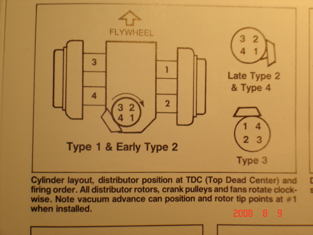

Pull your distributor cap off and look for the notch on the rim, that should be where #1 cylinder fires.
From there the firing order is 1-4-3-2 in a clockwise rotation, see the pic for cylinder locations.
Once you have verified all the spark plug leades are in the correct location on the cap, perform the tuneup procedure outlined here: http://www.vw-resource.com/tune_up.html

Mukluk, that diagram only applies to 009s and single port bugs.
Dual port distributors are 90 degrees anti clockwise.
The diagram is more so just to visually demonstrate how the plug leades are located in relation to each other and where the cylinders are located so he can trace the leades to verify they go where they should. Regardless of distributor installed, unless his engine has never been rebuilt there is always the possibility the distributor drive may have been clocked incorrectly when installed, hence one of the reasons I referenced to the tuneup procedure (which also details how to verify where TDC is truely located)... the other reason for referencing the tuneup procedure is that it is by far the best thing to perform in the case of any hard start or poor running complaint.
